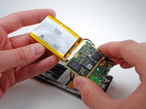

Logic board comes out!
Like the iPod touch, the Zune has a soldered battery. The battery should be easier to replace than on the new iPod touch, since the Zune's battery has individual wires for the battery leads. In the touch, the battery leads run through a single ribbon cable, making hand-soldering a challenge.
