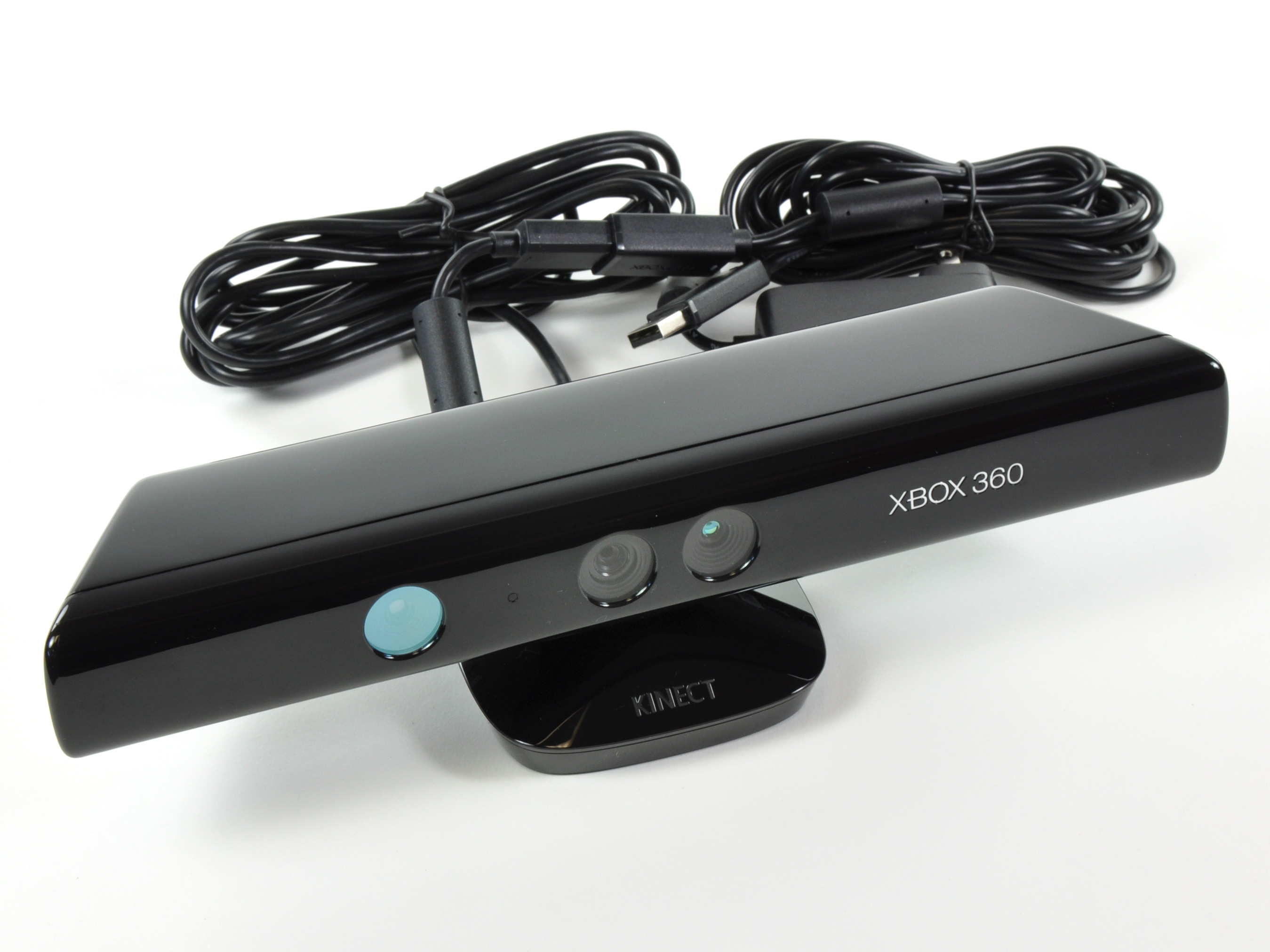

    • We finally have Microsoft's entrant into the realm of motion gaming, the Kinect. Microsoft's code name for Kinect was Project Natal.
    • This isn't just another Wiimote knockoff. Kinect is the result of hundreds of millions of dollars of research Microsoft has invested in speech and motion recognition.
    • The Kinect is not a handheld game controller like the Wiimote or the Playstation Move—rather, it is a sophisticated sensor suite that detects your position and movements in 3D space.
    • There are several great stories already out there explaining how Kinect detects motion. We aren't going to repeat all the basics here, so if you are interested in that sort of thing check out the above articles.
