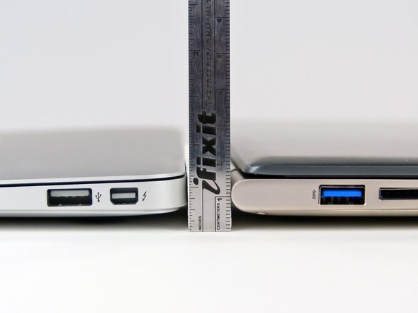

    • Despite being a formidable Ultrabook in its own right, the Zenbook is often criticized for its thickness.
    • All things considered, the "bulging waistline" of the Zenbook isn't all that considerable. When compared with a MacBook Air, it's only a few millimeters thicker at the spine.

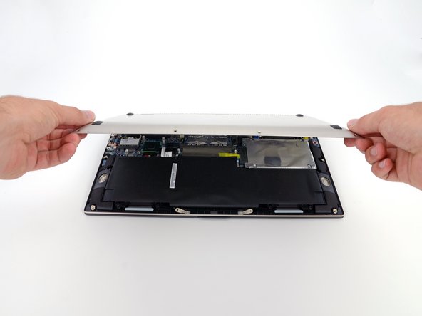

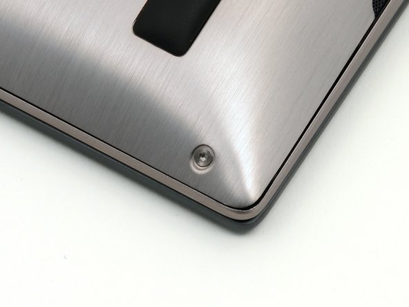

    • The stylish aluminum lower case is held in place with twelve T5 Torx screws. The cover itself is not the same quality you'd find in an Apple product, but we applaud Asus' use of non-proprietary screws.
    • We love Torx screws. They provide large amounts of surface to transfer torque, they resist cam-out much better than many screws, and they're common.

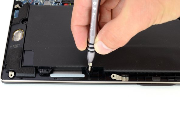

    • The first component to come out is the battery. Point for repairability!
    • The screws on the outer case were Torx, but the eight screws holding down the battery are good-old Phillips #0. Interesting choice, Asus.
    • Pulling out the battery delivers us special bonus components: the left and right speaker assemblies that are adhered to the sides of the battery.

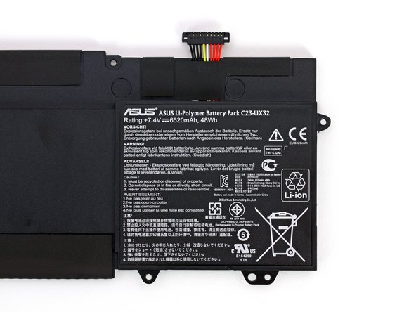

    • The 7.4 volt, 6520 mAh battery in the UX32VD weighs 280.5 grams, accounting for approximately 20% of the Zenbook's weight.
    • By comparison, the battery in the 13" MacBook Air is approximately 22% of the Air's total weight, at 300 grams.
    • This Zenbook sports a 48 watt-hour battery, a smaller battery than the previous year's model, but a solid contender with other similarly-sized laptops.
    • 2011 Zenbook UX31A: 50 watt-hours
    • Macbook Air: 50 watt-hours
    • Acer Aspire S5: 34 watt-hours

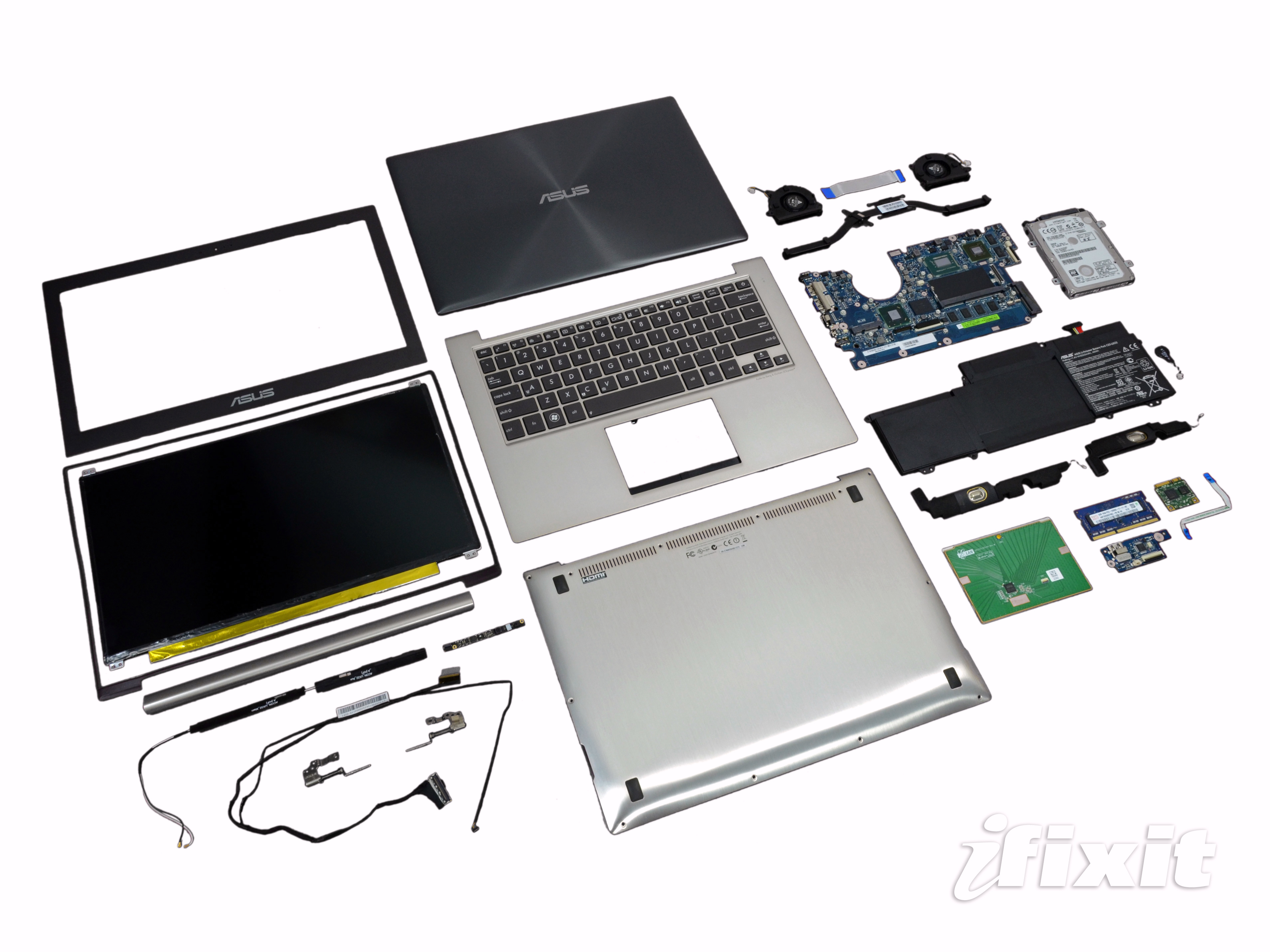

    • Asus UX32VD Zenbook Repairability Score: 8 out of 10 (10 is the easiest to repair).
    • All the components are easy to access, with no proprietary screws inhibiting access.
    • The battery is not glued in place, and a person equipped with the right tools can replace it in a matter of minutes.
    • You can upgrade both RAM and hard drive in this machine.
    • Labeled motherboard sockets make reconnecting cables easier.
    • A lot of components were held in place with more adhesive than is necessary.
