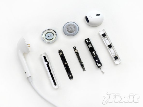

    • The underside of the remote cover reveals three buttons and a microphone. No surprise here, as the remote has three buttons.
    • With a little more coaxing cutting, we are able to remove the flexible PCB within the EarPods' remote.
    • The microphone in the EarPods' remote bears the markings 2F17 045.
    • Will this microphone be similar to one of the three microphones inside the iPhone 5? Probably. Will it be the same? All will be revealed in due time three more days.
    • We also uncover another IC with the markings TI25ASGVI 079, which Chipworks believes to be a Texas Instruments ADC, or a device used for volume-control duty.
    • All these components look large when shot in our pictures, but they're quite small in real life. That's how the board looks like when compared to a U.S. dime.

    • With such a tight fit between the two halves of the EarPods, simply pulling them apart wasn't an option. We knew what we needed to do.
    • We don't normally cut open earbuds, but when we do, we prefer X-Acto #11 blades.
    • This isn't something you'd want to try at home. Once these Pods are open, they're not closing back up unless you want to involve glue.

    • While an updated remote is nice, the real innovation in the EarPods is in the speakers.
    • Like most speakers, the speakers in the EarPods consist of a diaphragm/cone, a voice coil, a permanent magnet, and a cabinet.
    • Paper or Plastic? The voice coil is supported by a composite diaphragm made of a paper cone and a polymer surround. This is the first iteration of Apple headphones to use paper cones rather than all plastic.
    • The most exciting—and most widely publicized—feature of the EarPods is the unique teardrop-esque shape of the cabinet.
    • Yet once these guys are open, things start looking quite similar to other earbuds.
    • Apple spent a lot of time analyzing people's ears, so hopefully their external design will pay dividends in the auditory excellence department.
