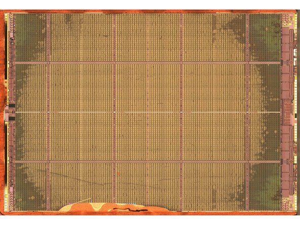

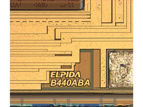

    • During the iPhone 5 teardown, we referenced the B8164B3PM silkscreen label, which denoted 1GB of Elpida LP DDR2 SDRAM.
    • The die mark (first image) and die photo (second image) confirm the strong hunch that the A6's 1GB LP DDR2 SDRAM is provided by Elpida.
    • According to Chipworks, the Elpida EDB8164B3 was also found in the Motorola Droid RAZR Maxx.

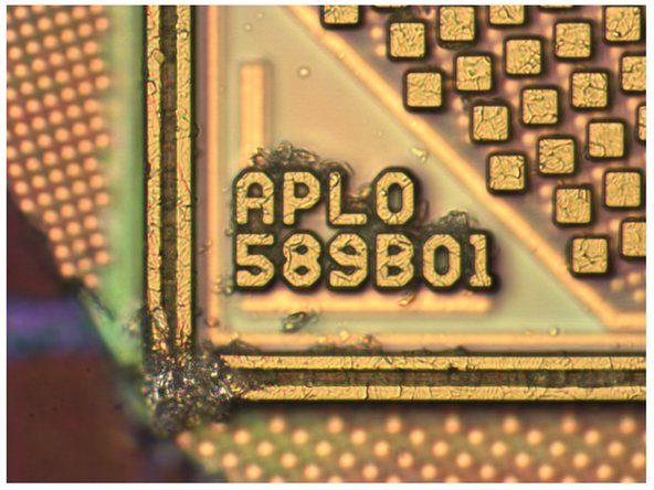

    • Samsung isn't completely absent in the A6, though. The Apple A6—labeled APL0598 on the package marks and APL0589B01 on the inside—is fabricated by Samsung on their 32 nm CMOS process and measures 9.70 mm x 9.97 mm.
    • Even though the A6 was manufactured by Samsung, that doesn't mean it was designed by Samsung. The Apple A6 processor is Apple's first custom-designed processor. It's based on the ARMv7s instruction set.

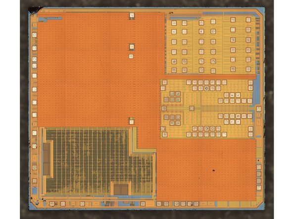

    • Journey to the center of the A6. The most prominent features inside are the Dual ARM cores, and the three PowerVR graphics cores.
    • When compared to the rigid, efficient layout of the GPU cores directly below it, the layout of the ARM cores looks a little homespun—at first.
    • Generally, logic blocks are automagically laid out with the use of advanced computer software. However, it looks like the ARM core blocks were laid out manually—as in, by hand.
    • A manual layout will usually result in faster processing speeds, but it is much more expensive and time consuming.
    • The manual layout of the ARM processors lends much credence to the rumor that Apple designed a custom processor of the same caliber as the all-new Cortex-A15, and it just might be the only manual layout in a chip to hit the market in several years.

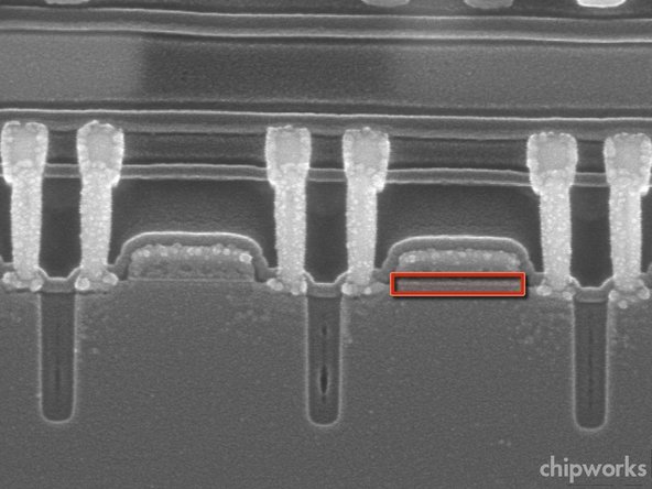

    • The raised mesa-looking shapes in the magnified cross-section view (second image) are the transistors' structures, and the little pegs running between them are the actually the contacts between layers.
    • We can't help but think that the transistor layout looks a lot like a Roman aqueduct.
    • This very thin line confirms that this is a 32 nm HKMG (Hi-K metal gate) process.
    • The A6's 32 HKMG process is the same as the one utilized in the Apple TV 3rd Generation (APL2498 on Chipworks).
    • In an FET (Field Effect Transistor), K is the dielectric constant of the layer between the gate electrode and the silicon. This is a physical parameter of the material which helps control the turn-on voltage of the transistor.

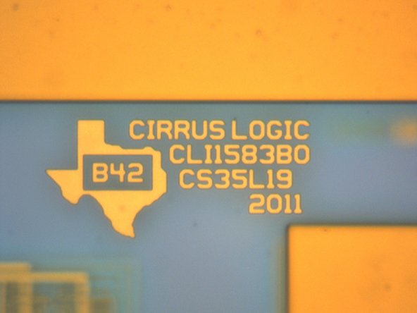

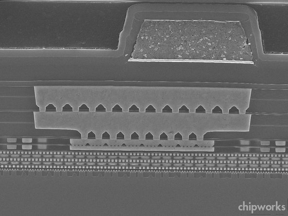

    • Chipworks cracked open the Apple 338S1077 to confirm that it is, in fact, a Cirrus CS35L19 class-D audio amplifier.
    • The second image is of the Cirrus' CS35L19 die. Judging from the inscription, this package seems to be from the CS35L family, although it's not specifically listed on Cirrus' site.

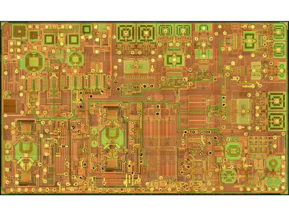

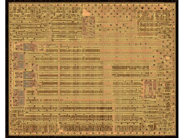

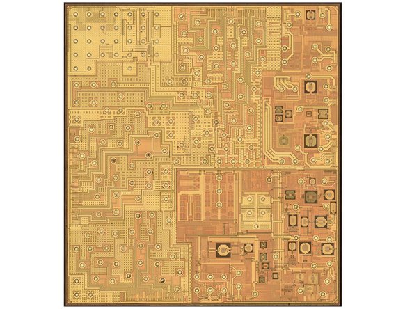

    • So what's pictured on this step, you say?
    • The first image depicts the HG11-N3877 LTE Baseband die.
    • The second image is of the Samsung 1G-F-MC 128 MB memory die, also found in the MDM9615.
    • The third image shows the RTR8600 die.
