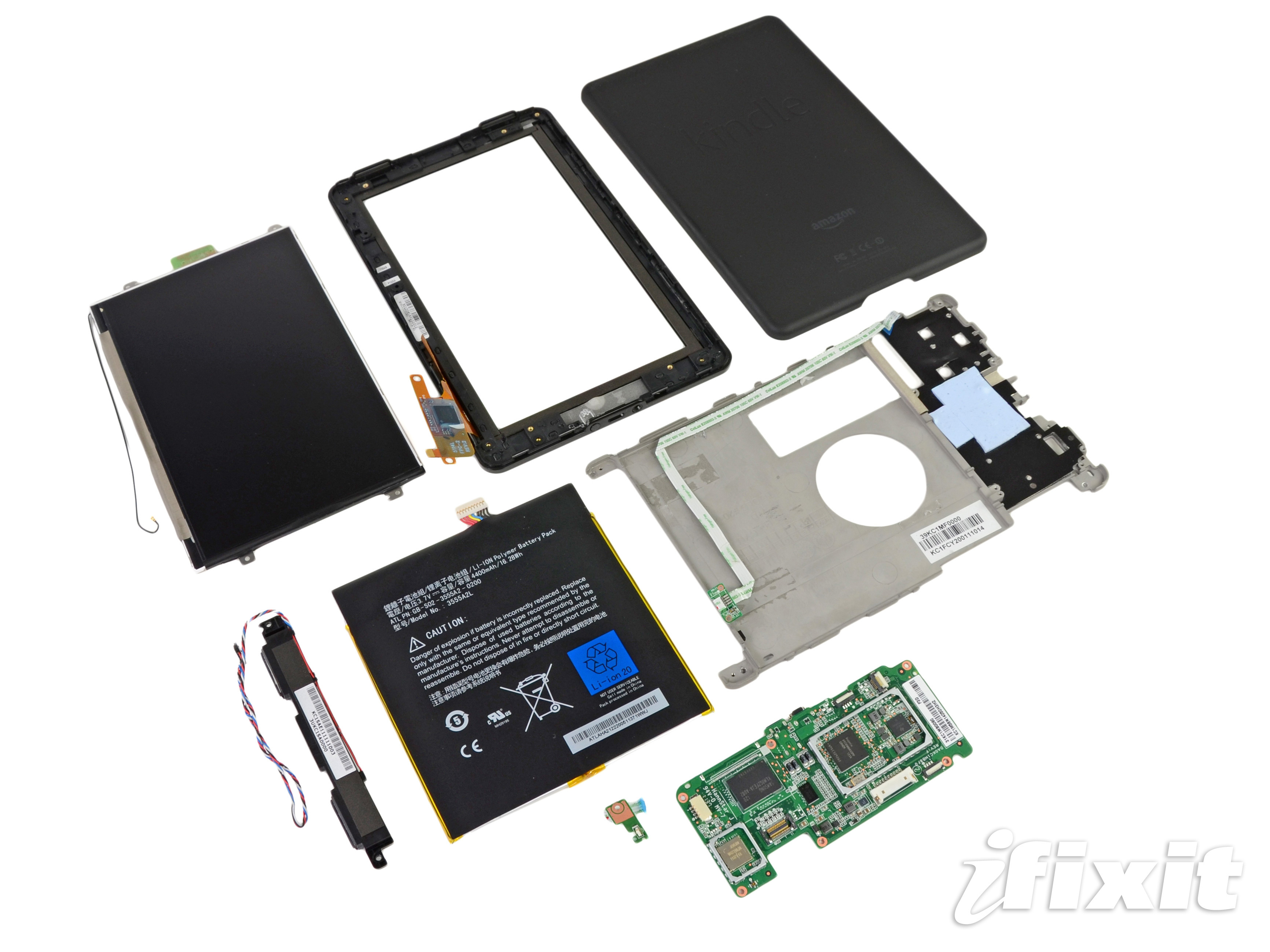

    • We have only one burning desire; let us tear into this Fire.
    • 7" Multi-Touch Display with IPS Technology
    • Dual-Core Processor
    • 512 MB RAM
    • 8 GB Internal Storage
    • 802.11b/g/n Wi-Fi Connectivity
    • Custom Operating System (Based on Android 2.3 Gingerbread)

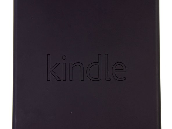

    • In case you couldn't identify the Kindle Fire by its sleek looks, the back panel has been stylishly embossed with "kindle." The smooth, rubberized texture of the panel complements the small size quite well to provide a nice feel when holding the Fire in one hand.
    • The Kindle Fire is officially identified as model number D01400.
    • According to the power specifications listed on the back side of the Kindle Fire, an input power of 5 V DC at 1.8 Amps is suggested. Why is this important? A computer USB port typically puts out no more than .9 Amps (USB 3.0), which means it'll take a looong time to fully charge the tablet through USB.

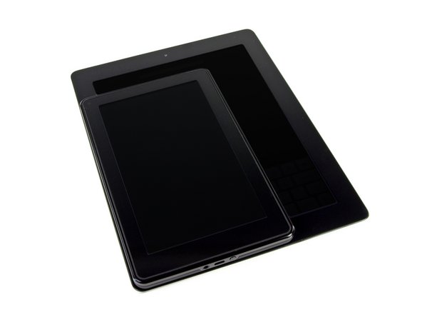

    • The Kindle Fire has a similar port configuration as the iPad 2, utilizing only a single port for data transfer and charging.
    • The Fire's dimensions are 7.5" x 4.7" x 0.45". Compared to the iPad 2 whose dimensions are 9.5" x 7.3" x 0.34", the Fire looks a little like a chew-toy for the much larger iPad 2.

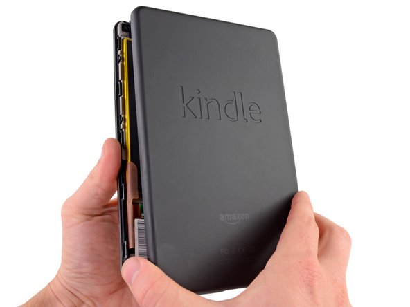

    • Our old friend, plastic opening tool, comes to our aid as well as our musical friend, the guitar pick.
    • A little prying and plucking and the case's halves yield to our efforts.
    • Thankfully the Kindle's case separates with a lot less effort than a certain product line we know.
    • Removing the back case reveals the motherboard and a behemoth of a battery. Note the shiny metal plates on the back case that help provide protection for the internal components, as well as heat sinking and EMI shielding. Unfortunately, this mirror-like shielding inevitably results in a narcissistic battery.

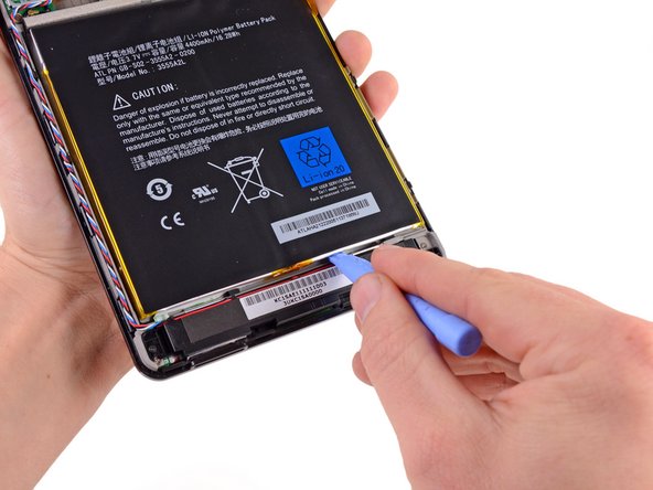

    • Only one connector and some glue keep this monstrous battery in its place—no match for our trusty spudger and plastic opening tool.

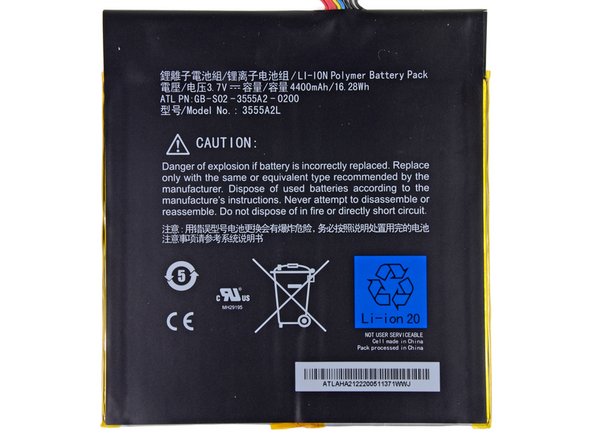

    • With the battery freed, we take a closer look at the Fire's 4.6" tall x 4.3" wide Li-Ion battery.
    • This battery sure puts out... 16.28 Watt-hours, to be exact. However, due to the size of the Fire, its battery's 3.7 V potential and 4400 mAh capacity don't quite stack up to the specs of the iPad 2 Wi-Fi's battery.

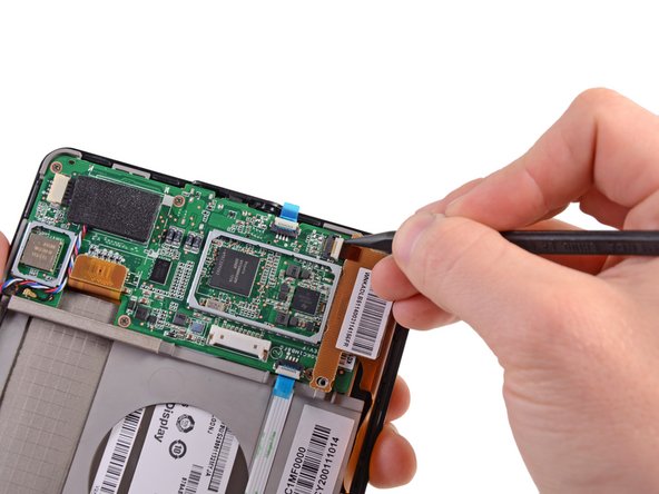

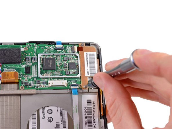

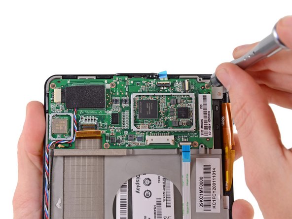

    • The touchscreen controller is easily detached from the motherboard after removing a few screws.
    • To gain access to the motherboard, we must first disconnect a couple of connectors from their respective sockets.
  7. Kindle Fire Teardown: step 7, image 1 of 2 Kindle Fire Teardown: step 7, image 2 of 2
    • A few more twists with the Phillips #0 from our 64 Bit Driver Kit releases the motherboard from the Kindle's grasp.

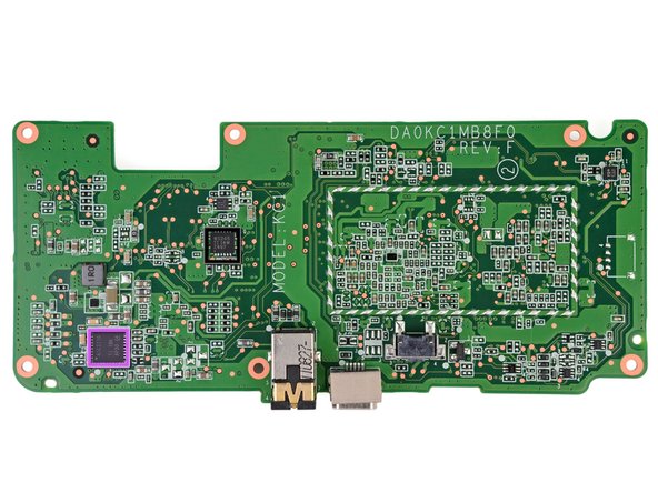

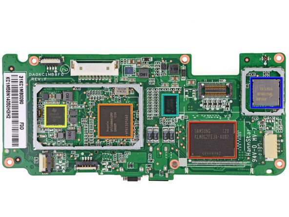

    • We put on our classy monocle magnifying glass to help us identify the ICs:
    • Samsung KLM8G2FEJA 8 GB Flash Memory
    • Hynix H9TKNNN4K 512 MB of Mobile DDR2 RAM
    • Texas Instruments 603B107 Fully Integrated Power Management IC with Switch Mode Charger
    • Texas Instruments LVDS83B FlatLink 10-135 MHz Transmitter
    • Jorjin WG7310 WLAN/BT/FM Combo Module
    • Texas Instruments AIC3110 Low-Power Audio Codec With 1.3W Stereo Class-D Speaker Amplifier
    • Texas Instruments WS245 4-Bit Dual-Supply Bus Transceiver

    • It's desoldering time. After busting out the heat gun, we quickly get to work searching for what secrets lie beneath the Hynix RAM chip.
    • Eureka! Lifting off the RAM chip, we find the 1 GHz processor— a Texas Instruments OMAP 4430.
