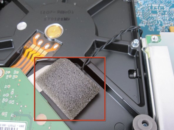

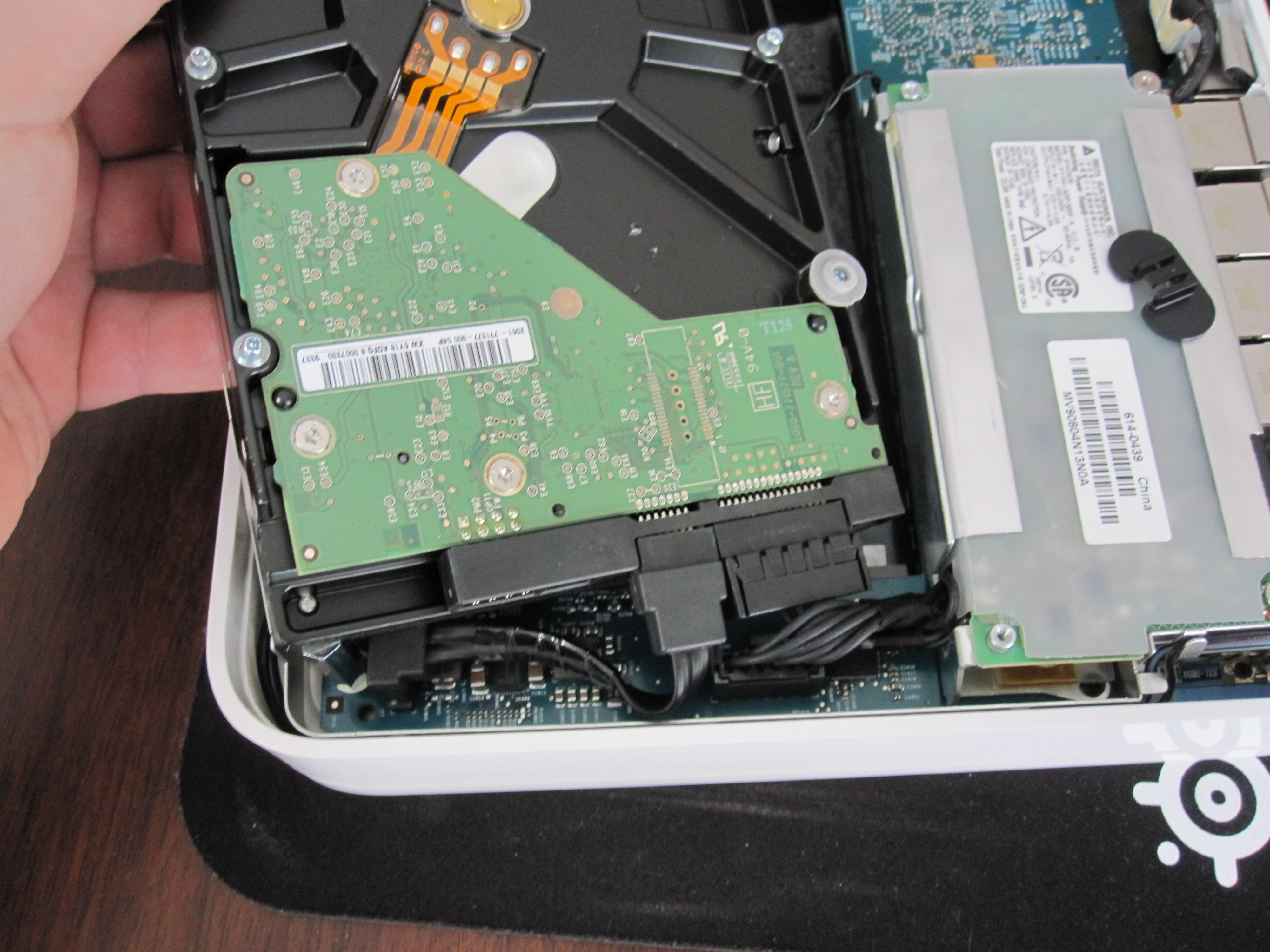

  4. Apple Time Capsule Model A1302 Hard Drive Replacement, Remove the hard drive: step 4, image 1 of 3 Apple Time Capsule Model A1302 Hard Drive Replacement, Remove the hard drive: step 4, image 2 of 3 Apple Time Capsule Model A1302 Hard Drive Replacement, Remove the hard drive: step 4, image 3 of 3
    • HDD is an abbreviation for "hard disk drive."

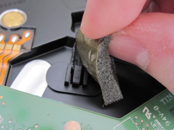

    • Before removing the HDD, remove the temperature sensor that is mounted directly on the hard drive. The sensor is attached to the hard drive using adhesive tape and a protective foam cushion.
    • Peel off the foam and set the sensor aside. Be gentle with the foam because you will reuse it to connect the sensor to the new HDD.
    • Lift the HDD out of the device and disconnect the two SATA cables from the HDD.
