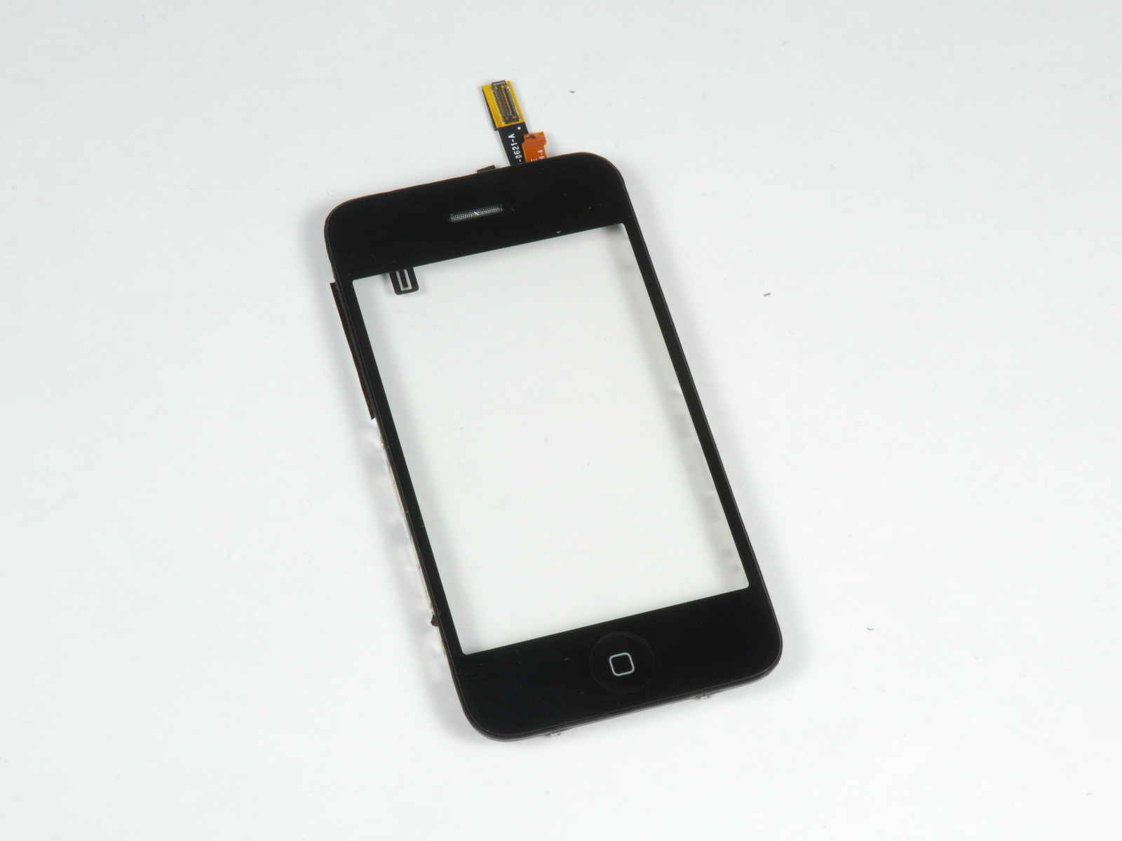

  13. iPhone 3GS Front Panel Assembly Replacement: step 13, image 1 of 1
    • Separate the LCD and glass by sliding the LCD panel away from the ribbon cables on the glass.
  14. iPhone 3GS Front Panel Assembly Replacement, Front Panel Assembly: step 14, image 1 of 1
    • Front Panel Assembly remains.
