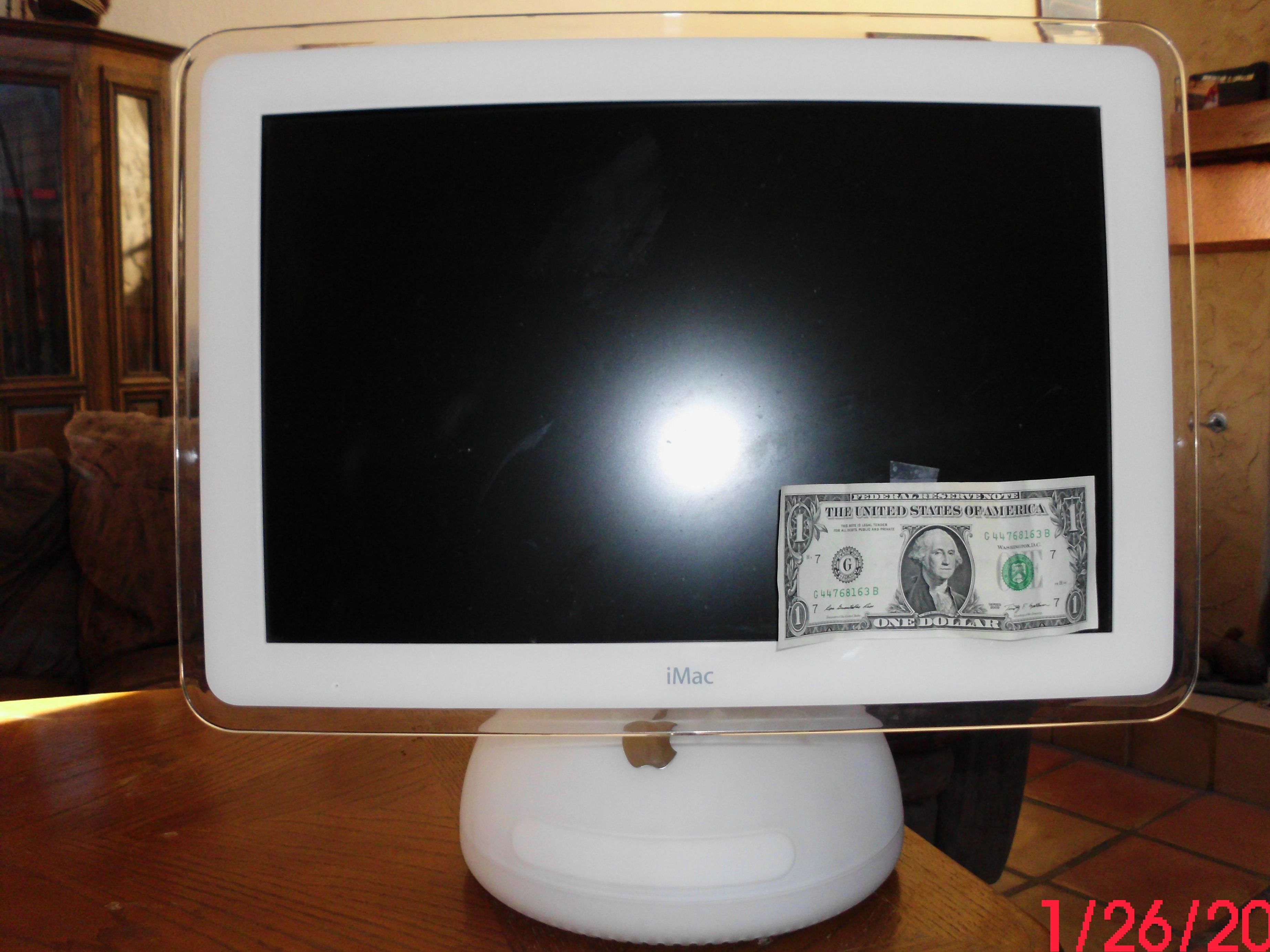

  • G4 bottom Plate with four captive Phillips screws
  • The bottom of the plate will list the serial number, MHz of the machine, standard RAM and hard drive size
first image
Add Note Edit Step 2  ¶
  • Here the plate has been removed exposing the slot for the Airport Card and User added RAM slot.
first image
thumb image 1
thumb image 2
Add Note Edit Step 3  ¶
  • Remove the four T15 torx screws.
  • Set the unit on it's base, grasp the neck and tilt it to separate the base.
