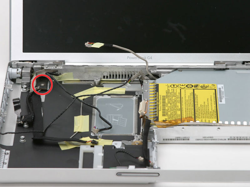

Tripped over your power cord? At least you don't have to replace the entire logic board.
Image #1
  • Use a coin to turn the battery locking screw 90 degrees to the right.
Image #1
Add Note Edit Step 2 — EMI Finger  ¶
  • Remove the four Phillips screws from the memory door.
  • Slide the memory door away from the memory compartment.
Image #1
Add Note Edit Step 3  ¶
  • Remove the long black Phillips screw next to the memory card.
  • Remove the small EMI finger beneath the black screw.
Image #1
Add Note Edit Step 4 — Airport Extreme Card  ¶
  • Flip down the door on the right side of the battery compartment.
Image #1
Add Note Edit Step 5  ¶
  • Use a spudger or flathead screwdriver to disconnect the Airport antenna from the card.
Image #1
Add Note Edit Step 6  ¶
  • Grasp the plastic tab and pull the card out all the way.
Image #1
Add Note Edit Step 7 — Keyboard  ¶
  • On the keyboard, remove the F1, F2, F11, and F12 keys.
  • This is scary - take a deep breath before continuing. Place your index finger under the upper left corner of the key and lift up until you hear a click. Then, transfer your finger to the left edge of the key and lift up to pull the key off.
  • You're freeing the two tabs on the left of the key from the two small holes in the plastic scissors mechanism.
  • When replacing the keys in the keyboard, place the key directly over the slot where it will go and press down until you hear the key click into place.
Image #1
Add Note Edit Step 8  ¶
  • Use your fingernail or a small flathead screwdriver to peel up the gray stickers covering each of the screws.
