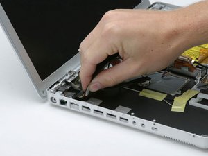

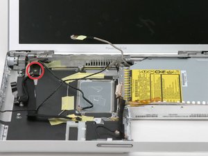

Pull the flat, black DC power cable up from the bottom of the case, removing tape as necessary.
Lift up the front right corner of the DC-In board and rotate it clockwise to slide the power receptacle out of the lower case.
