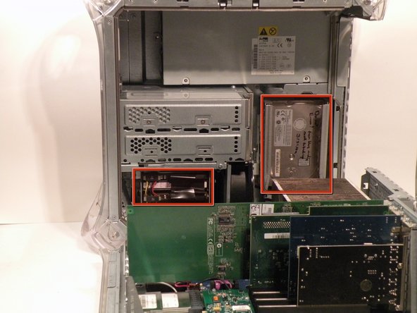

  • The hard drive cages are located here.

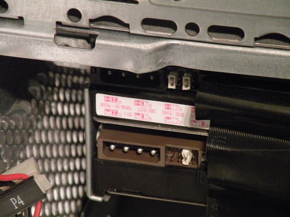

  • Start by removing this screw.
  • Remove the IDE ribbon cable from the motherboard.

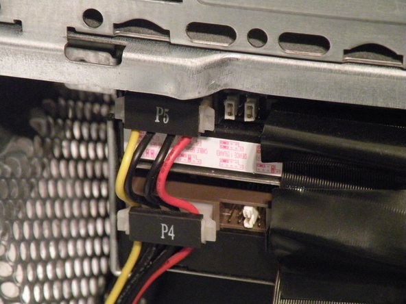

  • Now, remove the power connecton from the drives.

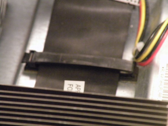

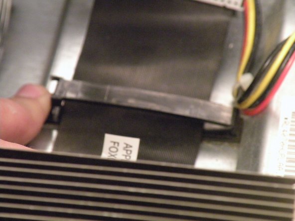

  • It's likely that there is a cable clip holding the ribbon cable to the case.
  • To remove it, push the end, and it should pop up.
