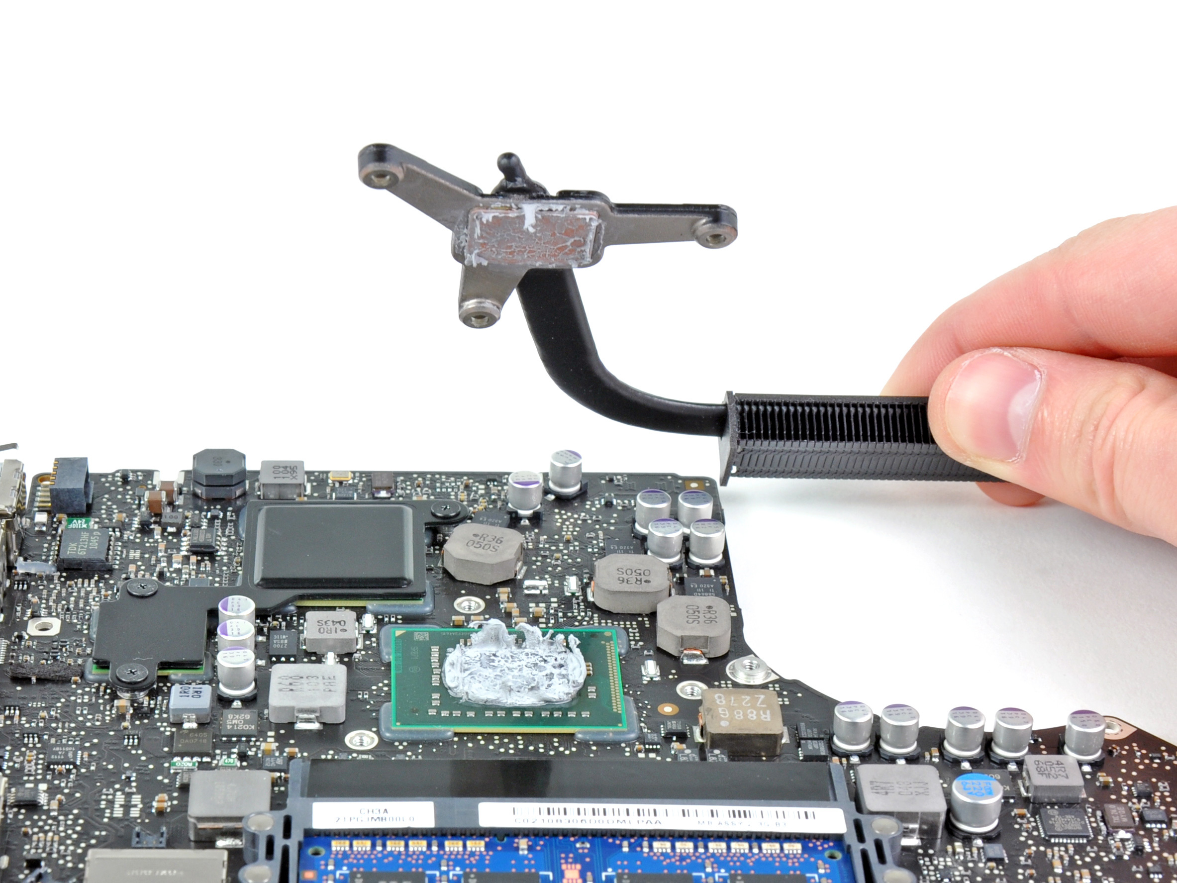

  27. MacBook Pro 13" Unibody Late 2011 Logic Board Replacement: step 27, image 1 of 2 MacBook Pro 13" Unibody Late 2011 Logic Board Replacement: step 27, image 2 of 2
    • Remove the three 8.4 mm #1 Phillips screws securing the heat sink to the logic board.
    • Don't lose the springs held under each of the screws.
    • Carefully remove the heat sink from the processor.
    • If the heat sink seems to be stuck, it may be helpful to gently pry it off the processor with a plastic spudger. Be careful not to break any surface mount components on the processor while prying.
    • Be sure to clean off the old thermal paste and apply a new layer before you reinstall the heat sink. We have a guide that makes it easy.
