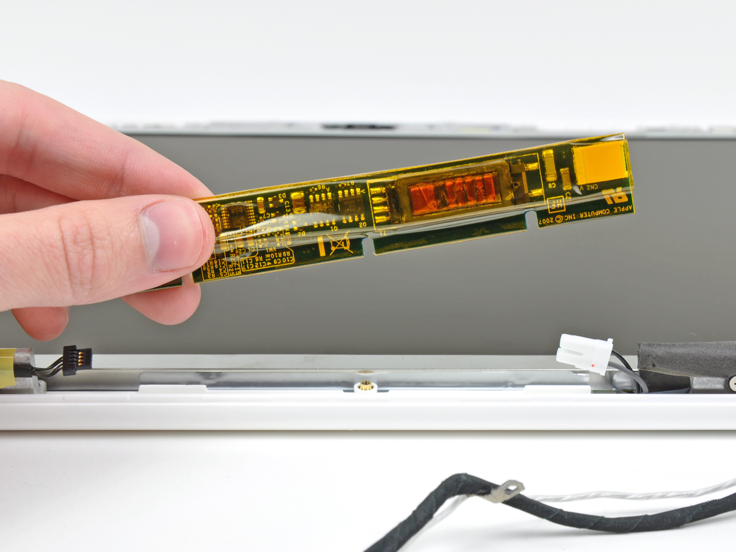

  30. MacBook Core 2 Duo Inverter Replacement: step 30, image 1 of 2 MacBook Core 2 Duo Inverter Replacement: step 30, image 2 of 2
    • Deroute the microphone cable and the black display data cable from the tabs at the bottom of the subwoofer.
    • During reassembly, while there may seem to be more than one way to route the cables, the best way is as shown in photo 2. Click on the photo for a larger view.
  31. MacBook Core 2 Duo Inverter Replacement: step 31, image 1 of 1
    • Remove the single 3 mm Phillips screw securing the ground lug in the display data cable located just above the Bluetooth board. This screw may also be securing a ground lug in the speaker cable.
  32. MacBook Core 2 Duo Inverter Replacement: step 32, image 1 of 2 MacBook Core 2 Duo Inverter Replacement: step 32, image 2 of 2
    • Disconnect the antenna cables from the Airport card:
    • If you have an original MacBook Core Duo or Core 2 Duo model, see the first picture, which shows that there are three antenna cables.
    • If you have a MacBook Core 2 Duo Santa Rosa/Penryn or 2009 model, there are only two antenna cables, and the plug/socket for the black inverter cable is in a different location. There may be a square foam piece over the plug/socket for the inverter board connector.
    • Disconnect the inverter cable from its socket by inserting a spudger between the right or left ends of the plug and the socket, and prying gently vertically. Do NOT pry up on the socket--you must pull up on the plug alone, vertically out of the socket. Do not pull in the direction of the cable wires or you will tear the socket off the logic board.

  45. MacBook Core 2 Duo Inverter Replacement, Inverter: step 45, image 1 of 2 MacBook Core 2 Duo Inverter Replacement, Inverter: step 45, image 2 of 2
    • Slightly lift the newly-revealed inverter board out of its housing and disconnect the black inverter cable from the left end of the board.
  46. MacBook Core 2 Duo Inverter Replacement: step 46, image 1 of 2 MacBook Core 2 Duo Inverter Replacement: step 46, image 2 of 2
    • Disconnect the white inverter cable from the right end of the inverter board.
  47. MacBook Core 2 Duo Inverter Replacement: step 47, image 1 of 1
    • Remove the inverter board from the display.
