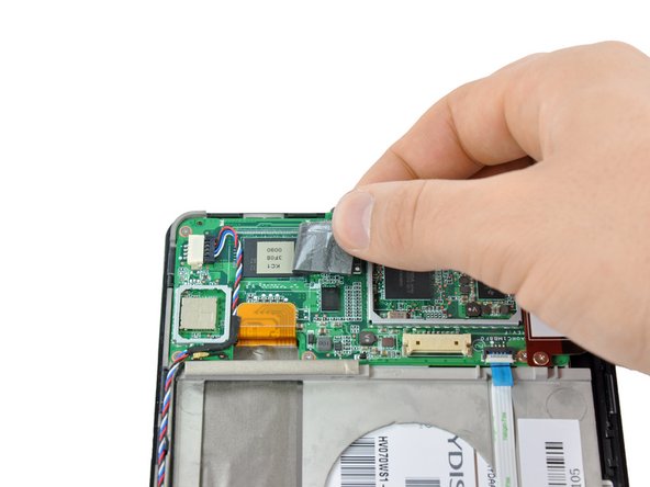

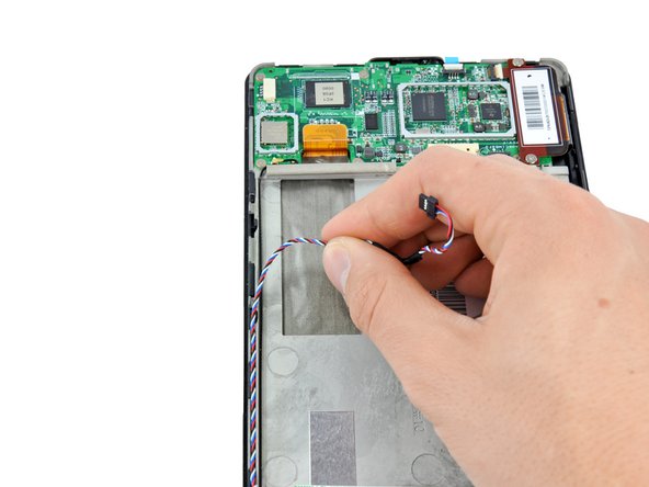

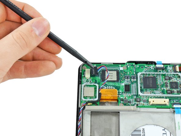

  6. Kindle Fire Motherboard Replacement, Speaker Cable: step 6, image 1 of 3 Kindle Fire Motherboard Replacement, Speaker Cable: step 6, image 2 of 3 Kindle Fire Motherboard Replacement, Speaker Cable: step 6, image 3 of 3
    • Peel the tape on the upper-left IC that is securing the speaker cable.
    • Use the flat end of a spudger to push the speaker connector out of its socket.
    • Deroute the speaker cable so that it will not interfere with the motherboard.
