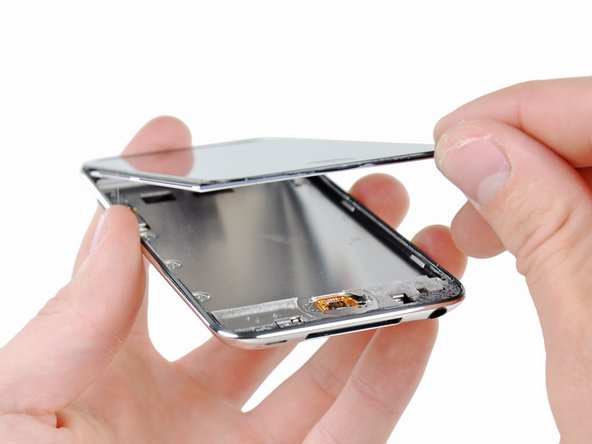

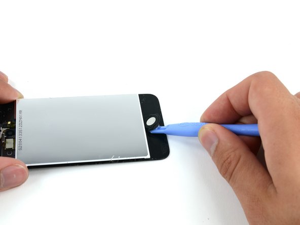

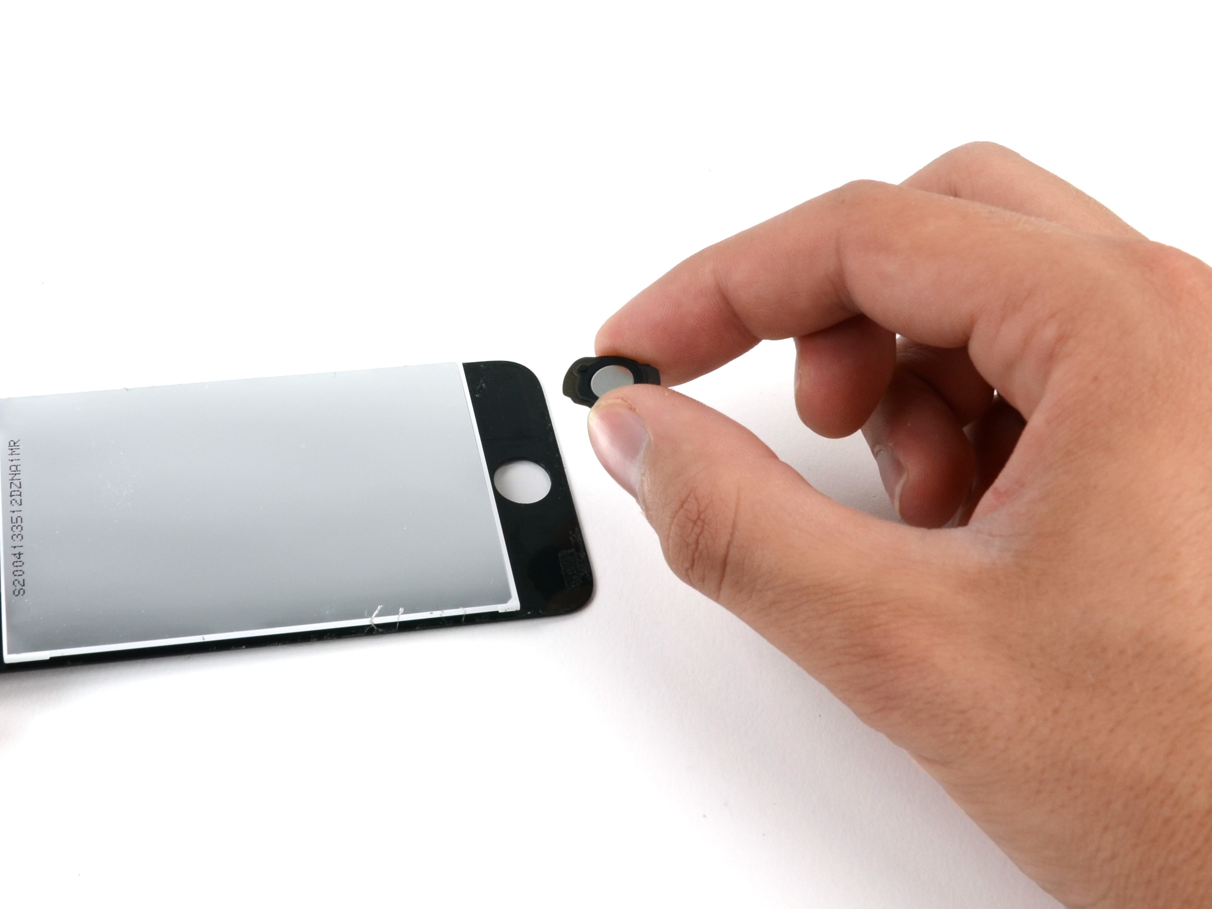

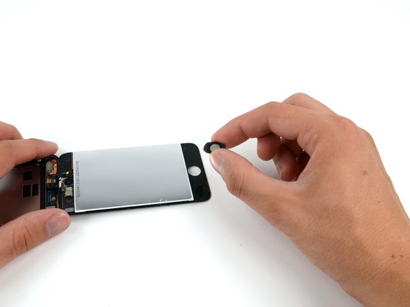

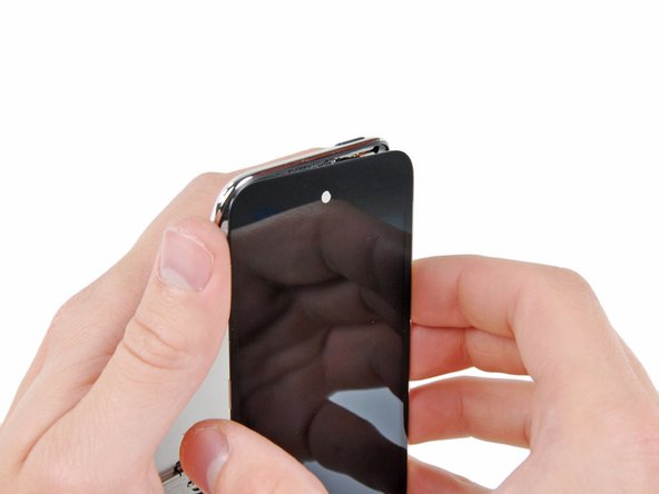

Click. Click. Pfft. Has your home button stopped clicking? Use this guide to replace it. This guide is for replacing the plastic home button cover. If you need to replace the functional home button switch, go to this guide.

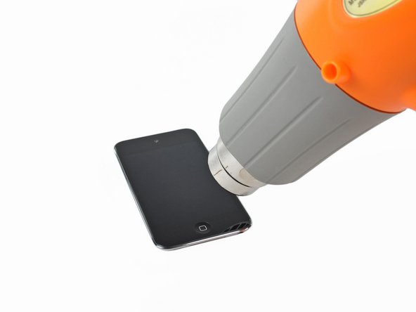

With the heat gun set on "low", begin heating the lower portion of the Touch near the home button.

If you follow the guide from the bottom to the top, you can reassemble the device. If you disassembled the phone farther than the Home Button guide shows, go back to the device page and follow the guide that matches your device.
