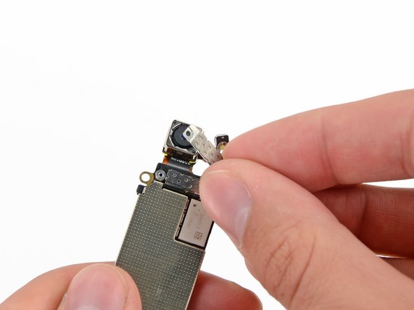

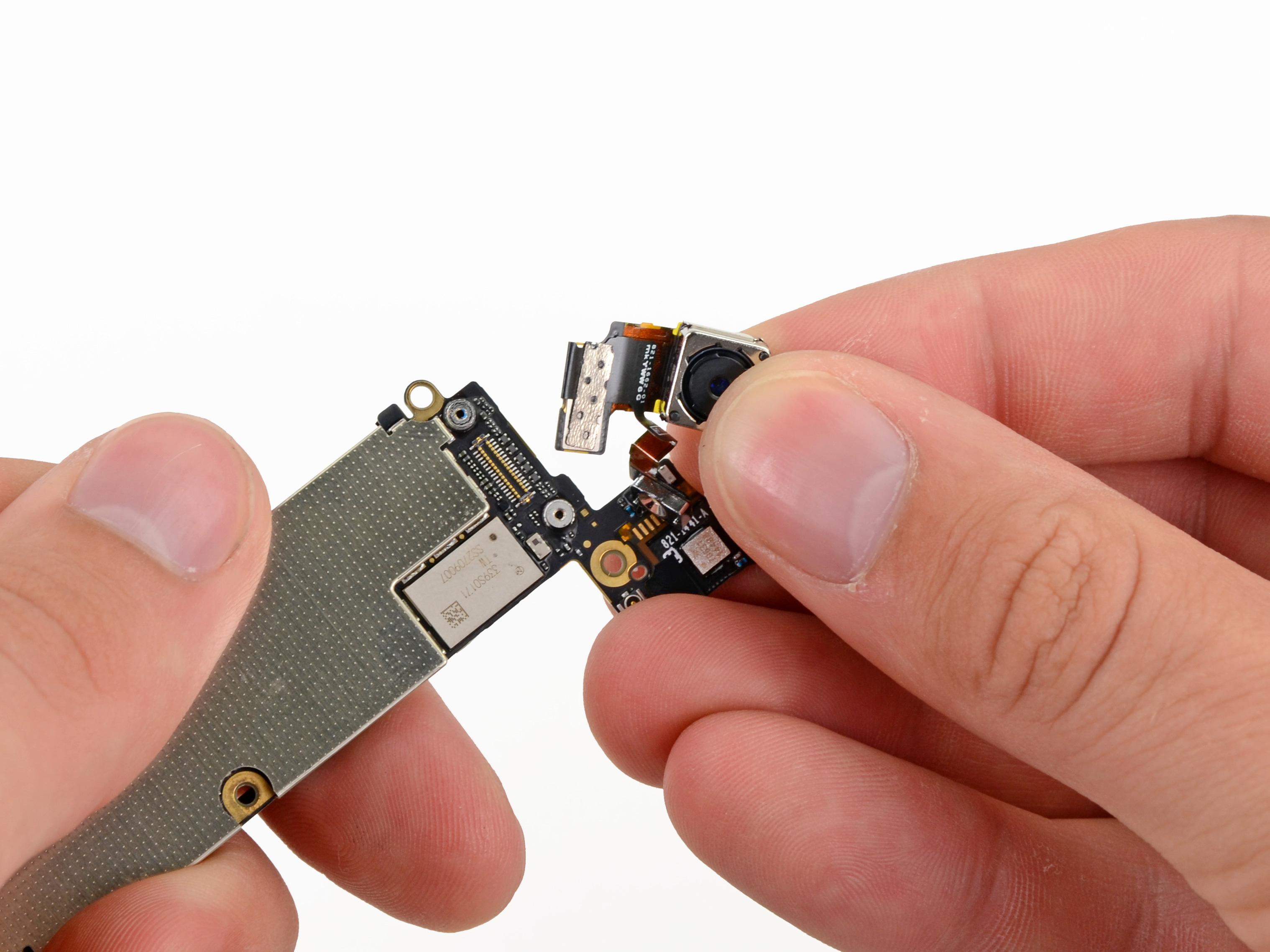

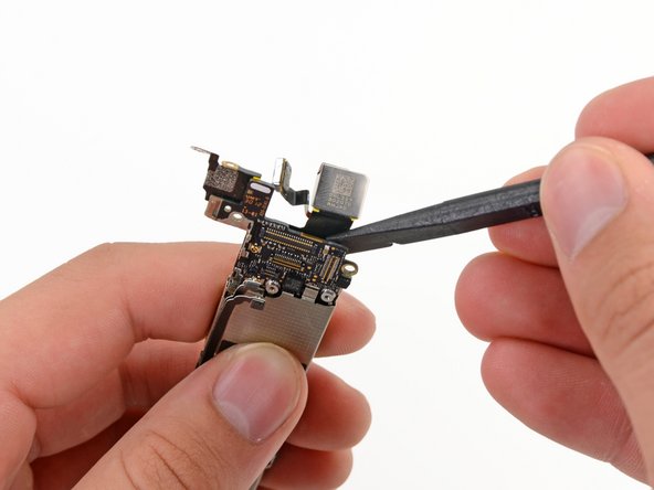

  23. iPhone 5 Rear-Facing Camera Replacement: step 23, image 1 of 3 iPhone 5 Rear-Facing Camera Replacement: step 23, image 2 of 3 iPhone 5 Rear-Facing Camera Replacement: step 23, image 3 of 3
    • Use the flat end of a spudger to disconnect the following three cables from the logic board:
    • Upper interconnect cable
    • Button assembly cable
    • Lower interconnect cable
  24. iPhone 5 Rear-Facing Camera Replacement: step 24, image 1 of 1
    • Remove the two 1.3 mm Phillips screws from the inner top of the rear case.
  25. iPhone 5 Rear-Facing Camera Replacement: step 25, image 1 of 1
    • Remove the single 1.2 mm Phillips screw remaining in the mid-section logic board bracket.
  26. iPhone 5 Rear-Facing Camera Replacement: step 26, image 1 of 2 iPhone 5 Rear-Facing Camera Replacement: step 26, image 2 of 2
    • Remove the mid-section bracket from the logic board.
  27. iPhone 5 Rear-Facing Camera Replacement: step 27, image 1 of 2 iPhone 5 Rear-Facing Camera Replacement: step 27, image 2 of 2
    • Use a spudger to pry the Lightning connector cable connector up from its socket on the logic board.
    • Gently peel the cable back and out of the way of the logic board.
  28. iPhone 5 Rear-Facing Camera Replacement: step 28, image 1 of 3 iPhone 5 Rear-Facing Camera Replacement: step 28, image 2 of 3 iPhone 5 Rear-Facing Camera Replacement: step 28, image 3 of 3
    • Depress the SIM card release on the right side of the iPhone with a SIM card eject tool or a bent paperclip to eject the SIM card tray.
    • Alternatively, you can press the SIM card eject lever from the inside with the flat end of a spudger.
    • Remove the SIM card tray from the iPhone.
  29. iPhone 5 Rear-Facing Camera Replacement: step 29, image 1 of 1
    Tool used on this step:
    Standoff Screwdriver for iPhones
    $5.49
    Buy
    • Remove the following screws securing the logic board to the rear case:
    • Two 2.3 mm Phillips screws
    • Two 2.7 mm standoff screws
    • Standoff screws are best removed using a standoff screwdriver or bit.
    • In a pinch, a small flathead screwdriver will do the job—but use extra caution to ensure it doesn't slip and damage surrounding components.
    • One non-magnetic 2.7 mm standoff screw
    • Be sure to put this screw back in its original position at the top of the logic board. A magnetized screw may interfere with the digital compass.
  30. iPhone 5 Rear-Facing Camera Replacement: step 30, image 1 of 3 iPhone 5 Rear-Facing Camera Replacement: step 30, image 2 of 3 iPhone 5 Rear-Facing Camera Replacement: step 30, image 3 of 3
    Buy
    • Rotate the logic board assembly toward the battery side of the rear case.
    • Do not attempt to completely remove the logic board assembly from the rear case, yet; there is still one cable connected to the underside of the logic board.
    • The flash surround is adhered to the flash unit and the rear case. If it stays on the rear case remove with tweezers and mount it back on the flash unit.
    • Note: when reassembling your device, be sure that the lower interconnect cable is not tucked underneath the logic board.

  34. iPhone 5 Rear-Facing Camera Replacement: step 34, image 1 of 2 iPhone 5 Rear-Facing Camera Replacement: step 34, image 2 of 2
    • Remove the rear-facing camera bracket from the logic board.
  35. iPhone 5 Rear-Facing Camera Replacement: step 35, image 1 of 1
    • Use the flat end of a spudger to disconnect the rear-facing camera cable from its socket on the logic board.
  36. iPhone 5 Rear-Facing Camera Replacement: step 36, image 1 of 2 iPhone 5 Rear-Facing Camera Replacement: step 36, image 2 of 2
    • Remove the rear-facing camera from the logic board.
    • Your replacement part may not come with the flash surround—if not, remove it from the old camera and transfer it to your replacement.
