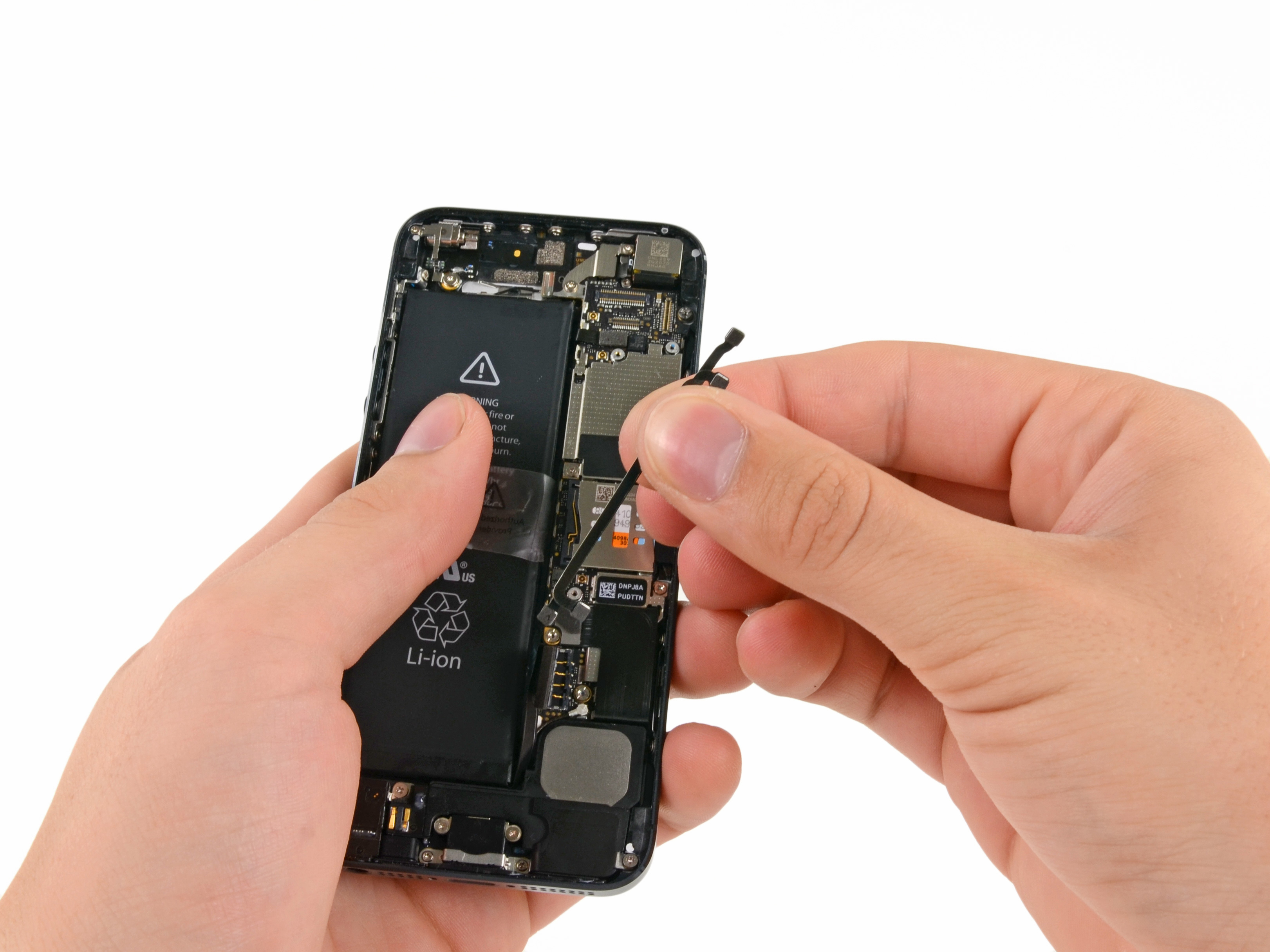

  20. iPhone 5 Interconnect Cables Replacement, Interconnect Cables: step 20, image 1 of 1
    • Remove the single 1.2 mm Phillips screw remaining in the mid logic board bracket.
    • Remove the mid logic board bracket.
  21. iPhone 5 Interconnect Cables Replacement: step 21, image 1 of 2 iPhone 5 Interconnect Cables Replacement: step 21, image 2 of 2
    • Use a plastic opening tool to pry the two interconnect cables up from their sockets at the top of the logic board.
  22. iPhone 5 Interconnect Cables Replacement: step 22, image 1 of 1
    • Disconnect the two interconnect cables from the bottom of the logic board in the same manner described above.
  23. iPhone 5 Interconnect Cables Replacement: step 23, image 1 of 3 iPhone 5 Interconnect Cables Replacement: step 23, image 2 of 3 iPhone 5 Interconnect Cables Replacement: step 23, image 3 of 3
    • Remove the interconnect cables from the iPhone.
    • Replacement interconnect cables may be not be pre-adhered to each other. Align the two cables as shown for installation.
