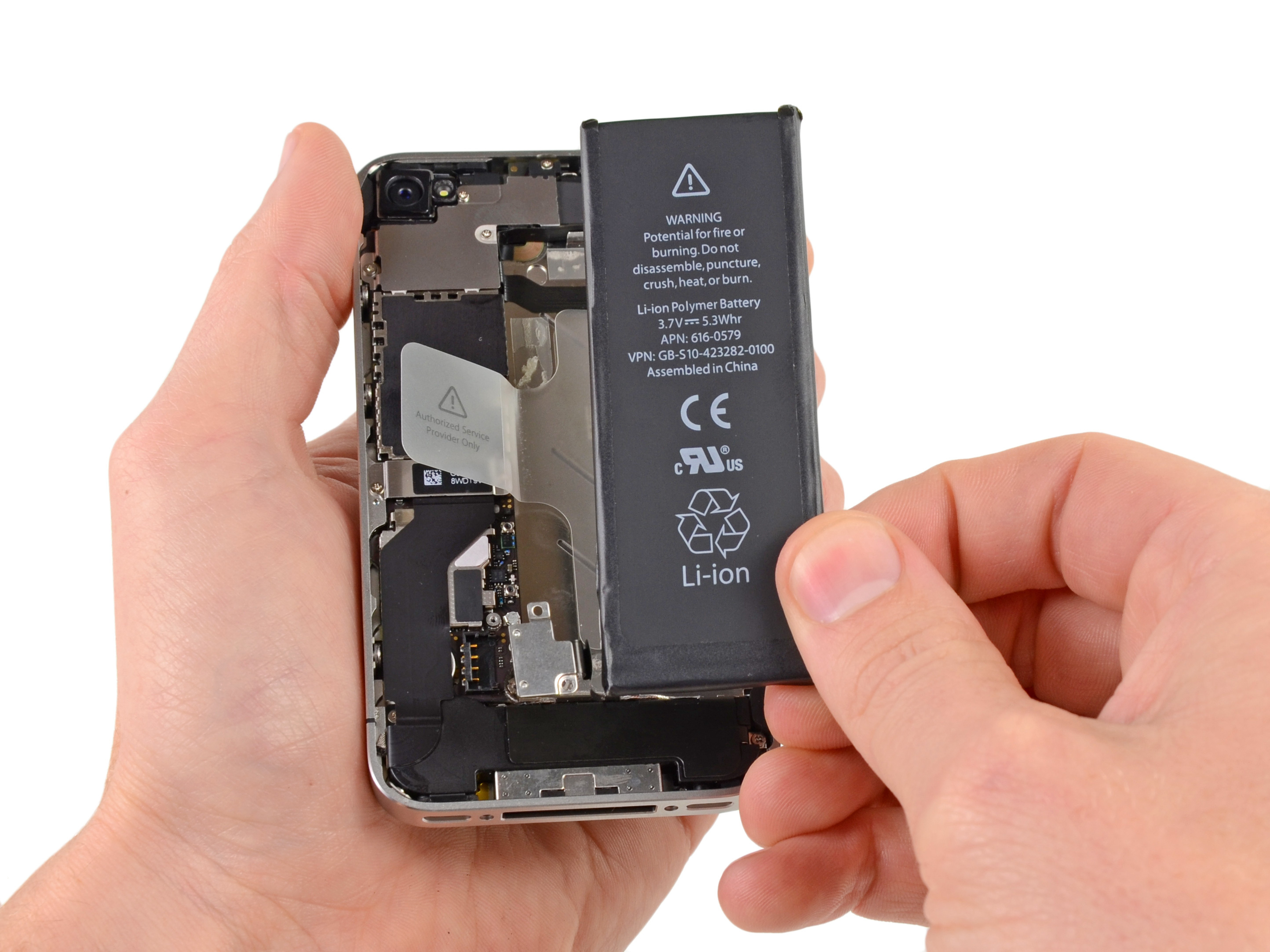

  9. iPhone 4S Battery Replacement: step 9, image 1 of 2 iPhone 4S Battery Replacement: step 9, image 2 of 2
    • Use the exposed clear plastic pull tab to peel the battery off the adhesive securing it to the iPhone.
    • Be careful not to pull the plastic pull tab too hard as it can be ripped off very easily.
    • Remove the battery.
    • If your replacement battery came in a plastic sleeve, remove it before installation by pulling it away from the ribbon cable.
    • If your replacement battery came with an uncreased cable, carefully crease the cable into the proper shape before installing the battery into the phone.
    • While installing the replacement battery, temporarily connect the battery connector to the phone to ensure proper alignment. Once the battery is glued in place, disconnect the battery connector.
    • Perform a hard reset after reassembly. This can prevent several issues and simplify troubleshooting.
