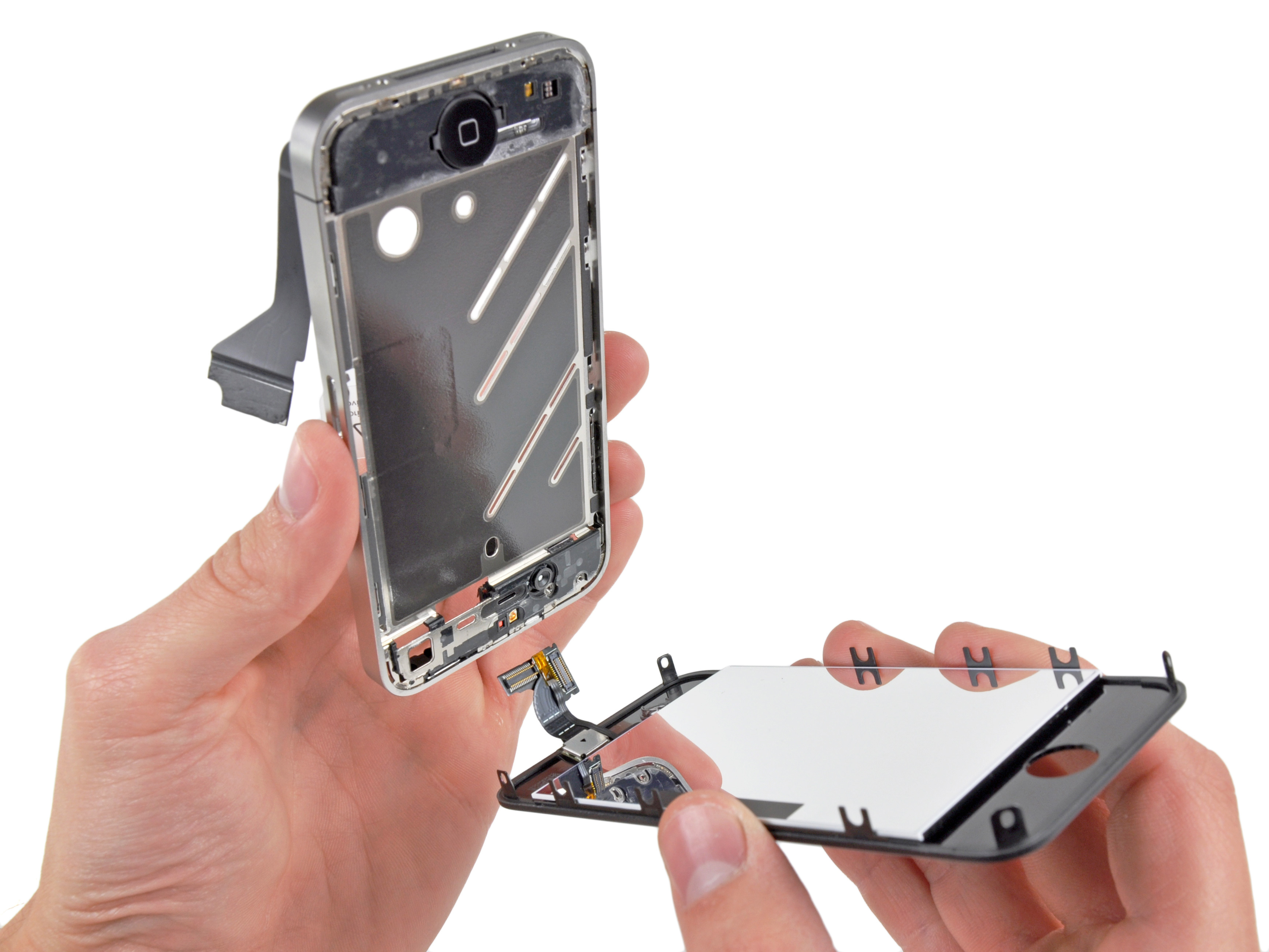

  30. iPhone 4 (GSM/AT&T) Screen Replacement: step 30, image 1 of 3 iPhone 4 (GSM/AT&T) Screen Replacement: step 30, image 2 of 3 iPhone 4 (GSM/AT&T) Screen Replacement: step 30, image 3 of 3
    • De-route the digitizer and LCD cables through the steel inner frame, and remove the display from the iPhone.
    • When reinstalling the display, carefully straighten the digitizer and LCD data cables, and feed them through the slot cut in the steel frame. This photo shows the display assembly being installed incorrectly, with a fold in the digitizer cable.
    • When the front panel has been correctly installed, both the LCD and digitizer cables should be immediately next to one another and should be the same length, as shown in the second photo.
    • If the digitizer cable has not been installed correctly, it will not reach its socket on the logic board. Do not attempt to pull it through by force, or it will tear. Remove the display assembly, straighten the cable, and feed it through to its full length, as shown.
    • During reassembly, do not touch the metallic area at the base of the LCD data cable, as this can cause problems with the LCD. If you do touch it accidentally, clean it gently with an alcohol wipe before continuing.

Done! Boy, it took me 1.5 but done. Anyway don't forget guys it's quality that counts so don't hurry up, take your time & get light (lots of light above you). Get a coke and it will work it. I reassembled everything, turned it on and home button working yeah. Ouch, my screen was no more sensitive. I killed the digitizer cable. Lucky me I had another broken iPhone which i took the LCD and put it on my phone. (about 1.5 again to reassemble everything back)
Tip 1: I did the whole thing with [linked product missing or disabled: IF145-047] and I had everything I needed.
Tip 2: Print Home_Button_Screw_Template.pdf (you'll need it) Find a magnet pad to put under your A4 paper. This will help hold the screws.
Tip 3: Use a suction cup at step 28. It found it in my [linked product missing or disabled: IF145-047]
Tip 4: I killed my digitizer cable at step 29 & 30. So please pay double attention there.
Tip 5: Get yourself a beer when finished :)
Rapstorm - Reply
Only do tip 5 AND AGAIN ONLY do if your 21 or older
Ben Capehart -
i did it success but the sensor dosnt work what the problem
abdallah hanoud - Reply
Great guide, but I can't seem to get the back panel on afterwords. All of the plastic tabs seem to line up correctly but it won't slide down into place. Any advise?
Ruben - Reply
I had the same problem.
Rear panel did not seem to slide back in to place.
After googling I found this tip:
Back panel will not slide back on?
If everything looks fine and aligned then you might just need to use a bit more force.
Worked for me :)
