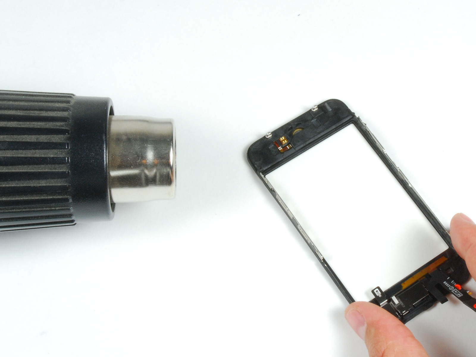

  15. iPhone 3GS Front Panel Replacement: step 15, image 1 of 3 iPhone 3GS Front Panel Replacement: step 15, image 2 of 3 iPhone 3GS Front Panel Replacement: step 15, image 3 of 3
    • Be careful when using a heat gun in the forthcoming steps. Use it at a very low heat setting, and make sure not to melt the touch screen plastics or Home button. The metal frame tends to conduct heat very well so try to avoid touching these hot areas.
    • If the glass has shattered at the top or bottom be especially patient and gentle when removing fragments. In extreme cases you may have to pick off any glass shards that remain glued to the plastics.
    • Using a heat gun or hairdryer, heat the top left area of the touch screen.
    • Use your fingernails to slowly lift up the left corner. The touch screen plastics are held to the touch screen with adhesive. It may take some work to free the corners.
    • If it seems like too much force is being applied to lift the touch screen plastics, try using the heat gun again.
    • Heat and repeat for the right side.

Step 15:
the screen sort of sits in the plastic because of the band of material running around the perimeter of the assembly being more firmly attached to the plastic than the screen. I found this step much easier to complete the second time around because i knew to dig my nail in between the screen and the material running around the perimeter of the assembly in a front to back motion. Then i pivoted my nail up 90 degrees so it was between the plastic and the screen and was able to gently pry them apart while heating.
tdbrennan - Reply
i second that, it should really be another bulletpoint because its really hard to see if you are not looking for it. Something like:
Push gently on the thin plastic bezel surrounding the frontpanel, do not try to push into the side of the assembly. It can look like there is a seam but there is not!
Its really the only way to get it done without ripping off any parts of the plastic bezel... it does not show when reassembled but its creating a wide portal for dust particles.
