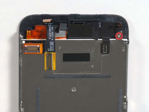

  8. iPhone 3GS Earpiece Speaker Replacement, Earpiece Speaker: step 8, image 1 of 1
    • Remove the single Phillips #00 screw from the corner of the display assembly.

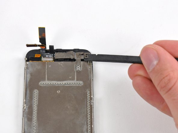

  9. iPhone 3GS Earpiece Speaker Replacement: step 9, image 1 of 3 iPhone 3GS Earpiece Speaker Replacement: step 9, image 2 of 3 iPhone 3GS Earpiece Speaker Replacement: step 9, image 3 of 3
    • Use the flat end of a spudger to pry up the right side of the ear speaker cover assembly.
    • Do not try to pry the assembly all the way off, as it is still connected at two points.

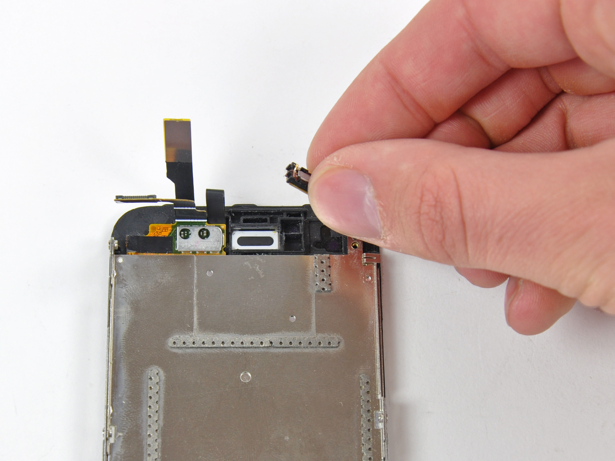

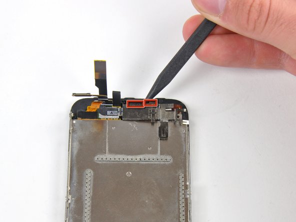

    • Turn the spudger around and use the pointed side to detach the two clips securing the top of the assembly.
    • Once the clips are detached, lift the cover assembly up from the device.

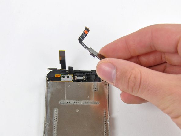

  10. iPhone 3GS Earpiece Speaker Replacement: step 10, image 1 of 2 iPhone 3GS Earpiece Speaker Replacement: step 10, image 2 of 2
    • Slide the pointed end of the spudger into the slot under the upper right corner of the ear speaker and gently pry upwards.
    • Be careful during this step, as the upper portion of the speaker can easily detach from the lower portion, causing the coil inside to unwind. Be sure to pry the entire assembly up.
    • Lift the ear speaker up and out of the device.
