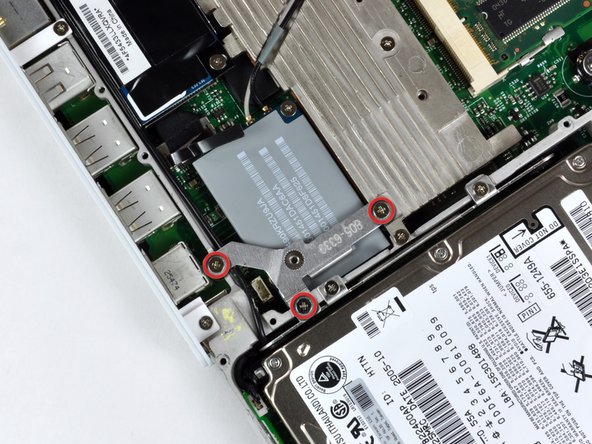

  30. iBook G4 14" 1.42 GHz AirPort Extreme Card Replacement, AirPort Extreme Card: step 30, image 1 of 1
    • Remove the following three screws from the AirPort card bracket:
    • Three 3 mm Phillips screws.
    • Lift the metal AirPort card retaining bracket up and out of the computer.

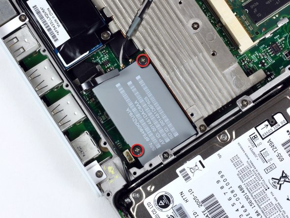

  31. iBook G4 14" 1.42 GHz AirPort Extreme Card Replacement: step 31, image 1 of 1
    • Remove the two 3 mm Phillips screws securing the AirPort card to the logic board.

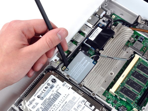

  32. iBook G4 14" 1.42 GHz AirPort Extreme Card Replacement: step 32, image 1 of 1
    • Using a spudger, pry up on the AirPort card from the end nearest to the hard drive to separate the connector from the logic board.
    • Be sure to pry only between the metal framework and the AirPort card.

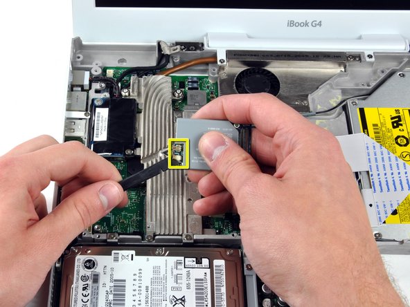

  33. iBook G4 14" 1.42 GHz AirPort Extreme Card Replacement: step 33, image 1 of 1
    • Hold the AirPort card in one hand and use a spudger to disconnect the two antenna cables.
    • AirPort card remains.
