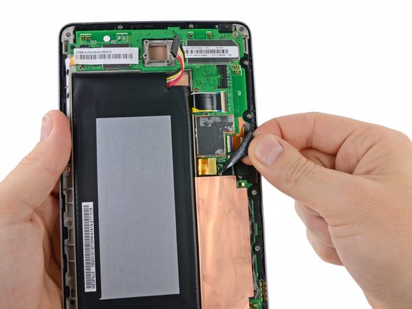

  7. Nexus 7 Display Assembly Replacement, Display Assembly: step 7, image 1 of 2 Nexus 7 Display Assembly Replacement, Display Assembly: step 7, image 2 of 2
    • Peel the upper piece of black adhesive tape completely up off the Nexus 7.
    • Similarly, peel the lower piece of black adhesive tape, but only as far as the copper strip.
    • It is helpful to fold this piece of tape back on itself to keep it out of the way.
    • Whilst pulling the tape, be sure that the metal shield does not lift up. Hold the shield in place, and if it lifts up, re-seat it in the spring clips around the perimeter of the shielded area.
  8. Nexus 7 Display Assembly Replacement: step 8, image 1 of 1
    • Use the flat end of a spudger to pry the display data cable straight up off its socket on the motherboard.
  9. Nexus 7 Display Assembly Replacement: step 9, image 1 of 3 Nexus 7 Display Assembly Replacement: step 9, image 2 of 3 Nexus 7 Display Assembly Replacement: step 9, image 3 of 3
    • Use the flat end of a spudger to carefully flip up the retaining flaps on the digitizer ribbon cable ZIF sockets.
    • Make sure you are flipping up the white retaining flaps, not the black sockets themselves.
    • Use the tip of a spudger to pull the digitizer ribbon cable straight out of its socket.
