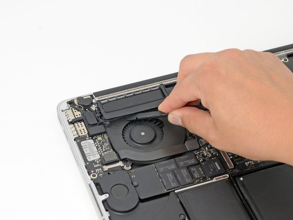

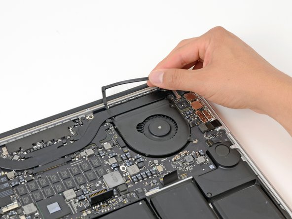

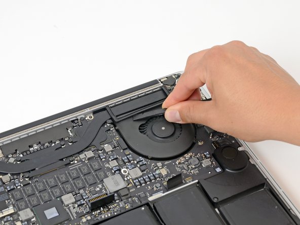

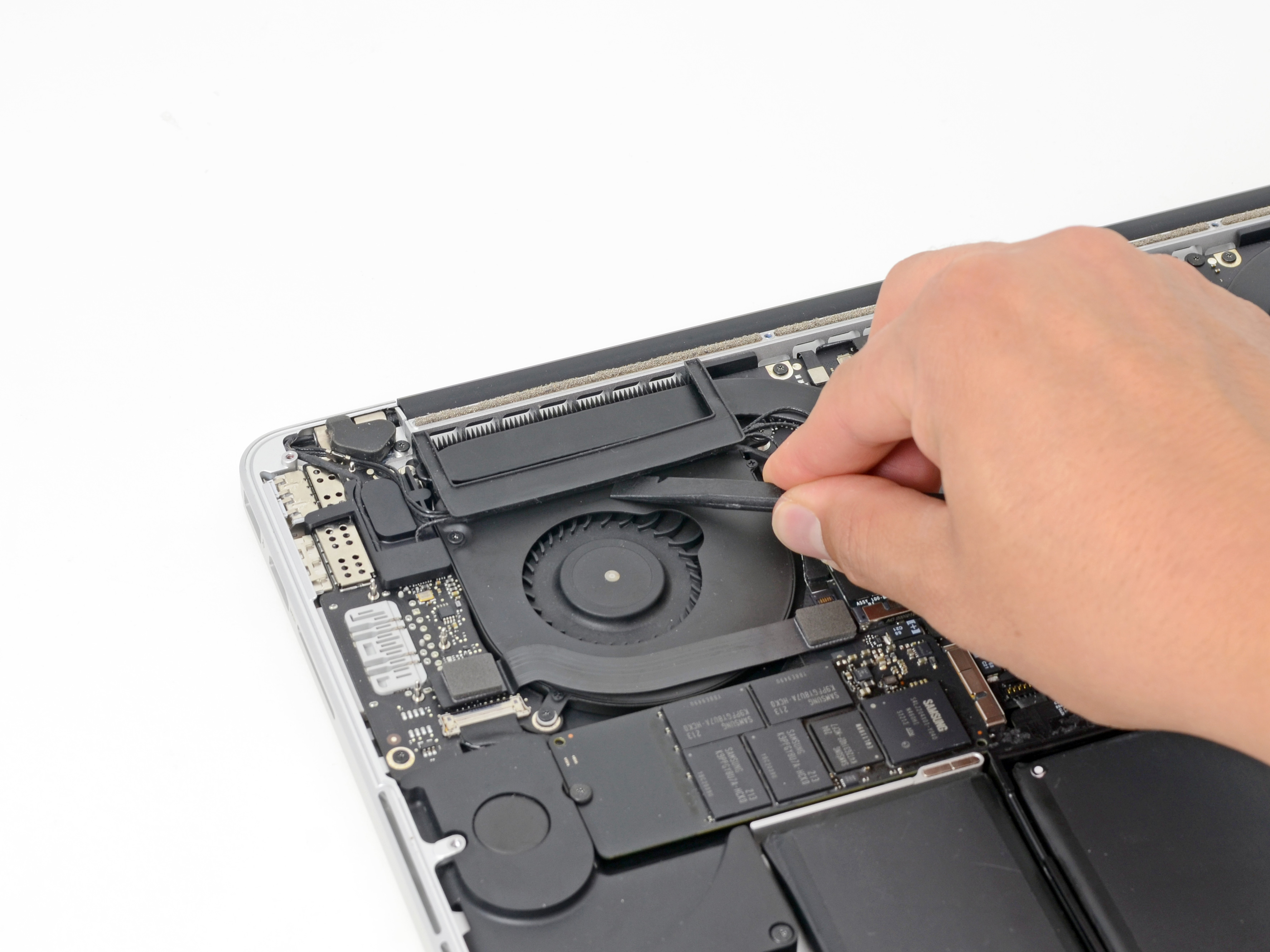

  5. MacBook Pro 15" Retina Display Mid 2012 Heat Sink Replacement, Heat Sink: step 5, image 1 of 3 MacBook Pro 15" Retina Display Mid 2012 Heat Sink Replacement, Heat Sink: step 5, image 2 of 3 MacBook Pro 15" Retina Display Mid 2012 Heat Sink Replacement, Heat Sink: step 5, image 3 of 3
    • Insert the flat end of a spudger underneath the rubber heat sink cover on the right fan.
    • Slide the spudger underneath the length of the cover, releasing the adhesive.
    • Lift the cover and rotate it off of the heat sink.

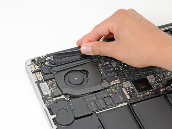

  6. MacBook Pro 15" Retina Display Mid 2012 Heat Sink Replacement: step 6, image 1 of 3 MacBook Pro 15" Retina Display Mid 2012 Heat Sink Replacement: step 6, image 2 of 3 MacBook Pro 15" Retina Display Mid 2012 Heat Sink Replacement: step 6, image 3 of 3
    • In the same manner described above, release the adhesive and flip back the heat sink cover on the left fan.
