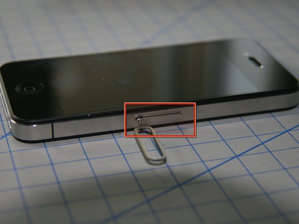

    • Remove the SIM Card from each of the iPhones
    • On the iPhone 4 the SIM Card tray is on the right side of the phone.
    • On any older iPhone the SIM Card tray is on the top of the phone.

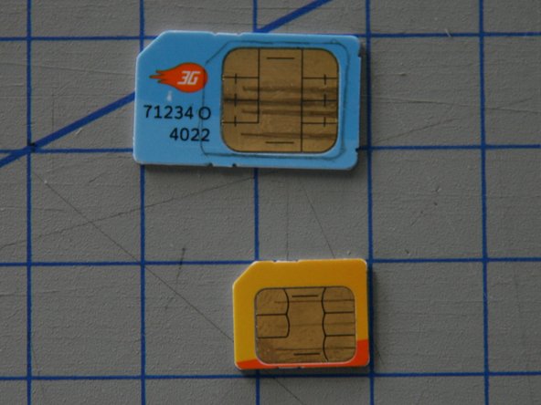

  3. Create a Micro-SIM to SIM Adapter: step 3, image 1 of 2 Create a Micro-SIM to SIM Adapter: step 3, image 2 of 2
    • Use a pencil to trace the Micro-SIM on top of the older SIM-Card.
    • Make sure the leads line up with the ones below them!
