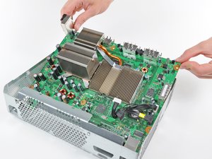

The Red Ring of Death has become an infamous sign of a malfunctioning Xbox 360 since its launch. The RROD is characterized by three red lights creating a 3/4 circle around the power button.

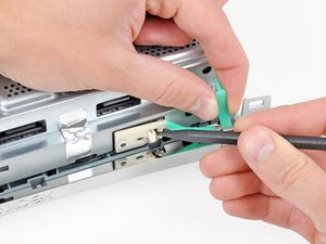

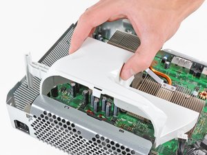

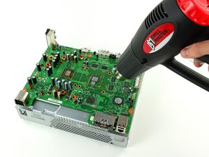

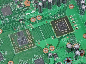

Most, if not all, three-light errors in Xbox 360 consoles are related to overheating. The most common issue is a cracked or cold solder joint underneath the GPU on the motherboard. A flaw in the design of the heat sink allows the motherboard to warp in the area around the chip, which causes the chip to lose contact with the board. There are various fixes for the RROD, which include replacing the high-stress x-clamp, reflowing the GPU's solder connection, and also replacing the heat sink in older models with Microsoft's updated Zephyr heat sink.

If the RROD is already plaguing your Xbox, and your console is no longer covered by Microsoft's warranty, there is hope yet. You can use the technique outlined on the full troubleshooting page to retrieve an error code from your console to determine what the specific cause of your RROD is. After pinpointing the cause, you can take the necessary action to remove the diabolical red ring and get back to ruling Xbox Live.
