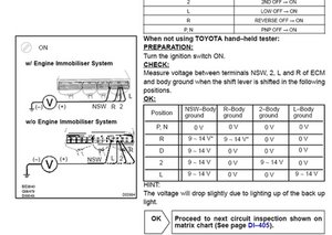

Back–Up Light remains always ON you should check the Park/Neutral Position Switch (A/T) Amazingly enough, your Camry does not have a separate switch.If it needs to be replaced it seems to be a pretty expensive item for a simple fault like this. "The park/neutral position switch detects the shift lever position and sends signals to the ECM.
The ECM receives signals (NSW, R, 2 and L) from the park/neutral position switch. When the signal is not sent to the ECM from the park/neutral position switch, the ECM judges that the shift lever is in D position."
When not using TOYOTA hand–held tester:
PREPARATION:
Turn the ignition switch ON.
CHECK:
Measure voltage between terminals NSW, 2, L and R of ECM and body ground when the shift lever is shifted in the following positions.
Position NSW–Body R–Body 2-Body L-Body
ground ground Ground Ground
P, N 0V 0V 0V 0V
R 9~14V 9~14V 0V 0V
D 9~14V 0V 0V 0V
2 9~14V 0V 9~14V 0V
L 9~14V 0V 0V 9~14V
If OK Proceed to next circuit inspection shown on matrix chart
If no good Check park/neutral position switch.
