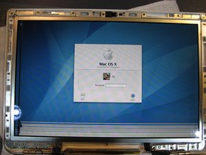

Hi everybody,I am attaching some pictures of the lines on my sons Macbook,
my question is is this a damaged LCD,LCD driver or something else ..?
I like to be sure before I order new LCD
thank you for your time (big help) !

It seems to be a bad LCD panel. Does the image change when you apply pressure on the sides of the LCD panel ? You may try first to replace the LVDS (video cable) or double check if the cable is well connected to the panel (and logic board). Also if you want to be sure that the MacBook logic board is not faulty connect the computer to an external monitor and if the video is normal then the logic board should be OK.

Looks like a bad LCD, but to be sure, connect to an external display and see if the picture is fine there.

cracked LCD, it might grow larger in time. Pay attention at the way is fixed in hinges so not to get bigger (wrong placement, tensions in lcd)

Definitely a cracked LCD. I am an Apple Service Technician. You can do the replacement on your own if you have a putty knife (slim) and a #00 phillips screwdriver.
