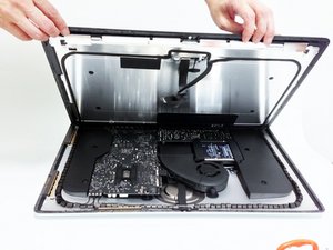

The problem is not to open the iMac, and yes, I think there are no problems with an SSD instead of the built-in HDD, according to some experience on the web it will take about 10 minutes to open the iMac, take away the HDD, replace it with an SSD, and make it work.
The real "problem", is to replace the glue stick to close the iMac properly....
I'm going to buy this iMac, and I'm thinking about the "adventure" to replace the HDD with the SSD (like I did on my old Early 07 MBP... (and no, there are no fan spinning crazily or other problem caused by trim or not, and however there's an app called trim enabler...)... But I'm really "scared" about this thing of the glue sticks to replace the original glue...

There's no problem to open the imac, it' really simple. Just pick one of the slats you can find in many shirt collar and use it to remove the glue.
http://d.pr/i/7tlk
You just have to use it like a sort of knife between the display and the alluminium body...
http://d.pr/i/OyGz

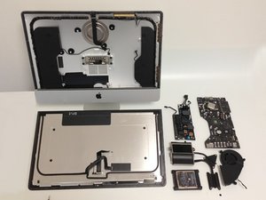

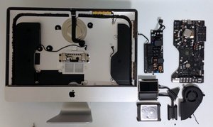

Then remove the monitor like it is explained in the ifixit tutorial.
Remove the hdd and replace it with the ssd. (Clone the hdd in the ssd with carbon copy cloner and at the firts boot press cmd alt p r to reset the pram)
I use a samsung 840 500 gb. It's not the pro version but the difference is not relevant, IMHO.
To close the imac I used a 3m tape.

Lo apri, stacchi i due connettori del monitor, togli il monitor e poi è tutto lì a portata di mano. Ci sono 4 viti in croce da togliere, ci metti due secondi. Togli l'HD e metti l'SSD....

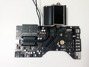

Kodawarisan had open the new iMac.
there is a slot to insert a strip SSD Apple even on the entry-level model that does not default, it will still find a way to get them or someone so this adapter connector to the SATA classic...
See opened iMac pictures from Kodawarisan

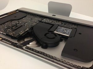

I have a late 2012 iMac 21.5" computer that had a 1TB 5400rpm drive that failed. I did a LOT of research on how to upgrade it. Honestly, there were no definite posts that you could. So let me tell you that it can be done. I swapped my existing drive with a Samsung 850 EVO 1TB SSD and it worked perfectly. The only issue was getting the screen removed from the casing. After additional research, I settled on my daugther's guitar pick. Although a bit tedious (I didn't want to crack the screen or damage any internal components), it worked perfectly.
Once the screen was removed, it was a quick four screws to change the drive. I had no issues with the fans (Apple has some proprietary thermal computer / drive connection). The computer works perfectly and is much, much faster than the old 5400RPM drive. For $350, I have a new, wicked fast computer that I'm very happy with.
