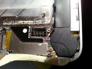

Hi to all,
this is my first post here. I heard about this forum on another website...that hear are professionals and they could help me maybe.
So my problem...i have bought an used iPhone 4 which is factory unlocked and jailbreaked. When i put my sim card inside i can use
WIFI without problems, but i don't get phone signal...always searching and no signal - no service.
So i decided to open the phone, and look...
- i see a broken signal antenna which was not connected anymore (I will buy a new one and replace it)
- the battery bracket connector was not there - somebody removed it and lost (I will buy a new one and replace it)
- i don't see the small blue capacitor-coil...and there shold be another small capacitor (smd)...look at the picture (?????)
[B]
Picture: http://oi46.tinypic.com/n532i8.jpg [/B]
Can somebody tell me if this is normal that there is no capacitor near the antenna connection? I looked on other pictures of iphone logic boards and
saw, that they have a small blue capacitor there and also another one capacitor, which is same size but not blue.
Should i buy new smd capacitors and solder on the board or? What are the suggestions...and what type of capacitor is this...what mode, how many V and what capacity in uF?
Thank you guys for your help in advance!

Hi,
Please check the image:
Red :This is the antenna.You have to change it.
Blue : The antenna connector.Try to repear it somehow or just change it.
Yellow: Just make a bridge between this two points.

You have to solder thin cable like in the pic:

this is a very simply repair if one knows how to. simply run a small wire from the left side of the antenna to the far left antenna bridging it across the blue coil and hey presto! signal works again!

Hi to all :)
Many thanks to everybody for all your answers and help.
1. I ordered a new antenna and replaced it
2. I just straightened antenna connector a little bit
3. I did solder a bridge - where the blue coil should be located
And the signal is there. Great...but i see now the wifi signal get worse, then before...hmmm.
