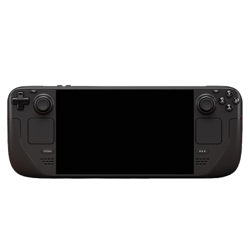

Steam Deck OLED
Steam Deck OLED
2023
PROS
  • The opening procedure is simple and straightforward, and most components are modular and repairable.
  • Standard M.2 storage is user-replaceable and upgradeable.
  • Valve offers original replacement parts and repair instructions for end users.
CONS
  • The battery is strongly glued in place, and the charge port is soldered to the motherboard.

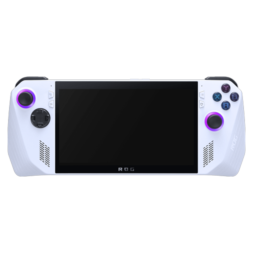

ASUS ROG Ally
ASUS ROG Ally
2023
PROS
  • The battery, display, thumbsticks, fan, and storage are modular and straightforward to replace.
  • Asus provides a good selection of repair parts and instructions.
CONS
  • The charge port and most buttons are soldered to the main board.

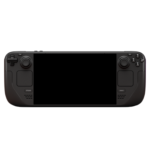

Steam Deck (LCD)
Steam Deck (LCD)
2022
PROS
CONS

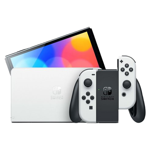

Nintendo Switch OLED
2021
PROS
  • The fan and thumbsticks are reasonably straightforward to access.
CONS
  • Strong adhesives hamper battery and display repairs, and the USB-C port is soldered to the main board.
  • Nintendo offers no repair parts or instructions.

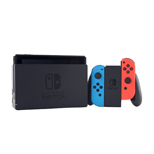

Nintendo Switch
Nintendo Switch
2017
PROS
  • Many components are modular and replaceable: fan, digitizer, joysticks, game card reader, storage, etc.
CONS
  • The battery and display are glued down, and the USB-C port is soldered to the main board.

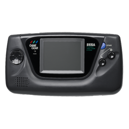

Sega Game Gear
Sega Game Gear
1991
PROS
  • It’s really cool!
  • Standard AA batteries are quick to replace, even if the short runtime means frequent changes.
CONS
  • The screen and most buttons are integrated with the mainboard, but the barrel jack is replaceable.
  • SEGA never offered official repair parts or instructions.
