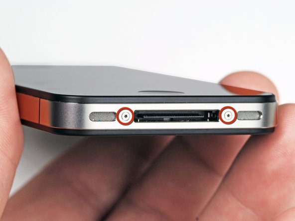

  • Fits the tiny 5-point pentalobe screws found on the bottom of the iPhone 4, 4S, 5, 5s, 5c, 6, and 6 Plus.
