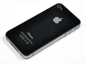

Image 1/3: Sticking with last year's rectangular design, the 4S looks very much like the [guide|4693|iPhone 4] and sports the same stainless steel bezels around its perimeter. Image 2/3: Apple has supposedly fixed the antenna issue that emerged immediately following the release of the iPhone 4. Does this mean we won't be receiving a [http://www.engadget.com/2010/07/16/apple-to-give-away-free-bumpers-to-iphone-4-users/|free case] this year? Bummer! Image 3/3: The SIM slot is [guide|4693|back!|stepid=21237] Since the iPhone 4S is a world phone, it will support both GSM and CDMA networks. Regardless of your carrier, you can be sure that the micro-SIM slot will be there to accept your GSM micro-SIM cards, as well as any CDMA "[http://www.macworld.com/article/162960/2011/10/how_international_is_the_iphone_4s_world_phone_.html|roaming SIM]."
  • We finally have the much-anticipated iPhone 4S in our hands, and it sure is looking mighty fine!
  • Sticking with last year's rectangular design, the 4S looks very much like the iPhone 4 and sports the same stainless steel bezels around its perimeter.
    • Apple has supposedly fixed the antenna issue that emerged immediately following the release of the iPhone 4. Does this mean we won't be receiving a free case this year? Bummer!
  • The SIM slot is back! Since the iPhone 4S is a world phone, it will support both GSM and CDMA networks. Regardless of your carrier, you can be sure that the micro-SIM slot will be there to accept your GSM micro-SIM cards, as well as any CDMA "roaming SIM."
A new myth says volume buttons and mute switch on iPhone 4S are in a slighly different position, meaning current iPhone 4 cases does not fix, plus the supposedly fixed 4S antenna can not be used on the iPhone 4. Is this myth confirmed, plausibe or busted?
HQuest - Reply
They're the same as the Verizon iPhone 4, but slightly different from the AT&T iPhone 4.
Biochao -
yes, I can confirm they are different than the att GSM iphone 4. As such, the bumpers will NOT fit correctly. The case partially occludes the vibrate switch and the volume buttons on the case are not hitting centered on the iphone buttons. Drilling out the hole for the mute switch to be slightly larger fixed the problem for me. The volume buttons work well enough.

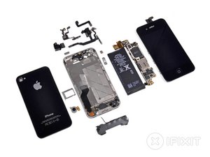

  • Pentalobe Screws, again? We were somewhat hoping there would be something new to keep us out this year, but it seems like our familiar friends have not moved far from their home at the bottom of the iPhone 4S.
  • A couple quick turns with our 5-Point Pentalobe Screwdriver and out they come! And guess what: our all-new pro driver was just released today. It comes in a great blue/black color, and it's guaranteed to be the best Pentalobe driver on the market. Hey, it's not like we haven't done this before.
  • Sorry, Siri. Despite your self-destruction threat, we will not be deterred. Let's see what you're hiding.

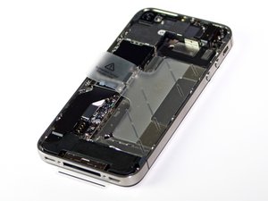

Image 1/1: "I must implore you not to go any further, iFixit. You do not have proper authorization," Siri firmly asserts.
  • We continue to tread largely familiar waters as we remove the back cover, the same way we did with the iPhone 4, and reveal the battery along with a mess of padded EMI shields.
  • "I must implore you not to go any further, iFixit. You do not have proper authorization," Siri firmly asserts.
  • Unfortunately, we have to stop here since the tag says "Authorized Service Provider Only."
  • Sike! That silly tag hasn't stopped us before, and today is no different.

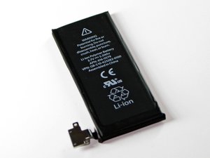

  • We finally get our first good look at the 4S's highly-acclaimed battery.
  • Look closely... closer... there it is: an extra .05 WHrs in the battery over the iPhone 4!
    • You probably want to know if you can use this battery in your iPhone 4. Sadly, it appears that the connectors are different shapes, so we'd have to say that it's not likely.
  • The iPhone 4S boasts a continuous talk time of 8 hrs on 3G, up to 14 hrs on 2G (GSM network) and up to 200 hrs on standby.
    • Comparing these times to those of the iPhone 4, the iPhone 4S offers an extra hour of talk time on the 3G network, the same amount of talk time on the 2G network, and 100 hours less standby time.
    • Taking into account the upgrade in hardware that comes with the 4S, though, the power consumption seems rather efficient.

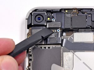

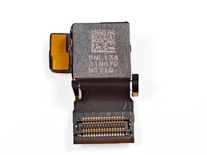

Image 1/3: The iPhone 4S turns up the heat with its new 8 megapixel camera. Image 2/3: [http://www.ifixit.com/blog/blog/2011/10/14/iphone-4s-camera-made-by-sony/|We learned from Chipworks] that the camera is made by Sony! Image 3/3: 8 MP is great and all, but as we all know, it's not just about the tools; it's about how you use them. The iPhone 4S knows how to use every last one of those pixels.

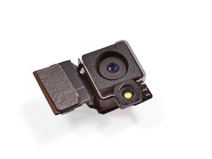

  • A quick flick with our spudger disconnects the rear-facing camera.
  • The iPhone 4S turns up the heat with its new 8 megapixel camera.
  • 8 MP is great and all, but as we all know, it's not just about the tools; it's about how you use them. The iPhone 4S knows how to use every last one of those pixels.
    • Apple boasts 73% more light with "next-generation backside illumination" for better low-light performance. Want pictures fast? This camera is roughly 33% faster and can snap multiple photos less than a second apart.
  • Still pictures not your thing? How about HD video at 1080p and 30 fps?
is the rear facing camera the Omnivision sensor or the Sony one? Looks like the OVTI one.
Chris - Reply
A lot of people are asking, will this plug up to an Iphone 4, and will the Iphone 4 hardware support 8mp picture taking?
hectordtruong - Reply

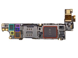

  • We had to use our teeth, but we finally managed to rip the EMI shields off. The logic board now bares its soul:
    • Apple A5 Dual-core Processor (more on this later)
    • Qualcomm RTR8605 Multi-band/mode RF Transceiver. Chipworks has provided us with a die photo.
    • Skyworks 77464-20 Load-Insensitive Power Amplifier (LIPA®) module developed for WCDMA applications
    • Avago ACPM-7181 Power Amplifier
    • TriQuint TQM9M9030 surface acoustic wave (SAW) filter
    • TriQuint TQM666052 PA-Duplexer Module
Anyone know what the Audio Chip is?
sanduneboi - Reply
are you sure both triquint chips are power amps/ some are saying one is just a filter??
ski3938 -
Are there any changes to the GPS chip in the iPhone 4S compared to iPhone 4? I noticed in the iPad 2 tear down you labeled it's GPS chip as a "monolithic". Is that monolithic vs. assisted GPS?
Jim Termini - Reply

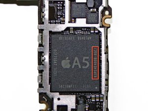

Image 1/3: How do we know it's 512 MB? Check out the marking, specifically '''E4E4''', denoting two 2 Gb LPDDR2 die—for a total of 4 Gb—or 512 MB. Thanks, [http://www.anandtech.com/show/4964/ifixit-iphone-4s-teardown-confirms-512mb-lpddr2-mdm6600|Anandtech]! Image 2/3: Oh hey, what's this? According to Chipworks, our German iPhone (marked in red) has Samsung DDR2 RAM, while the Aussie iPhone 4S (yellow) contains Elpida DDR2 RAM! Image 3/3: If Siri has an address, this is it. Though iCloud integration can be used with any iOS 5 device, Siri only works with the dual-core-equipped iPhone 4S.
  • How 'bout a close-up of that Apple A5 chip? 1 GHz Dual-core processor with 512 MB of DDR2 RAM... Yowza.
    • How do we know it's 512 MB? Check out the marking, specifically E4E4, denoting two 2 Gb LPDDR2 die—for a total of 4 Gb—or 512 MB. Thanks, Anandtech!
    • Oh hey, what's this? According to Chipworks, our German iPhone (marked in red) has Samsung DDR2 RAM, while the Aussie iPhone 4S (yellow) contains Elpida DDR2 RAM!
  • If Siri has an address, this is it. Though iCloud integration can be used with any iOS 5 device, Siri only works with the dual-core-equipped iPhone 4S.
    • Come on out, Siri. We don't wanna hurt ya. We just wanna talk.
  • Chipworks was cool enough to provide us with a die photo of the A5 processor.
The iPhone 4S's A5 is clocked at 800 MHz.
Aerocowboy - Reply
Even if Apple has limited the chip's performance, the A5 is still a 1 GHz processor.
David Hodson -
Since iPad 2 it is known that:
- Apple PN 339S0130 means DDR2 dies are from Samsung
- Apple PN 339S0137 means DDR2 dies are from Elpida
Apple PN is on A5 package
Dimitar - Reply

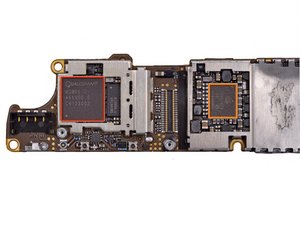

Image 1/2: Qualcomm [http://www.qualcomm.com/products-services/chipsets/mobile-data|MDM6610] chipset (an upgrade from the [guide|4693|iPhone 4's MDM6600|stepid=21254]) Image 2/2: Apple 338S0973, which appears to be a power management IC, according to Chipworks.
  • Let's see what's on the other side. Siri, roll over... Thank you.
    • Qualcomm MDM6610 chipset (an upgrade from the iPhone 4's MDM6600)
    • Apple 338S0973, which appears to be a power management IC, according to Chipworks.
    • Reading the covered chip at an angle reveals "PM8028," which is a Qualcomm power management IC.
Audio chip is still Cirrus Logic as you can tell by Apple 338S0973 chip that ChipWorks thinks is a Power IC. Its not ..its the Codec.
Midas Capital - Reply

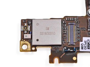

Image 1/2: We suspect that this contains the Broadcom chip that reportedly provides Wi-Fi/Bluetooth connectivity, just like in [guide|4693|teardowns past|stepid=21288]. Image 2/2: One more EMI shield comes off and we find another goodie:
  • Murata SW SS1830010.
    • We suspect that this contains the Broadcom chip that reportedly provides Wi-Fi/Bluetooth connectivity, just like in teardowns past.

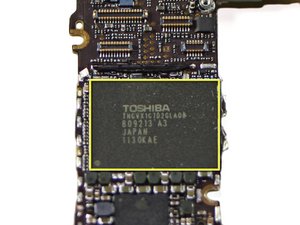

  • One more EMI shield comes off and we find another goodie:
    • Toshiba THGVX1G7D2GLA08 16 GB 24 nm MLC NAND flash memory.

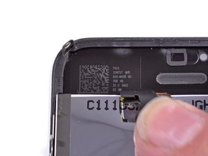

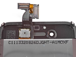

Image 1/2: Crikey! We've provoked the flex ribbon cable connectors! Stand back! They seem to be guarding the markings C1113320826DJGHT-A1MOXF... possibly the code for unlocking the pixie dust vault? Image 2/2: Crikey! We've provoked the flex ribbon cable connectors! Stand back! They seem to be guarding the markings C1113320826DJGHT-A1MOXF... possibly the code for unlocking the pixie dust vault?
  • Cryptic markings under the display cable read FA11 110717 4M0 816-0420 05 768 46 37.9 1032 GZ MB, or more commonly known as "Attack at dawn from the north."
  • Crikey! We've provoked the flex ribbon cable connectors! Stand back! They seem to be guarding the markings C1113320826DJGHT-A1MOXF... possibly the code for unlocking the pixie dust vault?
The barcode decodes to
FA111107174MO816-0420057684637.91032GZMB
(all on one line).
Solak Vaslovic - Reply

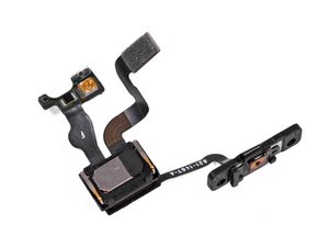

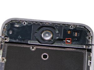

Image 1/2: Legend has it that if you press the home button from this side, your iPhone will actually be sent to the moon (we refrained from testing this theory). Image 2/2: Again, notice the white and red liquid indicator strips.
  • A peek at the underside of the home button.
  • Legend has it that if you press the home button from this side, your iPhone will actually be sent to the moon (we refrained from testing this theory).
  • Again, notice the white and red liquid indicator strips.
  • Siri, please stop staring at us like that. Come on, you knew we had to see what was inside; we're curious, ya know?
  • To get Siri to stop staring, we recruit the help of our plastic spudger to remove the second camera.

Is that true? Do we know for sure that the A5 is under clocked to 800? (yes i know about the geekbench scores, but I wasn't sure if that was a test model or a final product)

Please turn over the image sensor and let us know what it is.
robkientz - Reply
Did Apple end up going with Sony for the camera, or is it still by Omnivision?
michaelgar2000 - Reply
So, The iphone 4 screens can be used on the the iphone 4S, is that correct?
Can someone give a list of parts that are not interchangable please. so far i see:
Front Camera
Back Camera
Battery
Back Glass (markings)
any more?

Where is the GPS module? Still Broadcom chip?
