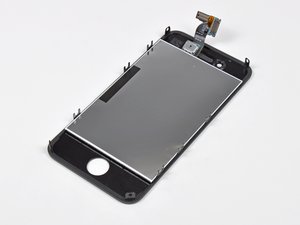

Image 1/1: The all-new iPhone 4 features upgrades from the 3GS including:
  • The world's most wanted device is now in the hands of the world's most foremost tinkerers!
  • The all-new iPhone 4 features upgrades from the 3GS including:
    • A redesigned glass & stainless steel body that shaves 3.5 mm off the width and is 3 mm thinner than the 3GS.
    • Choice of black or white coloring
    • Retina display featuring four times the pixel density of the 3GS
    • iOS 4 for multi-tasking
    • 5 MP, 720p capturing rear-facing and VGA front-facing cameras
I'd reposition each camera to be just above the respective camera holes. But awesome teardown guys! Thanks!

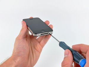

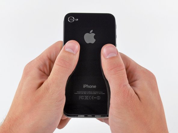

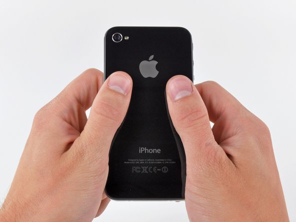

  • Like the iPhone 3G and 3GS, there are two silver Phillips #000 screws at the bottom of the phone. Note: newer iPhone 4 handsets use 5-point "pentalobe" screws instead, requiring the use of a special screwdriver.
  • In a departure from the design of the 3G and 3GS, removing the screws releases the rear case, not the front glass.
  • This design makes switching out the rear panel trivial, but unfortunately means that replacing the iPhone 4 front panel will likely be rather challenging.
That's interesting... Apple's own gallery at http://www.apple.com/iPhone/gallery/ illustrates tiny torx screws. Maybe they still had a few leftover 00 Philips? :)
Mike Hopkins - Reply
Erm, not sure why that P in the URL got capitalised. It should be lowercase, else you'll get a 404. I'd edit my note, but I can't see how to... and I missed a second l in Phillips... whoops!
Mike Hopkins -
yeah, I also remember torxs' from Apple gallery...weird ;)
grze -
In Apple's gallery pictures, the phone has five-pointed Torx-like screws visible. Nice that they went with something a bit more standard on the production model.
Frank - Reply
I hope the screen is more durable during a drop (unlike everyone who says the previous iPhones bevels save the screen during a fall) or else the screen will be even more of a pain to fix.
Matthew McQuinn - Reply

The one that I bought in Japan had some weird 5-pointed screws instead of Phillips ones. That's annoying. They're not quite Torx and not quite Phillips.
Drew Hamilton - Reply
As of September the iPhone 4 come installed with 2 5 point security torx screws.
leftyedwards - Reply
Star-shaped torx + screw driver tool tools for iphone 4
http://cgi.ebay.com/Star-shaped-torx-scr...

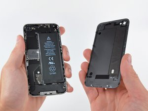

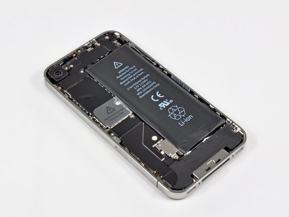

Image 1/3: Holy battery! The inside of this thing is dominated by its juice-provider. Image 2/3: It's pretty apparent that real estate was very limited inside the iPhone 4's 115.2 x 58.6 x 9.3 mm footprint. Image 3/3: You can also see pressure contact on the inner face of the rear panel for what appears to be an antenna.

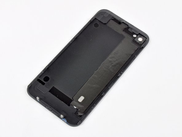

  • Removing rear panel gives us a pretty good look at the iPhone 4's innards.
  • Holy battery! The inside of this thing is dominated by its juice-provider.
  • It's pretty apparent that real estate was very limited inside the iPhone 4's 115.2 x 58.6 x 9.3 mm footprint.
  • You can also see pressure contact on the inner face of the rear panel for what appears to be an antenna.
Could it really be? Just a little bit of user-serviceability?
Chris Green - Reply
Interesting that the back panel and battery are so easily removed. I'd love to see a third party make some back panels for something like conductive charging similar to the palm pre, or make a smaller sized battery to add some space in there to stuff some interesting little hacks. Maybe like a car remote or RFID stuff.
Francis Real - Reply
Is this really an antenna on the backside?
stonesapple - Reply
whats the contact and coating on the right side of the back (above the logic center) for?
Brennan Sheremeto - Reply
Since it is in the shape of the logic board it looks like it may be an EMI shield, but it may also be an antenna (we're not 100% sure on what it is).
Andrew Bookholt -
If it is shielding, then the conductive spot is connected to ground (battery, or case). If it is an antenna, then it is connected to an inductors pin.
Some Chinese-sourced backplates completely ignore this design detail and no one has complained about diminished functionality. However, if the shield is not on place, the FCC might say something for radiation pollution.
Roberto Guerra -
There's a tiny blue thingemabob on the bottom rim of the backcover, is this a warrenty seal?
deetex - Reply

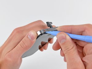

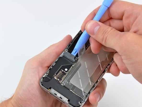

Image 1/2: The 3.7V 1420 mAh Li-Polymer battery allows for up to 7 hours of talk time on 3G or up to 14 hours on 2G. Image 2/2: The battery connector is different than the one in the 3G and 3GS. Fortunately, the battery is not soldered to the logic board. This will make battery replacement on the iPhone 4 fairly easy to accomplish.
  • Luckily, the battery can be easily removed once the back panel assembly is out of the way.
  • The 3.7V 1420 mAh Li-Polymer battery allows for up to 7 hours of talk time on 3G or up to 14 hours on 2G.
  • The battery connector is different than the one in the 3G and 3GS. Fortunately, the battery is not soldered to the logic board. This will make battery replacement on the iPhone 4 fairly easy to accomplish.
  • The plastic pull tab for the battery says "Authorized Service Provider Only."
on the first picture of step 6. On the right hand, there is a piece : where it come from ? Where is it's place ?
thanks yous for your answer
jpoincheval - Reply
It is a pressure contact that touches the rear panel, and its correct position can be seen in the third picture on this step.
Andrew Bookholt -
The battery is glued into place and needs to be pried away, which will often deform the battery. So long as you do not puncture the casing, it should be ok to flatten it back into shape and reinsert it into the system. If you puncture the casing, you should get a new battery or risk excessive heat and possibly a risk of explosion.
How did you manage to get the battery out so cleanly?
Fred Jackson - Reply
battery is secured with a strong adhesive. simply pulling on the pull tab may result in tearing the tab off. you may need to pry it loose instead.
Matthew Sands - Reply
What is the small piece in your hand in the first picture? I do not see that piece in my phone or in any of the pevious pictures.

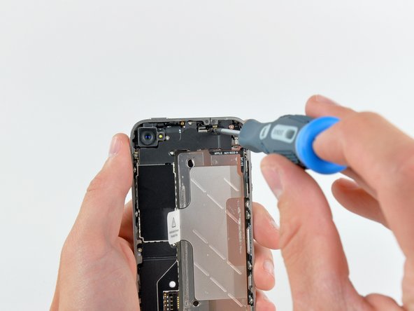

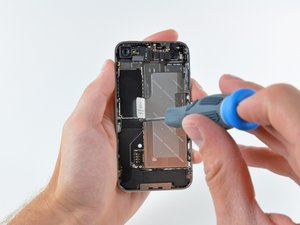

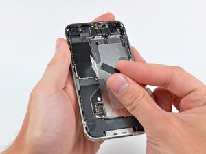

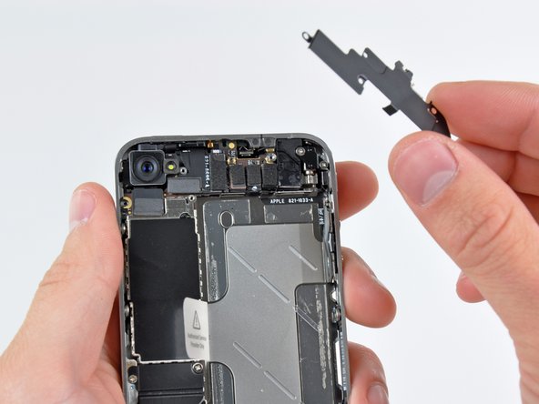

Image 1/3: The EMI shield comes off after five screws are removed to reveal lots of important connectors. Image 2/3: Upon further inspection, it looks like the EMI shield actually acts as the Wi-Fi antenna. The long screw at the top and center grounds the antenna. Image 3/3: Upon further inspection, it looks like the EMI shield actually acts as the Wi-Fi antenna. The long screw at the top and center grounds the antenna.
  • No EMI shield will stand between us and the innards of this iPhone 4!
  • The EMI shield comes off after five screws are removed to reveal lots of important connectors.
  • Upon further inspection, it looks like the EMI shield actually acts as the Wi-Fi antenna. The long screw at the top and center grounds the antenna.
Sorry to ruin the magic, but that "EMI shield" is actually the Wi-Fi antenna. The phone antenna is in the speaker enclosure removed in Step 12. The steel frame acts as a ground plane, not actually as a radiating antenna.
dfskjfksa - Reply
If thats the antenna no wonder they have problems!! (It's not)
stonesapple -
I see five screw holes in the shield.....
gsgmac - Reply

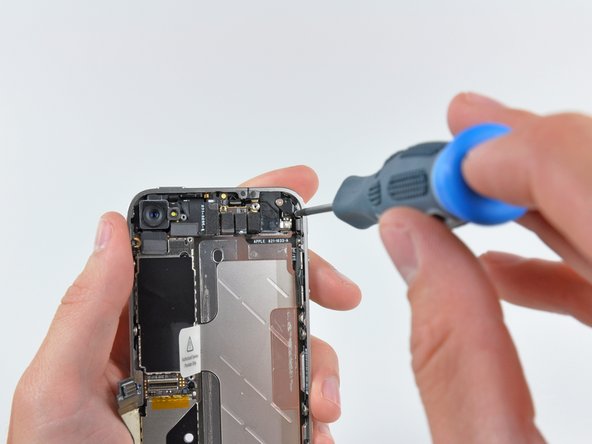

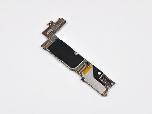

Image 1/3: While we're not too busy, let's talk RAM. Unlike the iPhone 3GS and iPad, which are both equipped with 256 MB, the iPhone 4 has a whopping 512 MB! Image 2/3: The increase in RAM allows for a larger amount of cached data allowing for a smoother and faster user experience. Image 3/3: The increase in RAM allows for a larger amount of cached data allowing for a smoother and faster user experience.
  • The logic board is heavily embedded under wires and EMI shields.
  • While we're not too busy, let's talk RAM. Unlike the iPhone 3GS and iPad, which are both equipped with 256 MB, the iPhone 4 has a whopping 512 MB!
  • The increase in RAM allows for a larger amount of cached data allowing for a smoother and faster user experience.
Now that the 32GB iPhone 4 is confirmed to have a 512MB RAM,
will the 16GB iPhone 4 have the same amount of RAM?
or less?
VPster - Reply
of course the same
grze -
Is there an app that can tell how much memory a phone has?
VPster -
Never mind, I figured it out. The app is called Checkup.
VPster -
small screw on left, big on right (connector on bottom)
Joe Smith - Reply
yes that would be no different, check here: Harga Hp Iphone http://goo.gl/QljTeF
irwansyah10 - Reply

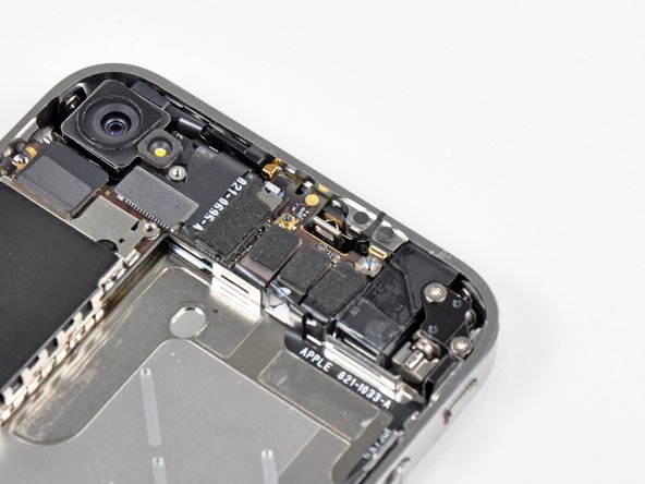

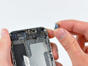

Image 1/3: Image 2/3: Image 3/3:

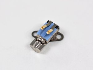

  • Hiding in the corner is the iPhone 4's vibrator motor, which...well...vibrates.
thats not an accelerometer, thats the motor and weight for vibration, accelerometers are microchips and have no moving parts
Walker Quine - Reply
That's not a Gyroscope it is the Vibrator
Jeremie - Reply
That looks like the vibrator, not a gyro.
cigumo - Reply
This vibrator is made by MIM (Metal Injection Molding)technology.
It's said that the metal frame of iPhone is also made by this technology, hence its strenghth is 5 times than normal steel.
Frank W - Reply
Long screw left side, short screw right side
Joe Smith - Reply
I have to take my Iphone appart because this little fella here don't work until I smack the phone against my palm. Maybe the connecting points don't all touch... Thanks for this!
Ivanoinks - Reply
Repairing an iPhone 4, but I don't have that screw as displayed in the photo. As a matter of fact the inside doesn't look the same. Also, the phone I am repairing does not have the SIM card on the side either. Am I missing something? I double checked. This is an iPhone 4...
Manny - Reply
You have a CDMA iPhone 4 which does not have a SIM card. Use this teardown instead: iPhone 4 Verizon Teardown
Scott Head -

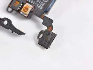

Image 1/1: In our brief usage, we did notice that the phone is considerably warmer on the right side. This makes sense, as the logic board is located entirely along the right side of the phone.
  • Removing one of the many connectors on the logic board.
  • In our brief usage, we did notice that the phone is considerably warmer on the right side. This makes sense, as the logic board is located entirely along the right side of the phone.

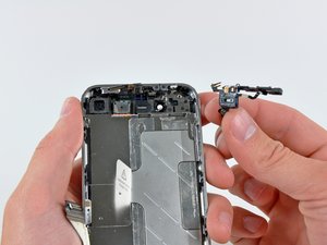

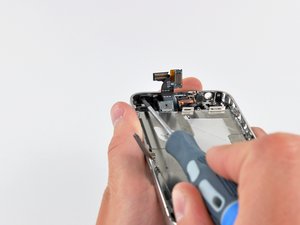

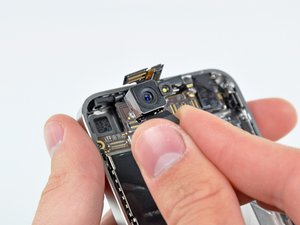

Image 1/2: This is a huge upgrade from the 3.2 MP camera found in the iPhone 3GS. Image 2/2: This is a huge upgrade from the 3.2 MP camera found in the iPhone 3GS.
  • Behold a beauty in the iPhone 4: a rear-facing 5 MP camera with 720p video at 30 FPS, tap to focus feature, and LED flash.
  • This is a huge upgrade from the 3.2 MP camera found in the iPhone 3GS.
Looks like it's not a Philips Lumileds Luxeon LED like the rumor were stating after all. It's still yellow and this article says it should not be yellow: http://www.ledsmagazine.com/news/5/10/38
That's really too bad.
Nikolas Kong - Reply
Doesn't 720p mean 1280x720@60FPS?
nuts32605 - Reply
Apple doesn't seem to think so.
"Video recording, HD (720p) up to 30 frames per second with audio"
Andrew Bookholt -
Is the iPhone's 4 Camera able to replace the iPhone 3Gs Camera? eg is it the same size etc...
Kristyanna - Reply
Actually, the iPhone 3GS had a 3 megapixel camera. It says so on apple's website: http://www.apple.com/iphone/iphone-3gs/
Flaming Llama - Reply
I say apple should stop trying to mack the Ipod so thin and put a 5MP or higher camra inside the Ipod touch 5g and put a better sounding speaker in it to I also say they should mack the screen a 4.5 inch display
brad - Reply

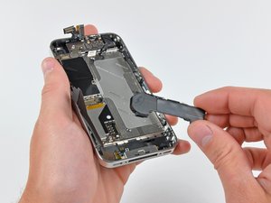

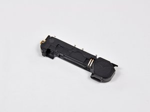

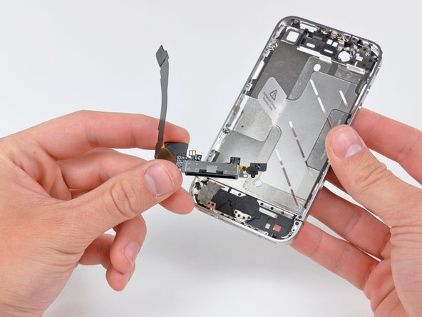

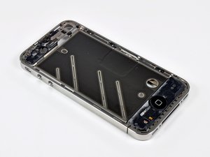

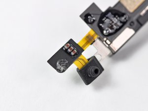

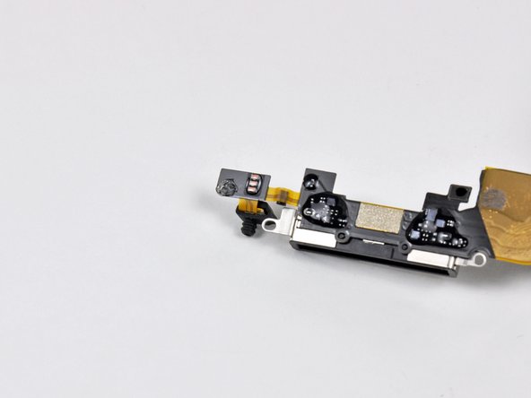

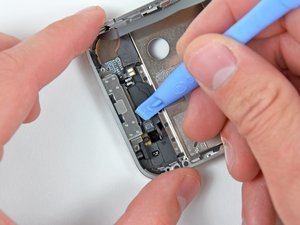

Image 1/3: The improved audio chamber aids in clarifying sounds leaving the iPhone, including calls via speakerphone as well as music played through the speaker inside this housing. Image 2/3: Apple hasn't made taking the iPhone 4 apart very hard so far: no 5-point Torx bits or fragile clips to be seen. Image 3/3: Apple hasn't made taking the iPhone 4 apart very hard so far: no 5-point Torx bits or fragile clips to be seen.
  • Removing the lower antenna/speaker enclosure from the bottom of the phone.
  • The improved audio chamber aids in clarifying sounds leaving the iPhone, including calls via speakerphone as well as music played through the speaker inside this housing.
  • Apple hasn't made taking the iPhone 4 apart very hard so far: no 5-point Torx bits or fragile clips to be seen.

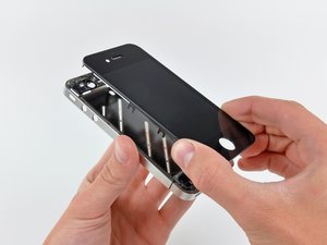

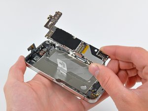

Image 1/3: The unusual shape and small size of the logic board shows just how costly real estate is inside this powerhouse of a phone. Image 2/3: The unusual shape and small size of the logic board shows just how costly real estate is inside this powerhouse of a phone. Image 3/3: The unusual shape and small size of the logic board shows just how costly real estate is inside this powerhouse of a phone.
  • Removing the logic board.
  • The unusual shape and small size of the logic board shows just how costly real estate is inside this powerhouse of a phone.

Image 1/2: You can also see the ambient light sensor and the proximity sensor which are mounted right above the earpiece. Image 2/2: You can also see the ambient light sensor and the proximity sensor which are mounted right above the earpiece.
  • Up next we find the second microphone, which is used to cut out ambient noise and improve sound quality when talking on the phone.
  • You can also see the ambient light sensor and the proximity sensor which are mounted right above the earpiece.
Image 1/1: While the 5 megapixel camera on the rear of the iPhone 4 is ideal for video recording, the smaller camera on the front optimizes use of Apple's [http://www.apple.com/iphone/features/facetime.html|FaceTime] for mobile-to-mobile video calls.
  • The front-facing VGA camera.
  • While the 5 megapixel camera on the rear of the iPhone 4 is ideal for video recording, the smaller camera on the front optimizes use of Apple's FaceTime for mobile-to-mobile video calls.
That oval copper thing in the center looks like a low-frequency inductor-type antenna. It has two spring leads that contact the back of the circuit board. Could this be used for near field communications/RFID?
morcheeba - Reply
oh wait, no way... that looks like a real speaker :-) false alarm!

Image 1/3: The stainless steel body left behind is quite a marvel of gadget engineering. Image 2/3: The stainless steel body left behind is quite a marvel of gadget engineering. Image 3/3: The stainless steel body left behind is quite a marvel of gadget engineering.
  • The front panel comes off without too much additional trouble.
  • The stainless steel body left behind is quite a marvel of gadget engineering.
Image 1/3: Gorilla Glass holds many [http://www.corning.com/uploadedFiles/Corporate/Gorilla_Glass/Assets/Video/Gorilla%20Glass_300k.wmv|advantages] as the iPhone 4's front panel, including its high resistance to wear and increased strength from an ion-exchange chemical strengthening process. Image 2/3: LED Backlight for the LCD. Image 3/3: Unfortunately, the LCD panel is very securely glued to the glass and digitizer, with the entire assembly measuring 3.05mm thick. It appears that if you break the glass, you'll have to [guide|3148|replace] the iPhone 4's glass, digitizer, and LCD as a single assembly.
  • The front glass panel of the iPhone is reported to be constructed of Corning Gorilla Glass, a chemically strengthened alkali-aluminosilicate thin sheet glass that is reported to be 20 times stiffer and 30 times harder than plastic.
  • Gorilla Glass holds many advantages as the iPhone 4's front panel, including its high resistance to wear and increased strength from an ion-exchange chemical strengthening process.
  • LED Backlight for the LCD.
  • Unfortunately, the LCD panel is very securely glued to the glass and digitizer, with the entire assembly measuring 3.05mm thick. It appears that if you break the glass, you'll have to replace the iPhone 4's glass, digitizer, and LCD as a single assembly.
I don't know why my comment disappeared, anyway, can you tell anything about that glass, is it the same that was used on 3g(s) or better?
grze - Reply
Front glass is Gorilla, but what about the back? I can't imagine it would be different, but I didn't see it mentioned.
John Whitworth - Reply
Is it not possible to separate the digitizer from the LCD from the backlight from the glass?
Ankit - Reply
How do you know that it is Gorilla Glass if Corning does not publicly release which devices are equipped with their glass? Additionally, the product information for the iPhone 4 calls it aluminosilicate glass, but it does not say that it is alkali-aluminosilicate. As you know, there are many applications of aluminosilicate glass other than alkali, including boron-aluminosilicate glass.
soopermodel12 - Reply
The bonded display/digitizer will prevent dust from becoming visible underneath the glass--a problem that plagues middle models of the iPhone (the original iPhone had a bonded display and no dust!)
Randy - Reply
I'm hoping that the LCD being bonded to the glass will prevent dust from entering the display. All I know is that my original iPhone display is still beautiful and dust free, but my 3GS had dust between the glass and LCD within I week.
Russell Boyer - Reply
Hmm. I came here to try to figure out what the mysterious extra window is which appears in photos of the white iPhone 4, above the "receiver" ear slot. I think it's for a light sensor, and I assumed that it was also there on the black model, but just not visible because of the black surround.
http://www.engadget.com/2010/06/23/apple...
I think I can see it on my phone by using an LED flashlight to provide lots of illumination, but I'm not sure, and it doesn't seem to be there from the back in these photos.
Any ideas?
Rick DeNatale - Reply
I believe I read that it is a contact sensor of sorts that detects when the phone is held up to your head (to turn off the display and prevent false presses on the touch screen).
cityzen -

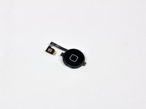

Image 1/2: Image 2/2:
  • Surprisingly, the electronic home button switch is attached directly to the home button itself.
"Surprisingly, the electronic home button switch is attached directly to the home button itself."
That would make it, the home button, very easy to replace in the event of failure; rather than having to change something on the logic board.
ahothabeth - Reply
Let's hope the home button won't wear of due to excessive use of fast app switching.
Omer Aloni - Reply
Response to lint blocking the old switch?
kolleykibber - Reply
Why does the Homebutton have 4pin conection? Its only One switch.
And what are this smd Parts 6 resistores? And two diodes? Can you Plz make a shematic of this Parts and the values of the smd Parts thx
3gfisch - Reply
Image 1/2: The primary microphone is also found at the bottom of the phone. Image 2/2: The primary microphone is also found at the bottom of the phone.
  • The 30-pin dock connector is where we would usually expect it to be: at the bottom of the iPhone.
  • The primary microphone is also found at the bottom of the phone.
Image 1/2: Interestingly, the two microphones are positioned at the two far ends of the phone. The microphone at the top of the iPhone is most likely utilized for capturing background noise to be analyzed by internal circuitry and used to cancel any noise put into the main microphone other than the user's voice. Image 2/2: You can also see the ambient light sensor which adjusts the iPhone's brightness as lighting conditions change.
  • Apple is following in the footsteps of the Nexus One by using dual microphones to help improve audio quality and suppress background noise.
  • Interestingly, the two microphones are positioned at the two far ends of the phone. The microphone at the top of the iPhone is most likely utilized for capturing background noise to be analyzed by internal circuitry and used to cancel any noise put into the main microphone other than the user's voice.
  • You can also see the ambient light sensor which adjusts the iPhone's brightness as lighting conditions change.
  • The proximity sensor sits right next to the ambient light sensor. This will turn the display off when you bring the phone up to your ear thus preventing any touch interaction while it's pressed up against ear.
The distance between the microphones enhances noise cancellation.
Brian Epstein - Reply

  • iPhone 4 Repairability Score: 6 out of 10 (10 is easiest to repair)
    • The iPhone 4 is held together primarily with [lots of] screws, sans tabs, and limited adhesive.
    • The rear panel and battery are both easy to remove and replace (provided you have the right kit and/or correct screwdriver).
    • Apple is using Pentalobe screws to secure the rear panel and keep people out.
    • The LCD and glass are fused together, making repairing a cracked front panel more costly.
    • During disassembly, your finger oils interfere with the iPhone 4's RF grounding contact points, so we recommend you wear gloves while performing any repairs.
