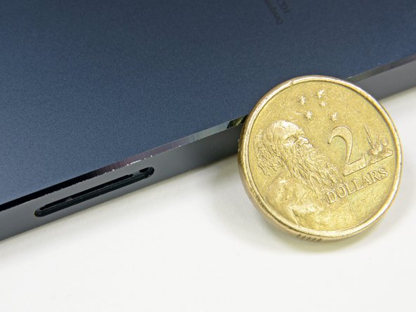

There won't be any mistaking an iPhone 5 for an iPhone 4 or 4S. A lot has changed on the outside of the iPhone.
  • There won't be any mistaking an iPhone 5 for an iPhone 4 or 4S. A lot has changed on the outside of the iPhone.
  • The most obvious alteration to the bottom of the phone is the exchange of the large 30-pin dock connector for the diminutive Lightning connector.
  • The headphone jack is now on the bottom of the iPhone, right next to the updated speaker microphone grille—a series of holes rather than a mesh-covered slot.
  • Other notable differences are the slate bezel, as opposed to the stainless steel that wrapped around the 4S, and the chamfered edges between the bezel and the front/rear cases.
  • Pesky pentalobe screws! Good thing our 5-Point Drivers still work on them.
    • It's incredibly convenient that Apple used the same pentalobe screwhead that they've been using for the past two years on the iPhone 4 and 4S. The screw shafts are slightly different from the screws in our iPhone 4/4S Liberation Kit, so we made a new iPhone 5 Liberation Kit!
  • The unibody back case is reminiscent of the iPhone 3GS, while still retaining the square (though now chamfered) edges of the iPhone 4.

Based on a user request, we looked into the concerns about "Scuff Gate," the fear that the black coating scuffs off too easily. We found that the side is pretty tough, but the chamfered edge can be susceptible to scuffing, making for a shiny streak on the side.
  • Based on a user request, we looked into the concerns about "Scuff Gate," the fear that the black coating scuffs off too easily.
  • We found that the side is pretty tough, but the chamfered edge can be susceptible to scuffing, making for a shiny streak on the side.
  • Moral of this story: be careful, or get a case. Or be free like the wind and just don't care.
