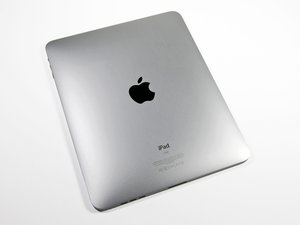

Image 1/3: The significantly improved 9.7 inch  LED-backlit glossy widescreen with Multi-touch is perfect for all your movie watching, e-book reading needs. Image 2/3: The iPad's model number is A1219, which doesn't mean much. But the 3G iPad is [http://en.wikipedia.org/wiki/Leet|A1337], which is rather geeky, even for Apple. Image 3/3: Yes, we did turn it on—how could we not? But then we turned it right back off and started figuring out how to pry this beautiful machine apart.
  • The iPad measures in at 242.8 x 189.7 x 13.4 mm and weighs in at 1.5 lbs.
  • The significantly improved 9.7 inch LED-backlit glossy widescreen with Multi-touch is perfect for all your movie watching, e-book reading needs.
  • The iPad's model number is A1219, which doesn't mean much. But the 3G iPad is A1337, which is rather geeky, even for Apple.
  • Yes, we did turn it on—how could we not? But then we turned it right back off and started figuring out how to pry this beautiful machine apart.

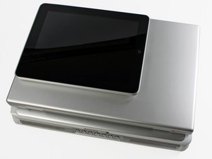

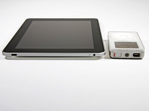

Image 1/3: More like: Flying saucer, meet horse & buggy. Image 2/3: The iPad stacked upon a MacBook Pro, stacked upon a Dell laptop. Image 3/3: The iPad stacked upon a MacBook Pro, stacked upon a Dell laptop.
  • iPad, meet iPod original.
    • More like: Flying saucer, meet horse & buggy.
  • The iPad stacked upon a MacBook Pro, stacked upon a Dell laptop.

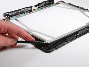

  • Insert a metal spudger between the display and the rear case to pry the iPad open.

Is the fron panel easy to remove?
Nicholas Ouimet - Reply
Ohhh!!! its very easy to pry?
zuaqto - Reply
Quote from ouimetnick:
It seems not. In fact the black rubber seal of the edge of the screen has some scratches.
Cristian Flores - Reply

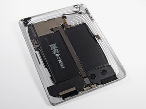

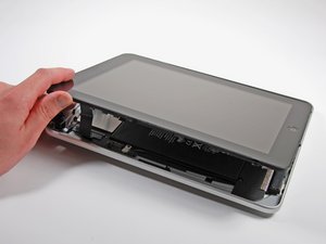

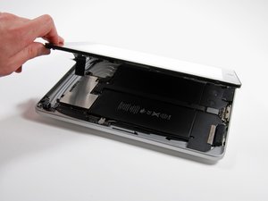

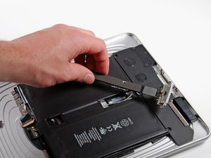

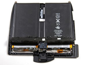

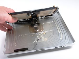

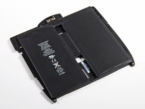

Image 1/2: A first peek under the hood reveals two huge Li-ion Polymer batteries taking up most of the space in this device. Image 2/2: A first peek under the hood reveals two huge Li-ion Polymer batteries taking up most of the space in this device.

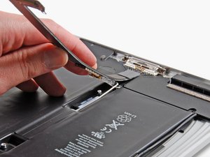

  • Lift the display assembly away from the rear case.
  • A first peek under the hood reveals two huge Li-ion Polymer batteries taking up most of the space in this device.
looks sorta similar to taking apart an iPod touch, just a lot bigger.. that about right, or are the clips somehow fundamentally different than the Touch's?
iTronics Repair - Reply

I broke most of my clips taking it apart. Are these clips for sale? It seems the only way to take it apart is to break the clips, then replace them before putting it back together
They seem like they'd be easy enough to replace with some bent pieces of plastic with a hole made in them. Perhaps the plastic from a DVD case might do the job.

Yeah I found a metal shop that will make them exact for me, $20 each, or $4 each if I buy 100. So i'll be checking out Home Depot to see what i can rig together.

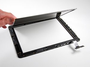

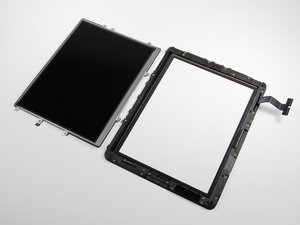

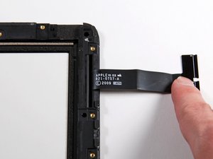

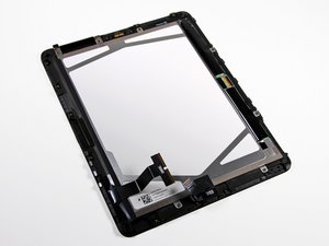

Image 1/1: Words from the wise: You might break some tabs getting the display assembly off.
  • Aaaand it's off. You have no idea how glad we are that this didn't require a heat gun.
  • Words from the wise: You might break some tabs getting the display assembly off.
Are those tabs metal?
How easily they bend?
So the trick is to take off the front without breaking the tabs. We're awaiting the solution. :D
PS Thanks for going through this process for us. Seems something like the bomb-disposal squad. ("What's that noise?...*kaboom*)
barryjaylevine - Reply

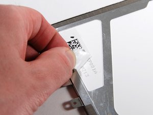

The iPad does feature liquid damage indicators. Apple will deny warranty coverage if these are activated (they turn pink after coming in contact with moisture). There appear to be two of these on the iPad, one in the headphone jack and one near the dock connector.

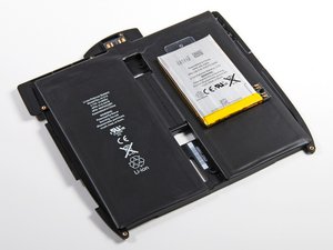

> The iPad battery is a lot bigger than an iPhone 3G battery.
In "size" or "capacity"? (Please don't just say "bigger".)
Tammy T - Reply
Quote from Tammy T:
they said that they take the whole space, so yeah, it's bigger in size!
ygreq - Reply

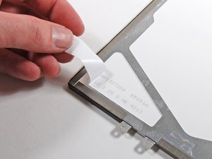

Image 1/2: The display assembly and rear case assembly are each 350g. Talk about 50/50 weight distribution. Image 2/2: The empty void in the upper right corner is where the cellular communications board will go in the [http://s1.guide-images.ifixit.com/igi/mVQCgcERMeRALsU6.large|3G iPad].
  • Wow, what gorgeous symmetry.
  • The display assembly and rear case assembly are each 350g. Talk about 50/50 weight distribution.
  • The empty void in the upper right corner is where the cellular communications board will go in the 3G iPad.

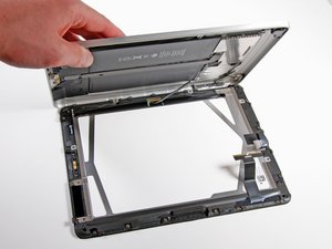

Image 1/2: It looks pretty barren, mostly because all the 3G equipment is missing. Image 2/2: The 3.75V, 24.8 watt-hour battery provides the juice for an advertised 10 hours of use. In contrast, the iPhone 3GS has a 4.51 watt-hour battery and the MacBook Air has a 40 watt-hour battery.
  • The display has a marking referencing Honeywell patent #5280371.
  • It looks pretty barren, mostly because all the 3G equipment is missing.
  • The 3.75V, 24.8 watt-hour battery provides the juice for an advertised 10 hours of use. In contrast, the iPhone 3GS has a 4.51 watt-hour battery and the MacBook Air has a 40 watt-hour battery.
  • The USB power supply had to be enhanced specifically for the iPad. It's a 10W unit manufactured by Foxlink Technology, Ltd., part #A1357 W010A051.
The ambient light sensor and its socket to the logic board seems too huge to me. I presume it has enough room for an iSight signals.
Who manufactured the display?
Thomas J - Reply
Since it has it's own power supply, will it still charge when connected to a USB port on a PC(Or a Mac)?
Chris Green - Reply
Quote from Thomas J:
We don't know who manufactured the display from the unit in this teardown. If anyone knows, we'd love a tip. On another iPad we opened, the LCD markings were different and the panel was clearly manufactured by LG.
Luke Soules - Reply
Quote from Luke Soules:
The display is Made in Taiwan by Wintek co.,ltd & Sintek co.,ltd.
www.wintek.com.tw
www.sintek.com.tw
Tomas - Reply
I've just read that the panels come from either LG, Samsung or Epson and only the front galss panel with the touch sensors comes from Wintek, but no mention of Sintek.
Thomas J - Reply
LGD
Mike park - Reply

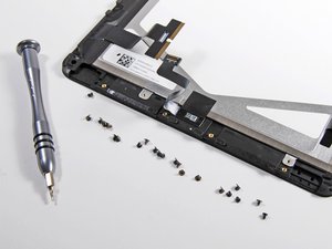

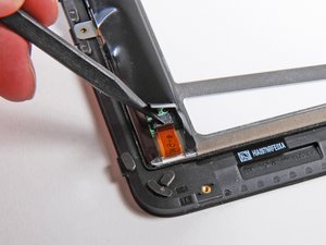

Image 1/1: Removing these connectors is a two step process. You first have to flip up the locking bar (pictured) and can then slide the cable out of the socket.
  • Disconnecting the display data cable.
  • Removing these connectors is a two step process. You first have to flip up the locking bar (pictured) and can then slide the cable out of the socket.
  • The display data cable connector is the same style used in all of the new Unibody MacBooks.
That black plastic is to help remove the bar that holds the video connector, but NOT to pull on the connector itself to unplug it - it is not anchored strongly, and I'm surprised it didn't break if you did try it!
Andy Middleton - Reply

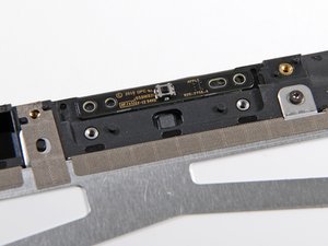

Image 1/1:
  • Disconnecting the volume, power, and screen rotation lock buttons connector.
With the new iOS 4.2 (4.2.1 if you want to get technical) changes the screen orientation lock into a mute switch (read: iPhone switch). The lock orientation switch is now in the multitasking bar (read: also like iPhone 3GS and 4).
Jeff - Reply

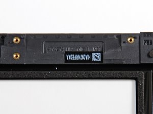

  • The main board is secured to the back panel by T4 Torx screws.
  • We have never seen Apple use screws with a bit this small before.
wow, that is small for these. the machinery gets bigger, the screws get smaller.
Is iFixit going to carry the T3? how about the glass?
Travis Funk - Reply
Quote from Travis Funk:
It appears that iPad screws may actually be T4. I used a T3 bit, but others have reported success with a T4 bit. Fortunately, we include both T3 and T4 bits in the 54-piece kit that we already sell. We don't have the iPad glass yet, but we're definitely hoping to offer it in the near future. It looks like at least one person needs a replacement glass already.
Luke Soules - Reply

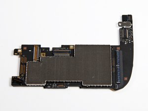

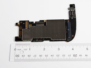

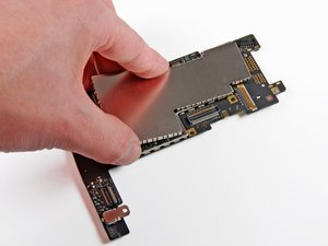

Image 1/3: It looks like this board was made by [http://www.ats.net/en/index.php/c-12743-Frontpage.html|AT&S].  We haven't seen Apple's PCB manufacturers brand their boards before. Image 2/3: The logic board is about 4.5" wide, spanning about 60% of the iPad's width. Image 3/3: The logic board is about 4.5" wide, spanning about 60% of the iPad's width.
  • Top and bottom of logic board with the EMI shield on.
  • It looks like this board was made by AT&S. We haven't seen Apple's PCB manufacturers brand their boards before.
  • The logic board is about 4.5" wide, spanning about 60% of the iPad's width.
AT&S was one of PCB suppliers of iPhone. Although they were in a small share among PCB vendors, they have good quality.
JohnnyWu - Reply
Is there any possibility to compare "side by side' the iPad Logic Board with the iPhone/iPod??? Please would be a great view!!!
Another question: Could the A4 fit at the iPhone Logic Board? What could we expect for the New iPhone 4G???
Vrumm - Reply
The marking is the board manufacturer's UL mark. You should find it on all Apple boards (all everybody's boards), although often it likely to be underneath a component.
Christopher Smith - Reply

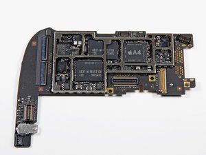

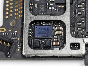

Image 1/2: This board is markedly different than the [guide|2197|pre-production board] we uncovered. Image 2/2: Markings on the A4:
  • Remove the EMI shield from the logic board, and presto!
  • This board is markedly different than the pre-production board we uncovered.
  • Markings on the A4:
    • N26CGM0T 1007 APL0398 33950084 YNL184A2 1004 K4X2G643GE
    • Yes, the K4X2 is a Samsung DRAM part number!
      • Decoding the part number shows there is 2Gb of memory inside. This translates into ~128MB of memory per die, for 256 MB total. (NOT 512MB, as we previously reported.)
    • This means the A4 processor is probably being manufactured by Samsung.
    • The DRAM was stamped at the end of January, while the processor die was likely manufactured the third week of February.
The Apple A4 has the cool markings like the marketin photo. The FCC A4 didn't have that. Sadly, it's printed in the wrong direction.
Is Apple using Sandisk iNand chips for flash memory?
Tom Stigler - Reply
Typo: APL0398 339S0084 (S, not 5)
Kris - Reply
They're 64Gbit MLC NAND flash.
In fact you can switch between brands like Toshiba, Micron, etc (We've done this before on 2G and 3G iPhone at iPhoneTECH), and it's possible to upgrade to higher density memories, i.e. 128 Gbit, 256 Gbit and possible to 512 Gbit chips, it means you may upgrade to 128 GB capacity when the memories become available. That would be terrific!
K9 = NAND memory
L = MLC DDP
CG = 64 Gbit
08 = 8x
U = 2.7V~3.6V
1 = Dual nCE & Dual R/nB
M = !st Gen.
Quote from Tom Stigler:
The A4 is likely a multi-die package, with the CPU and DRAM mounted on the same substrate. (High-speed logic and high-density memory require fabrication processes that are less-than-optimal for the other.) That would explain the multiple part numbers. Other folks have pointed out that the K4X2G643GE part number is for a 2Gb (256MB) part.
CityZ - Reply

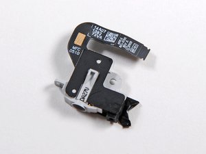

Hmm, I also can't seem to account for the small ribbon cable connector that's next to the big double-ribbon connector for the touch-screen.
CityZ - Reply
Quote from CityZ:
It's for the headphone jack, seen here.
Andrew Bookholt - Reply
Sheesh! 2 Gigabits is 512 MB? Since when is a Byte only 4 bits? It's 256 MB of RAM and that goes in line with reports from developers who had their apps rejected for memory warning crashes, which occur at a comparable RAM usage as on the iPhone 3GS.
I wrote about that here: http://www.gaminghorror.net/steffenj/app...
Steffen Itterheim - Reply
Ok we're looking at two chips here, i get it. 2 Gigabits per chip times two equals 512 MB. But why are developers seeing only the same free amount of memory as on the iPhone 3GS? Why would the iPad keep about 256 MB to itself?
Quote from Steffen Itterheim:
That's what we originally thought, but it turns out there are two 1 Gb chips, for only 256 MB total. Consistent with software reports. Sorry to get your hopes up!
Kyle Wiens - Reply
Quote from Andrew Bookholt:
Ah, thanks. I think I saw that when I examined the FCC pictures, but I failed to notice it this time around.
CityZ - Reply
Quote from Kyle Wiens:
I guess given the software reports, there's no holding out hope that the 2Gb part number refers to each individual DRAM chip inside the A4 rather than the 2 combined?
In any case, can you confirm my interpretation of Samsung's nomenclature that the "64" in K4X2G643GE refers to a 64-bit memory bus width? If that is so, that means that regardless of RAM amount, the iPad has double the memory bandwidth of the iPhone and other smartphones which Anandtech reported to have 32-bit memory buses in their Google Nexus One review. The doubled memory bandwidth would benefit not only the CPU but also the GPU which shares system memory and bandwidth.
ltcommanderdata - Reply
It seems A4 is not (yet) revolutionary product, but upgraded version of A8 based processor found in iPhone 3GS.
On FCC RAW data logic board photos of iPad it is clearly seen that the processor, not yet marked as A4 but in old, iPhone style, is manufactured during week 49 of 2009.
In addition, Apple part number of A4, APL0398, is quite similar (upgraded?) to original iPhone 3GS processor PN APL0298.
Dimitar - Reply
I was confused about the amount of memory, but the pictures on the Chipworks page cleared that up.
The number in the outside, K4X2G643GE, indicates 2 gigabits (256MB) total, 64 bits wide. The numbers on the inside, K4X1G323PE + K4X1G323PE, indicate 1 gigabit (128 MB) on each die, 32 bits wide.
Joe Smith - Reply

Image 1/2: The manufacturer of the memory has switched from Toshiba on the FCC teardown to Samsung on this device. Image 2/2: Samsung K9LCG08U1M 8 GB NAND flash.
  • A shot of the logic board minus the steel EMI shield.
  • The manufacturer of the memory has switched from Toshiba on the FCC teardown to Samsung on this device.
    • Samsung K9LCG08U1M 8 GB NAND flash.
    • We love how much easier Samsung's chip numbers are to interpret.
  • Broadcom BCM5973 I/O controller.
  • The Apple A4 is marked up much nicer than the part in the FCC photos from yesterday.
  • Texas Instruments CD3240A1 touch screen controller.
  • NXP: L061 01 4 ZSD950
The connector at the lower-left, next to the metal screw bracket, seems to be unaccounted for. What plugs in there? Is it used for testing and initial bring-up, I wonder?

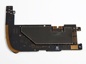

Image 1/1: The gold strip on the curved edge most likely helps ground the board against the "steps" cut into the aluminum rear case.
  • A reverse shot of the logic board.
  • The gold strip on the curved edge most likely helps ground the board against the "steps" cut into the aluminum rear case.
  • Apple part #820-2740-A.
  • The Apple-branded IC on this side of the board is labeled 338S0805.
It seems the copyright for that board is 2010. It also seems the logic board manufacture has printed their brand. Even on a production board.

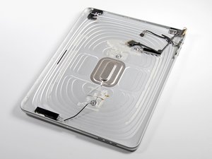

there are tow antennas one behind the apple logo and the other left down, is the other for bluetooth? but why works this and the wifi works not thru the case?
3gfisch - Reply

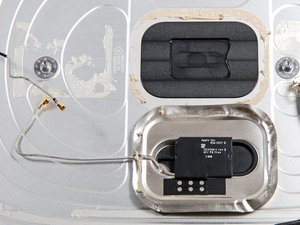

Image 1/3: Notably lacking from this RF/data cable is anything GPS related.  Check out the [guide|2197|FCC iPad teardown] to see where the GPS will be in the 3G device. Image 2/3: Notably lacking from this RF/data cable is anything GPS related.  Check out the [guide|2197|FCC iPad teardown] to see where the GPS will be in the 3G device. Image 3/3: Notably lacking from this RF/data cable is anything GPS related.  Check out the [guide|2197|FCC iPad teardown] to see where the GPS will be in the 3G device.
  • Removing the single screw securing the dock connector cable to the rear case.
  • Notably lacking from this RF/data cable is anything GPS related. Check out the FCC iPad teardown to see where the GPS will be in the 3G device.
Is there any more information on the batteries? Like, a specific manufacturer?
chrisquiet - Reply

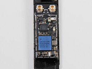

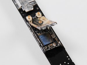

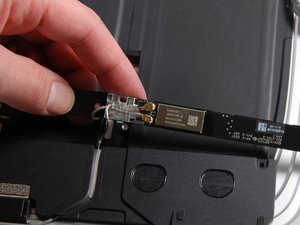

Image 1/3: Hiding under the case: Image 2/3: Broadcom [http://www.broadcom.com/products/Bluetooth/Bluetooth-RF-Silicon-and-Software-Solutions/BCM4329|BCM4329XKUBG] 802.11n WiFi + Bluetooth 2.1 + EDR and FM Image 3/3: Dont worry, the capacitor near the lower right corner of the Broadcom chip didn't come that way. The solder melted and it moved when we heated the steel casing to remove it.
  • The 802.11n WiFi/Bluetooth card is integrated into the dock connector cable.
  • Hiding under the case:
    • Broadcom BCM4329XKUBG 802.11n WiFi + Bluetooth 2.1 + EDR and FM
  • Dont worry, the capacitor near the lower right corner of the Broadcom chip didn't come that way. The solder melted and it moved when we heated the steel casing to remove it.
I wish Apple would enable FM reception, or a least broadcasting to a local (car) radio. Anyone know of an iPhone hack?
amiller770 - Reply
That 'capacitor' looks like it is more likely an SMD ferrite monolithic inductor.
Do you know if the solder is tin/lead, or some dreaded rohs high melting point solder?
TerraHertz - Reply
Quote from TerraHertz:
Edit: Ah, the answer to that is obvious from the center pic. You had to heat the metal case with a blowtorch to unsolder it. So, ROHS solder. Which cannot be resoldered without destroying parts. Sigh...
As if bismuth was any better in landfills than lead.
TerraHertz - Reply
Quote from amiller770:
There is no hardware to support FM transmission (only receive) and just because the Broadcom chip has an FM demodulator, doesn't mean that you have enough hardware to support FM reception. You need a substantial set of antenna tuning components, not to mention the antenna itself. Those pins are not broken out of the logic board so it would be near impossible to implement this mod -- even if you were willing to open your new iPad and take a soldering iron to it!
Jonathan Friedman - Reply

Image 1/3: Confirming our suspicions from yesterday, the battery integrates two separate 3.75V lithium polymer cells wired in parallel for such ample battery life. Image 2/3: Battery cell markings: Image 3/3: P11GA6-01-C01F
  • That's a hulk of a battery: it weighs 148g with the casing.
  • Confirming our suspicions from yesterday, the battery integrates two separate 3.75V lithium polymer cells wired in parallel for such ample battery life.
  • Battery cell markings:
    • P11GA6-01-C01F
    • 741-00310A +
Ah, like the new iMacs, the Wi-Fi antenna is behind the Apple logo in the bottom case.
Jim Girardi - Reply
"Confirming our suspicions from yesterday, the battery integrates two separate 3.75V lithium polymer cells wired in parallel for such ample battery life."
On the battery itself it states "Li-ion".
ivc - Reply
Quote from ivc:
As stated on the black cover, it is a lithium-ion polymer battery.
Image 1/3: The second shot shows the battery cover peeled back to expose the protection and connection circuitry for each Li-Poly battery. Image 2/3: The third shot shows the other side of the battery board, which is stamped with [link|http://www.compeq.com.tw/|Compeq]. Image 3/3: The third shot shows the other side of the battery board, which is stamped with [link|http://www.compeq.com.tw/|Compeq].
  • The iPad battery is a lot bigger than an iPhone 3G battery. The iPhone battery has about 1/5th the capacity provided by the iPad battery.
  • The second shot shows the battery cover peeled back to expose the protection and connection circuitry for each Li-Poly battery.
  • The third shot shows the other side of the battery board, which is stamped with Compeq.
Who is maker of those batteries?
Samsung? or ATL?
I think APN means Apple parts number.
then VPN means what?
PLZ let me know.
Hancue - Reply
Quote from Hancue:
Samsung? or ATL?
PLZ let me know.
The batteries maker is from Taiwan Simplo co.ltd.
www.simplo.com.tw
Tomas - Reply
You mention that the ipad has 2 3.7 volt li-poly batteries. Other wise know as li-po.
Li-po as I know it is still fairly unstable and if the voltage per cell drops to low it can cause damage to the cell.
I rac RC with li-po and have seen them catch on fire.
But looking at the pictures I beleive it's printed on the battery case as li-Ion.
Maybe a miss print in step 22? Maybe it should say Li-Ion?
Don't get me wrong, it will be a great day when Li-Po is more stable for electronics.
Ipad usage could be 20 hours insted of 10.
Scott
scott d - Reply
I stand corrected now that I have seen the full picture on a computer and not my phone.
I wonder how they are going to prevent the cells from dropping under 3 volt before they take on damage.
If you own one I would recommend never letting it die all the way. And keep about half charge on it if you are going to not use it for a while. These batteries are great but temperature affects them a lot.
Store at room temp. I would not leave it in your car on a hot summer day or a cold winter.
scott d - Reply
According to the UL filenumber "E184259" on the lable of battery pack. This battery pack is manufactured by SIMPLO TECHNOLOGY CO LTD.
altis0510 - Reply
Quote from scott d:
Don't worry about it. The control circuitry is extremely sophisticated and will not let it go too low or high. Besides, Li-Poly has been used in many consumer devices, including MacBooks (you won't believe me, but it's true), for years now.
Andy - Reply
Dear Sirs,
Can you teach me more about the battery control circuit? With Gauge and Protection IC??
Jorge - Reply

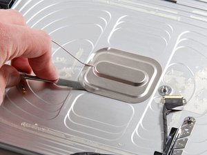

Image 1/3: A little prying with a metal spudger is required to separate the antenna from the rear case. Image 2/3: Tolerances look pretty tight in the antenna compartment. Check out that pocket just for the antenna to sit in. Image 3/3: Tolerances look pretty tight in the antenna compartment. Check out that pocket just for the antenna to sit in.
  • The bare rear case. The antenna behind the apple logo looks just like the antenna on the new iMacs.
  • A little prying with a metal spudger is required to separate the antenna from the rear case.
  • Tolerances look pretty tight in the antenna compartment. Check out that pocket just for the antenna to sit in.
How much does the bottom case weigh ? Battery + glass + lcd is 494g. So it should be about 150g. Is it ?
Jasiu - Reply
Quote from Jasiu:
Sorry should be step 22, can you move it ?
Jasiu - Reply
Quote from Jasiu:
I just weighed the aluminum back by itself. It's 138 grams, which is almost exactly 20% of the iPad's total weight.
Luke Soules - Reply
Any idea what the scalloping on the back of the case is for? I mean, it looks pretty... is it due to the CNC machining process, or to more easily stabilise and lock the boards etc. into it, or..?
Mike Hopkins - Reply
Image 1/1: Adding 3G capability to a Wi-Fi only iPad is not going to be a very feasible upgrade. Based on the photos released by the FCC, the 3G models include additional antennas as well as a plastic strip in the rear panel to improve reception.
  • Here's a detail shot of both WiFi antennas. The wireless reception should be decent with such dense antennas.
  • Adding 3G capability to a Wi-Fi only iPad is not going to be a very feasible upgrade. Based on the photos released by the FCC, the 3G models include additional antennas as well as a plastic strip in the rear panel to improve reception.
I haven't seen any mention of the microphone, but my assumption is that this is part of the headphone jack assembly (that small hole directly adjacent to the headphone jack).
Jeff - Reply
Quote from Jeff:
Yes, the microphone is right next to the headphone jack, and the signal goes through the same ribbon cable as the headphone jack.
Luke Soules - Reply
Image 1/2: As with most portable devices, the headphone jack is '''very''' well fastened to the case. Image 2/2: The microphone's right next to the headphone jack and goes through the same data cable as the headphone jack.
  • Remove a couple screws and pull the headphone jack out of the rear case.
  • As with most portable devices, the headphone jack is very well fastened to the case.
  • The microphone's right next to the headphone jack and goes through the same data cable as the headphone jack.
  • Like the iPhone, it appears that the iPad features a liquid sensor in its headphone jack. If you get your iPad wet, don't expect Apple to fix it under warranty for you.
So does the iPad only have one of those dreaded LSI (liquid submersion indicators)? Or is there another one on the inside?
mysterio - Reply
If Apple were more pro-consumer, they could engineer their products to be more water resistant. Instead, it almost seems as if some of their products (the notebooks) are designed to be damaged when spilled upon. A moisture barrier under the keyboard would've saved many headaches.
CityZ - Reply
Bravo Miro, tako se to radi ;)
Tarik - Reply
Quote from CityZ:
Nothing you've stated has anything whatsoever to do with "pro / anti consumer".
To the issue; unfortunately, barriers where you describe to keep moisture out; also keep heat in.
undone - Reply
Quote from mysterio:
Anyone?
mysterio - Reply
Anyone?
One in the headphone jack and one near the dock connector, from what I'm told.
opie - Reply
Quote from opie:
I didn't see any mention of a dock connector LSI in the teardown descriptions, that's why I asked.
mysterio - Reply
Image 1/3: Each clip holding the display assembly to the rear case is fastened down with its own T4 Torx screw. Image 2/3: Luckily, the home button is a digital switch with its own circuit board, making replacement that much easier. Image 3/3: Luckily, the home button is a digital switch with its own circuit board, making replacement that much easier.
  • Ants on parade? Nope, just the T4 Torx screws holding each tab to the display assembly.
    • Each clip holding the display assembly to the rear case is fastened down with its own T4 Torx screw.
  • Luckily, the home button is a digital switch with its own circuit board, making replacement that much easier.
It's nice to see the Home buttom can be easily repaired/replaced
Is that a space for an iSight camera?
coffeecoffee - Reply
Dudes, that sound hack could be sweet, IPAD BOOMBOXES ANYBODY?
POSTED BY IP
Ian P freely - Reply

Image 1/3: The display assembly weighs in at: Image 2/3: 153g for the LCD Image 3/3: 193g for the front glass
  • The display seems to be glued around its perimeter but can still be removed from the plastic framework.
  • The display assembly weighs in at:
    • 153g for the LCD
    • 193g for the front glass
  • The glass seems quite thick (~1.18 mm), which is not a huge surprise considering the size of the iPad. Compare that to about 1.02 mm for the iPhone.
    • The iPad would require thicker glass due to the increased "lever arm" caused by pressing down at the center of the screen. This is analogous to the difficulty of bending a one inch section of a ruler compared to bending the entire twelve inch ruler.
Are y'all able to determine if the glass is regular glass or something like Dow Corning's gorilla glass? i.e how breakable is it?
Boyd Fletcher - Reply
Image 1/2: The part number on the display frame reads: Image 2/2: HIA097NRFE0XA
  • Some front glass/digitizer part numbers.
  • The part number on the display frame reads:
    • HIA097NRFE0XA
  • On the digitizer cable:
    • 821-0757-A
Image 1/2: The numbers read: Image 2/2: A01327200 EP001A
  • Peel back the sticker, and more part numbers can be seen near the bottom of the LCD.
  • The numbers read:
    • A01327200 EP001A
    • 10 1 25 S NE M213
  • We don't know who made this particular LCD. Do you? Another iPad we opened contained a LCD panel that was manufactured by LG.
I guess the multi-touch panel is made by a Taiwanese LCD manufacturer called Wintek.
William - Reply
Quote from William:
No, Wintek can not manufacture LCD-TFT panels of this calibre of design
rft - Reply
Quote from rft:
Why not? Can they manufacture the ITO glass for the touch sensor?
William - Reply
I visited Toshiba Matshushita Display plant 18 months ago and there was some dinner and drinks discussion that they were working on a new larger display for the I pod touch. Maybe this was it?

The numbers read:
A01327200 EP001A
10 1 25 S NE M213
According to the model type "EP001A", I wonder if it is made by former EPSON imaging device, now that company has been sold to SONY Mobile Display Co.
At the same time, IPS technology patent of Hitachi is not licensed others except for its subsidiaries, CMO and LG, AFAIK.
Takashi OTA - Reply
As I know the LCD panel is assembly by Wintek Corporation.

Image 1/1: Here's the weight breakdown: Aluminum back: 138 grams, Battery: 148 grams, LCD: 153 grams, Glass (and frame): 193 grams, Speaker: 17 grams, Main board: 21 grams, Everything else: 27 grams
  • As always, the final layout shot.
  • Here's the weight breakdown: Aluminum back: 138 grams, Battery: 148 grams, LCD: 153 grams, Glass (and frame): 193 grams, Speaker: 17 grams, Main board: 21 grams, Everything else: 27 grams
  • Total: 697 grams (that's more than the .68 kg Apple quotes, has anyone else weighed their complete iPad?)

Do you have the weights for the component pieces in the step 31 photo? In particular how much does the aluminium back piece, the batteries and the screen each weigh compared to the total weight?
Trevor Abbott - Reply
Quote from Trevor Abbott:
I added the weights to the step. On my scale, the total weight of the iPad came out to 697 grams. That's definitely more than the .68 kg quoted in the Apple specs.
Luke Soules - Reply
Mine weighed 24.2 oz, which is 686 grams. Maybe the different display mfr causes a 10g difference.
Dean - Reply
Any chance you guys did a wallpaper shot after removing the screen? Please tell me you did.
sp33dwagon - Reply
Yes but if you go to http://www.apple.com/ipad/specs/ and go to footnote number 1 it reads, Actual size and weight vary by configuration and manufacturing process.
nirv - Reply

Is it possible to replace the A4 with a better processor or add RAM?
Todd Ransom - Reply
No, it is not possible. You cannot upgrade any parts on this, or later generation iPads, since the boards are all completely custom designed for each generation, and not compatible. Also as in most laptops, the size constraints mean that the processor was not intended to be replaceable, as is clear when you look at step 15.
