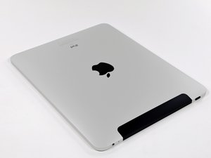

Image 1/2: The Wi-Fi + 3G iPad. We got a [guide|2197|sneak peak of the internals] of this tablet a month ago by poking around on the FCC's database. Image 2/2: The 3G iPad is visually distinguished from its Wi-Fi-only sibling by a black plastic RF window.
  • The much awaited iPad 3G is finally in the hands of iFixit!
  • The Wi-Fi + 3G iPad. We got a sneak peak of the internals of this tablet a month ago by poking around on the FCC's database.

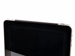

  • The 3G iPad is visually distinguished from its Wi-Fi-only sibling by a black plastic RF window.
  • The 3G iPad supports UMTS/HSDPA on 850, 1900, and 2100 MHz and GSM/EDGE on 850, 900, 1800, and 1900 MHz.
  • In a dramatic shift for Apple, the iPad is unlocked, and not tied down to a specific carrier.
  • Alas, in the US, AT&T is the only carrier that operates 3G on frequencies the iPad supports. T-Mobile should work, but only on the slower EDGE network.

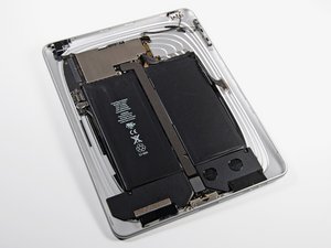

Image 1/1: There's no use wasting anymore time, let's see what makes this puppy growl.
  • The iPad's model number is A1337 as previously suggested by the FCC filing. Yes, we think that's l33t.
  • There's no use wasting anymore time, let's see what makes this puppy growl.
  • We'll be comparing the internals of this production unit to the preproduction FCC photos we exclusively unveiled a month ago.
  • After some careful prying around with a metal spudger, the display assembly can be removed from the rear case.
  • Due to the addition of 3G connectivity, there's an extra antenna cable that must be disconnected before the two halves are free.

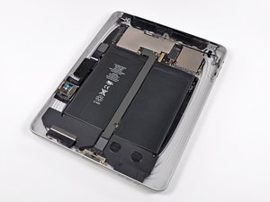

Image 1/2: Some major differences include the 3G chip, SIM card board, and the plastic antenna cover at the top of the case. Image 2/2: The 3G iPad is not nearly as barren as the Wi-Fi-only iPad, but it's still not jam-packed.
  • The innards of the iPad 3G (left) and the iPad Wi-Fi (right).
  • Some major differences include the 3G chip, SIM card board, and the plastic antenna cover at the top of the case.
  • The 3G iPad is not nearly as barren as the Wi-Fi-only iPad, but it's still not jam-packed.

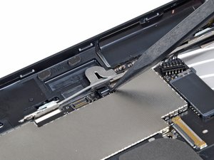

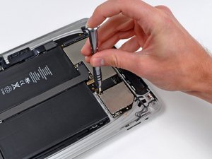

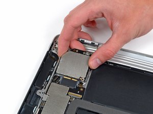

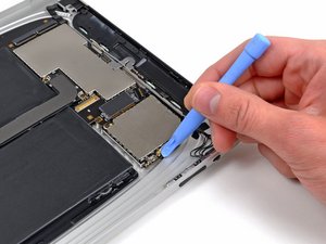

  • Pry up the antenna on the communications board with a plastic opening tool. This is one of two antennas on the communications board.
  • The communications board is secured by T4 Torx screws.
  • Upon removing the screws, the communications board slides out of its socket on the logic board. The connection socket style is similar to a Mini PCI Express card.

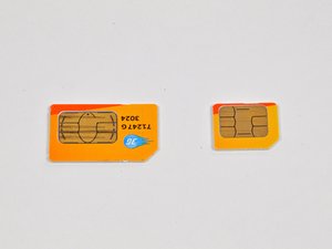

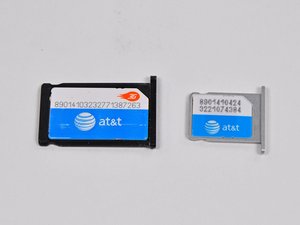

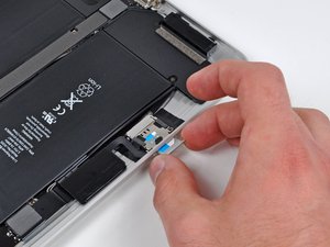

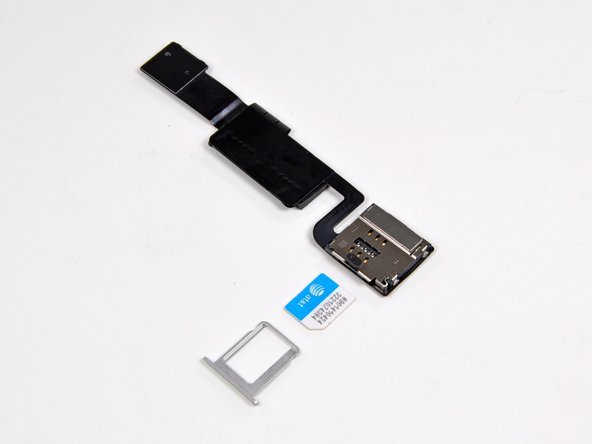

Image 1/3: The iPad's SIM card measures 12mm x 15mm. That's just under half the size of the standard size SIM card from an iPhone 3GS. Image 2/3: You could cut up a full-size SIM card and turn it into a Micro-SIM. The contacts are fully compatible. Image 3/3: You could cut up a full-size SIM card and turn it into a Micro-SIM. The contacts are fully compatible.
  • Removing the micro-SIM card. That's a really small SIM card!
  • The iPad's SIM card measures 12mm x 15mm. That's just under half the size of the standard size SIM card from an iPhone 3GS.
  • You could cut up a full-size SIM card and turn it into a Micro-SIM. The contacts are fully compatible.
The pin-out for a SIM and micro SIM are the same. You could cut down a full size SIM to fit and it would work.
Holland Rhodes - Reply
Quote from Holland Rhodes:
Yup pin-out, clock-speed, etc., are the same; I don't think there's been a SIM whose chip was larger than the contact area for over a decade, so be gentle with a sander, sand the @*%^*^! down, and voila.
sendai - Reply

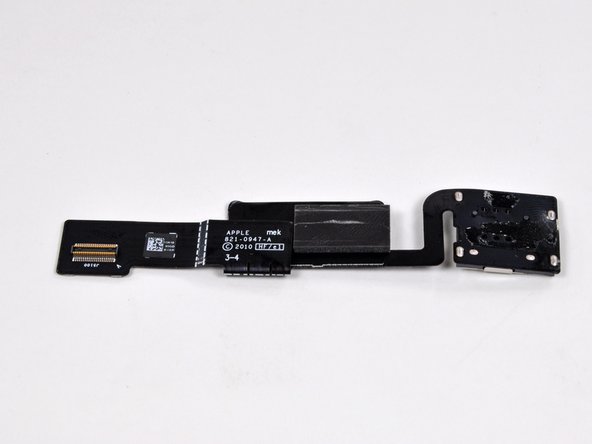

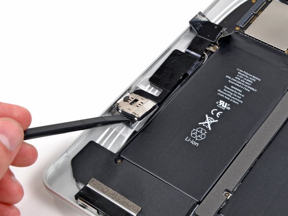

Image 1/3: It sure  doesn't look like Apple was tight on space. As far as we know, the only purpose of this board is to connect the SIM card to the logic board. Image 2/3: It sure  doesn't look like Apple was tight on space. As far as we know, the only purpose of this board is to connect the SIM card to the logic board. Image 3/3: It sure  doesn't look like Apple was tight on space. As far as we know, the only purpose of this board is to connect the SIM card to the logic board.
  • Use the flat end of a spudger to pry the SIM card slot off the rear case.
  • It sure doesn't look like Apple was tight on space. As far as we know, the only purpose of this board is to connect the SIM card to the logic board.
This finally explains the extra connector from the wifi-only model. It's strange to use so many pins to interface with the 6-contact card. Is there any active circuitry in the SIM cable/holder?

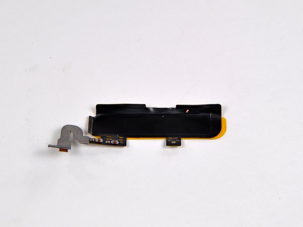

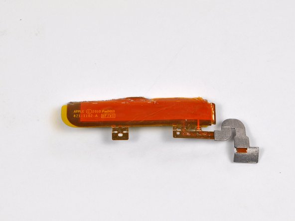

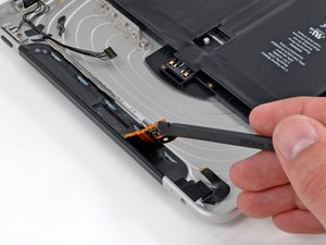

Image 1/2: The GPS antenna assembly can be pried off the plastic antenna cover with the flat end of a spudger. Image 2/2: The GPS antenna assembly can be pried off the plastic antenna cover with the flat end of a spudger.
  • Use the tip of a spudger to disconnect the GPS antenna ZIF cable connector.
  • The GPS antenna assembly can be pried off the plastic antenna cover with the flat end of a spudger.
I didn't realize until now that this antenna also serves as the proximity sensor.
Tom Chai - Reply
Image 1/2: Image 2/2:
  • The front and back of the GPS antenna assembly.
I don't think this is a GPS antenna. Suppose it is a capacity sensor for proximity detection.
Kelvin - Reply
Yes, you are right.
Tom Chai -

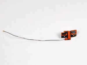

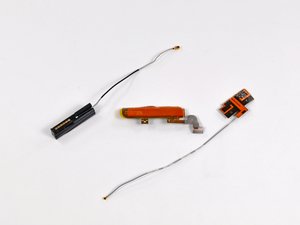

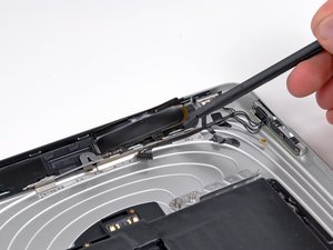

Image 1/3: The cellular antenna remains. Image 2/3: From left to right: the Wi-Fi/Bluetooth, GPS, and 3G antennas, respectively. Image 3/3: From left to right: the Wi-Fi/Bluetooth, GPS, and 3G antennas, respectively.
  • Lift the cellular antenna from its housing.
  • The cellular antenna remains.
  • From left to right: the Wi-Fi/Bluetooth, GPS, and 3G antennas, respectively.
Is the Wi-Fi antenna in the Apple logo or in the top with the GPS and 3G antenna? This should improve the Wi-Fi reception
Yoru - Reply
Please, where exactly is the A-GPS chipset on the com. board?
Thanks
Francis
Francis - Reply
Quote from Francis:
It's the Broadcom part in the top-left of the board, to the left of the Skyworks chip.
Kyle Wiens - Reply
Quote from Kyle Wiens:
Thanks, and I guess the Infineon PMB6952 is just between these two, on the middle-left of the board. Is it?
Francis - Reply
I'm also curious about where the WiFi antenna is. Is it still only behind the Apple on the back, or is it different in the 3G model from the WiFi only model?
djfriar - Reply
I don't get it. The GPS antenna is plugged on the main board, next to a chip absent from the Wifi version, but the AGPS chip is on the 3G communication board. Is the analog GPS signal routed between the boards?
Yann - Reply
Quote from Bigbird:
That is so weird!! I also can not figure out how the GPS RF signal routes into the chip! The GPS antenna with B2B connector (Most use to transmit logical signal), not the RF coaxial cable to feed into. Can someone explain why apple uses this way to carry GPS signal?
Bigbird - Reply
Might be worth a note that you're only showing one of the wifi/BT antennas (the lower one), and not the one behind the Apple logo.
cityzen - Reply
I'm pretty sure the GPS antenna is the one on the screen. The antenna on the ZIF connector seems to be an FM antenna with the BGA part being an FM receiver?
Avalon - Reply
If these are all the antennas, can someone tell us which antenna is shown in step 7 then? Thanks.
Laith - Reply

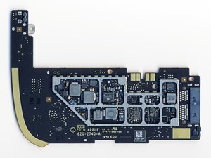

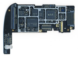

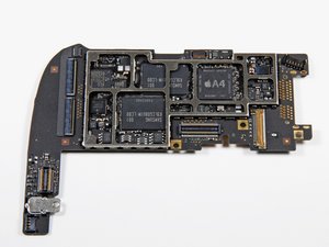

Image 1/2: The second shot is the main board from the Wi-Fi iPad. Image 2/2: Key differences?
  • The 3G board with A4 processor.
  • The second shot is the main board from the Wi-Fi iPad.
  • Key differences?
    • The most obvious change is the addition of the connector on the right side of the board for the communications board.
    • More subtle is an additional small IC above the A4 chip next to the connector for the GPS antenna. This may be a signal processor, but we can't firmly identify it: T3J 927 632567.
Image 1/2: Nothing much to see here, it's exactly the same as the Wi-Fi board. Image 2/2: Nothing much to see here, it's exactly the same as the Wi-Fi board.
  • Bottom of the main board.
  • Nothing much to see here, it's exactly the same as the Wi-Fi board.
Check out the copyright dates between the two boards. Perhaps this indicates the 3g version took longer to work out - which would explain the later release date
Michael - Reply
The later release date had to do with FCC clearance IIRC.
Eric Hoffmann -

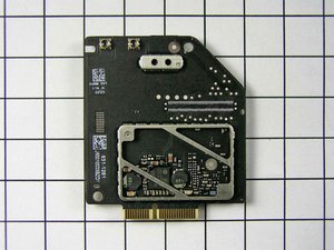

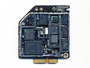

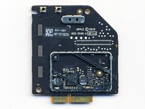

Image 1/2: Infineon 337S3754  [http://www.infineon.com/cms/en/product/channel.html?channel=ff80808112ab681d0112ab6ab94205ef|PMB 8878 X-Gold baseband IC] 5Y06115. This part had the Infineon logo in the pre-production unit, but Apple has white-labeled it to obscure the manufacturer. This is the exact same baseband processor as the iPhone 3GS. Image 2/2: Skyworks [link|http://www.skyworksinc.com/Product.aspx?ProductID=438|SKY77340] Power Amplifier Module
  • Apple soldered the EMI shield onto the communications board, making it challenging for us to show you the chips. Despite this adversity, we pressed forward undaunted, fearlessly unsoldering the board to reveal to you:
    • Infineon 337S3754 PMB 8878 X-Gold baseband IC 5Y06115. This part had the Infineon logo in the pre-production unit, but Apple has white-labeled it to obscure the manufacturer. This is the exact same baseband processor as the iPhone 3GS.
    • Skyworks SKY77340 Power Amplifier Module
    • Three Triquint power amplifier / filters.
    • Infineon U6952
    • Numonyx 36MY1EE
    • Along the right are three TriQuint power amplifiers: TQM616035A, TQM666032B, and TQM676031A. These are the same three chips that Apple used in the iPhone 3G nearly 2 years ago.
    • Broadcom A-GPS BCM47501UBG F01003 P11 949871 SN
Image 1/2: The second photo is from the pre-release FCC unit. The bottom of our board has additional part number markings, but is otherwise identical to the pre-production unit. Image 2/2: It's important to note that the Broadcom A-GPS package is on the communications board, explaining why the Wi-Fi-only iPad does not have GPS.
  • Bottom of communications board.
  • The second photo is from the pre-release FCC unit. The bottom of our board has additional part number markings, but is otherwise identical to the pre-production unit.
  • It's important to note that the Broadcom A-GPS package is on the communications board, explaining why the Wi-Fi-only iPad does not have GPS.
