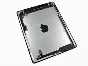

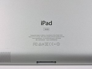

Image 1/2: Uh-oh, which iPad is this? iPad 2 3G? iPad 3 4G? iPad N (N+1)G? Image 2/2: Luckily for everybody, the model number is unique, unlike some of Apple's [[Topic:MacBook Pro|other]] products. The model number is A1430.
  • We spoke too soon. It appears that 4G LTE on the iPad 3 does not actually work in the land of Oz.
  • Uh-oh, which iPad is this? iPad 2 3G? iPad 3 4G? iPad N (N+1)G?
    • Luckily for everybody, the model number is unique, unlike some of Apple's other products. The model number is A1430.
The lack of LTE compatibility in Australia is due to the historical set of frequencies that the carriers (mainly, Telstra) are using here for it. It's well known to anyone who pays attention to these things in Australia. It's interesting they ship the same model though.

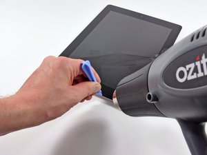

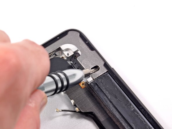

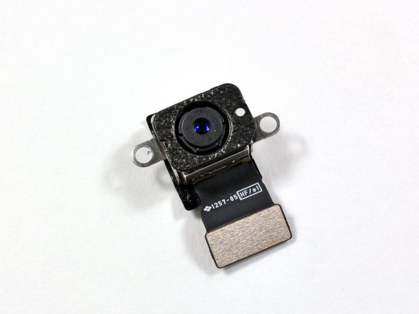

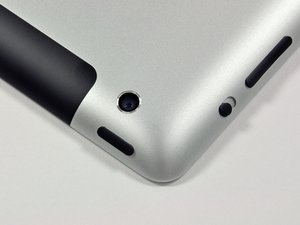

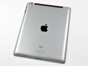

Image 1/3: The 5 MP iSight rear-facing camera boasts autofocus, face detection, 1080p HD video recording, and video stabilization. Definitely a great improvement over last year's weak 0.7 MP rear-facing camera. Image 2/3: The 2048×1536 pixel Retina display doesn't do much to amaze us once we turn the iPad off, but we didn't fly halfway across the world just to play [http://hipsterapp.com/|Punch a Hipster]. Image 3/3: The 2048×1536 pixel Retina display doesn't do much to amaze us once we turn the iPad off, but we didn't fly halfway across the world just to play [http://hipsterapp.com/|Punch a Hipster].
  • So this is what the rear panel of a new "new iPad" looks like. Do you know what it sort of reminds us of?
  • The 5 MP iSight rear-facing camera boasts autofocus, face detection, 1080p HD video recording, and video stabilization. Definitely a great improvement over last year's weak 0.7 MP rear-facing camera.

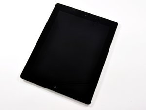

  • The 2048×1536 pixel Retina display doesn't do much to amaze us once we turn the iPad off, but we didn't fly halfway across the world just to play Punch a Hipster.
What temperature did you have to take the heat gun up to to make the adhesive come loose?

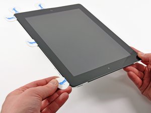

Image 1/1: Apple is estimated to ship 1 million units on launch day, and the environmental impact of this unfortunate design choice will be significant.

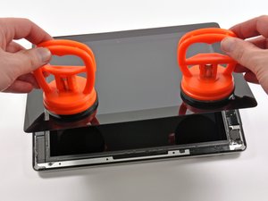

  • A heavy-duty display should only be removed with heavy-duty suction cups.
  • The first legitimately-purchased, legitimately-owned iPad 3 is now also the first legitimately-opened iPad ... in the world.
  • Apparently, the new iPad has a face, and it's not happy. Look familiar?

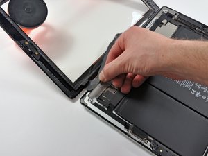

Image 1/2: Rather than enjoy the 264 pixels per inch on this brand new device, we opt to remove the acclaimed display. Why? Because we're iFixit, and that's how we roll. Image 2/2: As we lift the LCD, we hear the cries of 3,145,728 pixels being dislodged from their homes inside the iPad 3.
  • Well, this display is screwed...to the case. Luckily, we have a BS degree in removing screws, so this poses no challenge.
  • Rather than enjoy the 264 pixels per inch on this brand new device, we opt to remove the acclaimed display. Why? Because we're iFixit, and that's how we roll.
  • As we lift the LCD, we hear the cries of 3,145,728 pixels being dislodged from their homes inside the iPad 3.

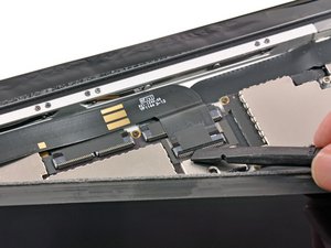

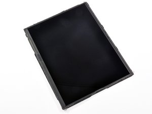

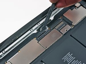

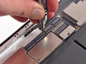

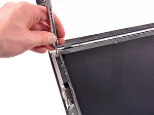

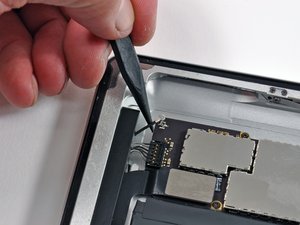

Image 1/3: As we mentioned in our sneak-peek [http://youtube.com/watch?v=0PfcA4WcfNA|video], the display connectors in the iPad 2 and iPad 3 are different, meaning the two displays are incompatible...for now. Image 2/3: As we mentioned in our sneak-peek [http://youtube.com/watch?v=0PfcA4WcfNA|video], the display connectors in the iPad 2 and iPad 3 are different, meaning the two displays are incompatible...for now. Image 3/3: As we mentioned in our sneak-peek [http://youtube.com/watch?v=0PfcA4WcfNA|video], the display connectors in the iPad 2 and iPad 3 are different, meaning the two displays are incompatible...for now.
  • It's time to cut spudge the umbilical cord on the display and touchscreen.
  • As we mentioned in our sneak-peek video, the display connectors in the iPad 2 and iPad 3 are different, meaning the two displays are incompatible...for now.

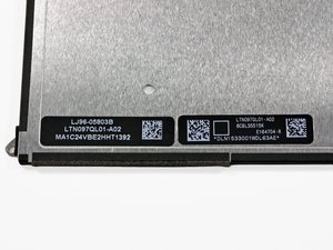

Image 1/2: Beside the numbers we find three mysterious matrix barcodes. They allure the teardown expert, a dubious distraction indeed. What do they do? Our best guess: crash your iPhone or turn it into an iPad...scan at your own risk. Image 2/2: Beside the numbers we find three mysterious matrix barcodes. They allure the teardown expert, a dubious distraction indeed. What do they do? Our best guess: crash your iPhone or turn it into an iPad...scan at your own risk.
  • The model numbers on the back of the 9.7 inch LCD lead us to believe this is a Samsung LCD.
  • Beside the numbers we find three mysterious matrix barcodes. They allure the teardown expert, a dubious distraction indeed. What do they do? Our best guess: crash your iPhone or turn it into an iPad...scan at your own risk.
Those aren't QR codes, they're Data Matrix codes. From left to right, they decode to MA1C24VBE2HHT1392, DLN1533001WDL63AE, and 6CBL35515K.
Rob - Reply
Are you guys going to disassemble the screen? I'm very curious about wether or not two LED backlights are being used to pump enough light through the Retina display.
The "remorsphere" was always mentioning that getting enough backlight in the iPad was one of the main challenges to overcome to integrate a Retina display.
paulius - Reply
The PDF linked from Step 11 of this links to a display with the designation LTN097XL01-A01, not the LTN097QL01-A02 listed on this page. Could be a variant, but the tech info also lists the resolution as "1024 x 768 pixels".
richard29 - Reply

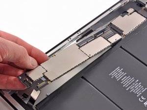

Image 1/3: We might not be very good at writing poetry, but with [http://www.ifixit.com/Tools/Spudger/IF145-002|spudger] and [http://www.ifixit.com/Tools/54-Bit-Driver-Kit/IF145-022|screwdriver] in hand, we are masters of our craft. Image 2/3: We might not be very good at writing poetry, but with [http://www.ifixit.com/Tools/Spudger/IF145-002|spudger] and [http://www.ifixit.com/Tools/54-Bit-Driver-Kit/IF145-022|screwdriver] in hand, we are masters of our craft. Image 3/3: We might not be very good at writing poetry, but with [http://www.ifixit.com/Tools/Spudger/IF145-002|spudger] and [http://www.ifixit.com/Tools/54-Bit-Driver-Kit/IF145-022|screwdriver] in hand, we are masters of our craft.
  • Connectors and screws, connectors and screws, to secure a logic board, that's what you use!
  • We might not be very good at writing poetry, but with spudger and screwdriver in hand, we are masters of our craft.

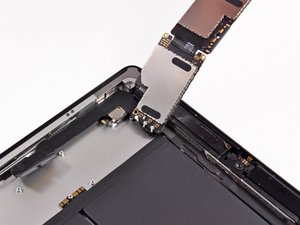

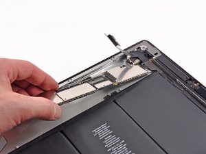

Image 1/3: Thank you Siri... Siri? Are you there?  (''silence'') Image 2/3: Thank you Siri... Siri? Are you there?  (''silence'') Image 3/3: Thank you Siri... Siri? Are you there?  (''silence'')
  • Come now, iPad. Let go of your logic board, please.
  • Thank you Siri... Siri? Are you there? (silence)
3.7V 43.0Whr 11560mAh
Li-ion Polymer Battery
Korantin - Reply

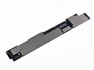

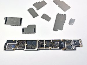

Image 1/2: Using some leftover pixie dust from our [guide|6610|iPhone 4S teardown], we will remove the EMI Shields to fly off so we can take a peek at the logic board. Image 2/2: Using some leftover pixie dust from our [guide|6610|iPhone 4S teardown], we will remove the EMI Shields to fly off so we can take a peek at the logic board.
  • The logic board is out!
  • Using some leftover pixie dust from our iPhone 4S teardown, we will remove the EMI Shields to fly off so we can take a peek at the logic board.
Having pictures of both sides of the logic board would be impressive.

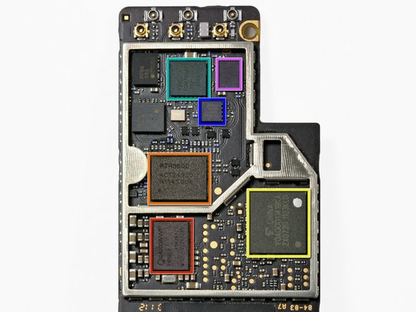

Image 1/1: Qualcomm PM8028 Power Management IC
  • ...and here's some more salsa on the other end of the non-A5X side:
    • Qualcomm PM8028 Power Management IC
    • Qualcomm RTR8600 multi-band/mode RF transceiver for 3G and 4GLTE bands
    • Toshiba Y0A0000 Memory MCP
    • Triquint TQM7M5013 quad-band linear power amplifier module
    • Avago A5904
    • Skyworks SKY77468-17 front-end module

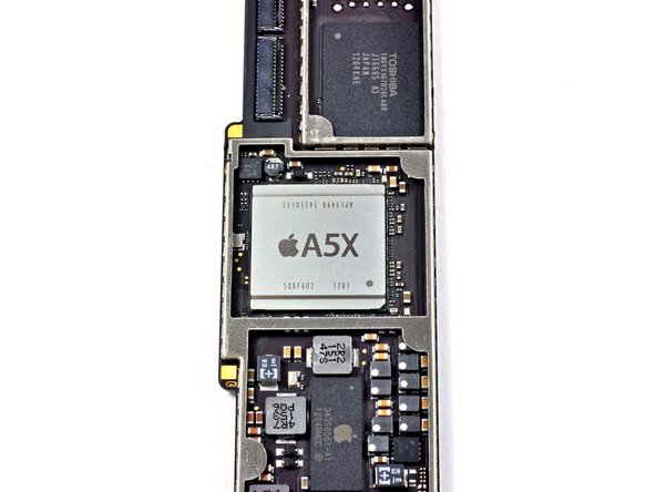

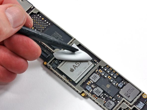

Image 1/2: Like the A5, the A5X system features a 1 GHz dual-core CPU. The upgrade that earns it an 'X' is the new GPU, which Apple ''[http://www.cnet.com.au/nvidia-on-apples-ipad-a5x-graphics-claims-show-us-the-benchmarks-339333424.htm|claims]'' outperforms even Nvidia's Tegra 3 processor. Image 2/2: This particular chip was manufactured in the first week of 2012. Maybe our iPad marks the start of [http://www.sonypictures.com/movies/2012/|the end of the world].
  • Some crafty spudgering reveals the A5X processor in all its glory.
  • Like the A5, the A5X system features a 1 GHz dual-core CPU. The upgrade that earns it an 'X' is the new GPU, which Apple claims outperforms even Nvidia's Tegra 3 processor.
  • This particular chip was manufactured in the first week of 2012. Maybe our iPad marks the start of the end of the world.
    • Not prepared? There’s an app or two for that...
an extra 0.2 GHz? So it's a 1.2 GHz A5? I thought it wasn't supposed to have changed.
Jerry Ross - Reply
It seems DRAM is not any more inside processor Package-On-Package Module of A5X:
- the package is of different type
- existence of both DRAM packages
Thermal dissipation could have played role in making the decision to separate CPU and DRAM
Dimitar - Reply
Sorry, still stuck on the 0.2 GHz here... the Geekbench scores from Tinhte showed a 1 GHz A5 chip. Can anybody confirm or deny this??
Jerry Ross - Reply

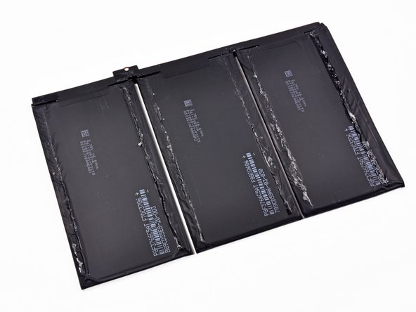

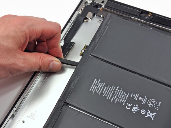

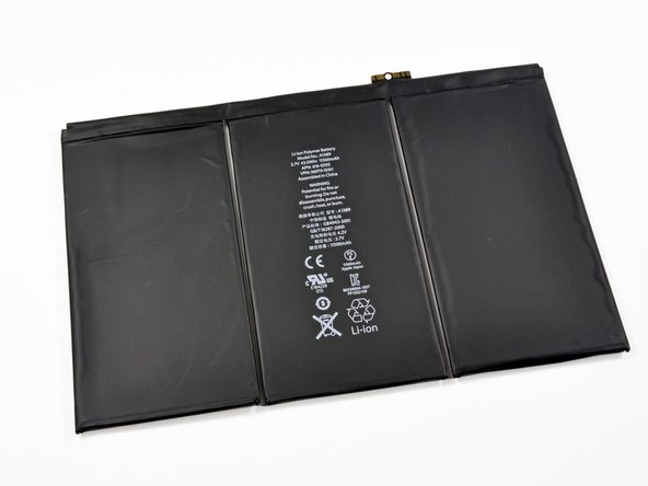

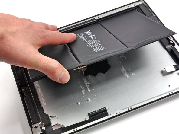

Image 1/3: Some help from our spudger allows us to remove the battery from the device for further inspection. Image 2/3: While the iPad 2 housed a formidable 25 watt-hour Li-ion battery, the iPad 3 has upped the ante to the tune of 42.5 watt-hours. Image 3/3: Its 3.7 volts and estimated 10 hours of use (9 with cellular data network) are comparable to that of the iPad 2, but we assume the extra 17.5 watt-hours are put to good use powering the extra RAM and greatly improved GPU.
  • As is the case with most tablets, the iPad 3 is really just a giant battery.
  • Some help from our spudger allows us to remove the battery from the device for further inspection.
  • While the iPad 2 housed a formidable 25 watt-hour Li-ion battery, the iPad 3 has upped the ante to the tune of 42.5 watt-hours.
  • Its 3.7 volts and estimated 10 hours of use (9 with cellular data network) are comparable to that of the iPad 2, but we assume the extra 17.5 watt-hours are put to good use powering the extra RAM and greatly improved GPU.
  • The battery has three cells, each approximately 12.5 cm x 6.5 cm x 4 mm. The iPad 2's battery cells were 10.8 cm x 6.3 cm x 2.7mm.
Lol...The battery gets 60mAh more in Chinese...
Leo Zhang - Reply
I'm really interested in the physical size difference between the iPad 2 and this battery. Mostly the weight. Is this some new battery "tech" or is it the same technology just more battery material? Since it is almost double the capacity 42 watt-hours versus 25 of the iPad 2.
Thanks-Todd
Todd - Reply
Second the request for the battery weight and comparison to the iPad2.
Eric Allison - Reply
I'd also be interested in knowing if the battery is more massive than the iPad 2's. A lot of battery "tech" is in the electrochemistry, and if there isn't a significant difference in mass between the old battery and the new one, then Apple's gone to a more advanced LiIon chemistry.
Rob - Reply
that's super cool guys thanks a lot!
Jhon - Reply
The new display may also require more power than the old. 4X as many transistors, after all.
cityzen - Reply
If you took a picture right after removing the retina LCD, you could give us a direct impression of the size of batteries. Just like you did in the iPhone 4 teardown - "holy battery".
Jim - Reply

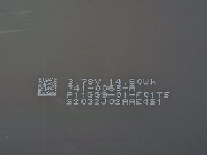

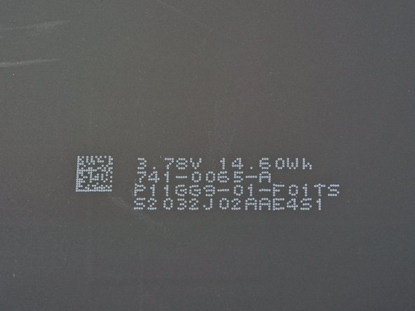

Image 1/2: Chris Foresman at Ars Technica compared the energy density to the battery in the iPad 2, and it comes out about the same—around 0.0014 watt-hour / mm^3. Image 2/2: Apple physically increased the size of each cell by about 70%, explaining the big jump from 25 to 42 watt-hours.
  • Each separate cell lists its rating of 3.78 volts and 14.60 watt-hour. They're graced with some more matrix barcode tags and wonderful inscriptions that read 741-0065-A P11GG9-01-F01TS. Swoon.
  • Chris Foresman at Ars Technica compared the energy density to the battery in the iPad 2, and it comes out about the same—around 0.0014 watt-hour / mm^3.
  • Apple physically increased the size of each cell by about 70%, explaining the big jump from 25 to 42 watt-hours.
  • Apple claims the new iPad is environmentally friendly with a "Recyclable aluminum and glass enclosure." The materials may be recyclable, but the assembled unit is not. We spoke yesterday with Steve Skurnac, president of SIMS Recycling Solutions—one of the largest electronics recyclers in the world. He told us, "Sealed units make it difficult to remove the batteries. From a recycler's point of view, the hazardous components [like batteries] need to be easily separated or removed."
Those look like DataMatrix codes, not QR codes, in case you want to try them. They usually just contain a machine-readable version of the numbers printed next to them, though.
samkass - Reply

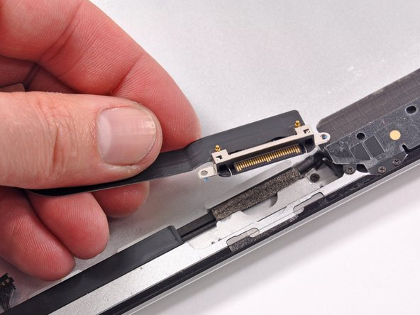

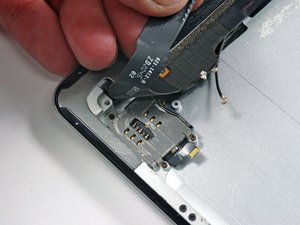

Image 1/3: Being the vultures that we are, let's continue picking away at the remains of this aluminum beast...first on our list is the dock connector. Image 2/3: The dock connector seems to have the same pin layout as the iPad 2, we have yet to determine whether or not the dock connectors are swappable. Image 3/3: Pesky, finicky screws! Be gone and let us remove the antenna in peace.
  • As we progress through the teardown, what remains is just the carcass of a once mighty iPad.
  • Being the vultures that we are, let's continue picking away at the remains of this aluminum beast...first on our list is the dock connector.
  • The dock connector seems to have the same pin layout as the iPad 2, we have yet to determine whether or not the dock connectors are swappable.
  • Pesky, finicky screws! Be gone and let us remove the antenna in peace.
Where is the WiFi antenna located? (In Apple's iPad announcement, there was a picture of the various wireless technologies which indicated that the WiFi antenna would be in the lower third of the iPad, and not behind the Apple logo.)
sru - Reply

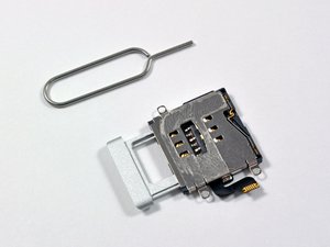

  • Get out of the way, ribbon cable! Let us get a look at that micro-SIM card slot.
  • Like the other iPads with micro-SIM cards, the iPad 3 4G has a user-accessible micro-SIM card slot that can be ejected with the help of a handy SIM card eject tool.
  • Sorry, former Amp'd Mobile users, this iPad can only be used on AT&T and Verizon networks.

Image 1/3: Well hello there! Fancy to meet you here iSight camera. Image 2/3: You have what specs? Oh, a 5 element lens, an IR filter, and auto exposure. Stop it iSight, you're making us blush... Image 3/3: '''UPDATE:''' [http://www.chipworks.com/en/technical-competitive-analysis/resources/recent-teardowns/2012/03/the-new-ipad-a-closer-look-inside/|Chipworks found out that] the primary camera is indeed the same image sensor Apple used on the iPhone 4: Omnivision OV5650, 1.75 um pixel pitch, 5 MP back illuminated CMOS Image Sensor.

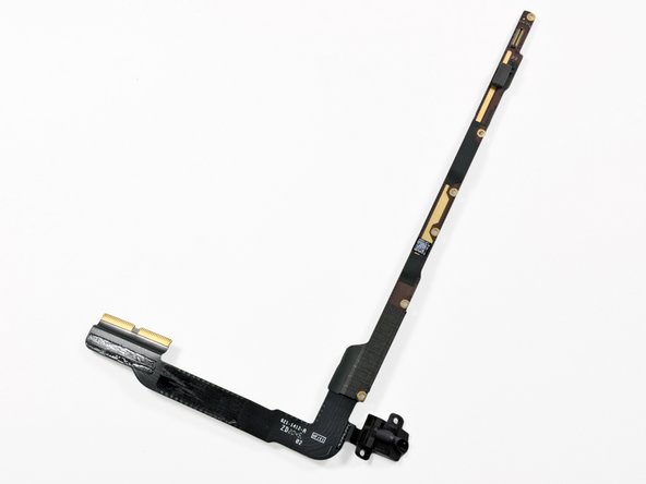

  • The headphone jack and one of the many wireless antennas come out as a single unit. Bummer.
  • Well hello there! Fancy to meet you here iSight camera.
    • You have what specs? Oh, a 5 element lens, an IR filter, and auto exposure. Stop it iSight, you're making us blush...
  • UPDATE: Chipworks found out that the primary camera is indeed the same image sensor Apple used on the iPhone 4: Omnivision OV5650, 1.75 um pixel pitch, 5 MP back illuminated CMOS Image Sensor.
  • The secondary image sensor is also an Omnivision, the OV297AA. 0.3 Mp, 3.0 um pixel pitch CMOS Image Sensor
Is there any indication of the 5MP camera module sensor being the Omnivision OV5690 ?
Tim Millea - Reply
The headphone jack assembly is also a hub of sorts that brings together many smaller connectors into a single large connector for the motherboard.
cityzen - Reply
Camera manufacturer?
john - Reply
Does the new iPad come with any LCI?
Wong - Reply

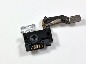

Image 1/2: Whether you're video chatting or fixing your hair, the front-facing camera is sure to meet all of your low resolution photography and video needs. Image 2/2: Whether you're video chatting or fixing your hair, the front-facing camera is sure to meet all of your low resolution photography and video needs.
  • Pulling out other fine parts, such as the front-facing camera and antenna.
  • Whether you're video chatting or fixing your hair, the front-facing camera is sure to meet all of your low resolution photography and video needs.
Do you plan to take apart the front-facing camera? I'd very much like to know who is making the 5 megapixel sensor.
Thanks. Jim
W James Kitchens Jr - Reply
Second the request on who the CMOS image sensor manufactures are.
Mike Moore - Reply
Third that.

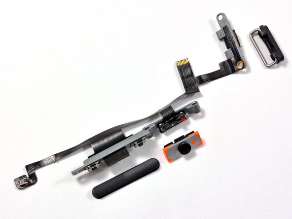

Image 1/2: The speaker assembly is the next victim on our list. Farewell speakers! Image 2/2: The speaker assembly is the next victim on our list. Farewell speakers!
  • What an array of buttons and switches! This truly is a sight to see. Buttons of all kinds. Switches of all types. So many!
  • The speaker assembly is the next victim on our list. Farewell speakers!

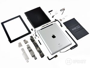

Image 1/2: The LCD is easy to remove once the front panel is gone. Image 2/2: The battery is not soldered to the logic board, making the replacement process a tad less difficult.
  • iPad 3 Repairability Score: 2 out of 10 (10 is easiest to repair)
    • The LCD is easy to remove once the front panel is gone.
    • The battery is not soldered to the logic board, making the replacement process a tad less difficult.
    • Just like the iPad 2, the front panel is glued to the rest of the device, greatly increasing the chances of cracking the glass when trying to remove it.
    • Gobs, gobs, and gobs of adhesive hold down everything in place, including the prone-to-start-a-fire-if-punctured battery.
    • The LCD has foam sticky tape adhering it to the front panel, increasing chances of the front panel being shattered during disassembly
    • You can't access the front panel's connector until you remove the LCD.

could you measure the battery pack ? x,y,z ? that would be amazing !
Jhon - Reply
The new battery has 3 cells, each about 12.5 cm x 6.5 cm x 4 mm.
Kyle Wiens -

Can you weigh the entire battery as well?
We don't have a scale in Australia; we'll weigh it tomorrow once we get one in California.
Kyle Wiens -
The revised three-cell design appears to be just slightly larger than the battery in the iPad 2—each measures about 125 x 65 x 4 mm, according to iFixit CEO Kyle Wiens. The cells in the iPad 2 measure 108 x 63 x 2.7mm, so the iPad 3 battery is actually about 70 percent larger.

Step 19:
Skyworks SKY77469 Front End Module was not highlighted. Skyworks has not 1 but 2 front end modules on the new ipad. Please update the slide to show for this.
RFdude - Reply

What is the "pixel density" of the "Digitizer"? By that I mean, if I am creating a "notepad" type application using a fine-tip touch-panel pen, what kind of granurality (or clarify) am I going to draw on the LCD panel? Is the digitizer the same density as the display pixel density? I hope so!!
pnanda - Reply
what is the digitizer pixel density? If I want to use a "notepad" type application, what clarity am I going to get on a line I draw with a touch-panel pen? drawing, network diagrams etc would be great on this iPad if its digitizer density matches its display pixel density.
pnanda - Reply
