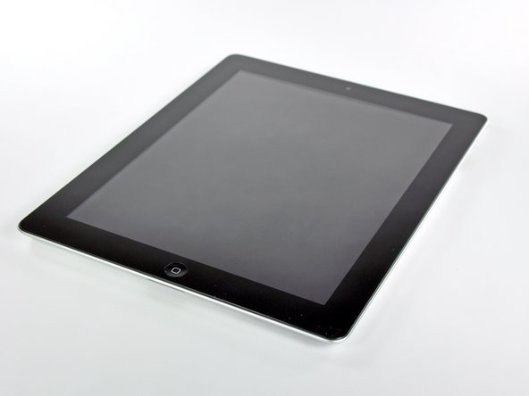

We got our hands on Apple's newest tablet, the iPad 2 on March 11, 2011. Follow us on Twitter to get all the latest updates.
Check out MJ's video analysis of all the cool stuff we found in the iPad 2!

Image 1/2: After a much awaited debut, the iPad 2 is expected to fill in the gaps left by the first generation iPad. Image 2/2: Tech Specs:
  • Finally!!! The iPad has come back to iFixit! And this time, it has a 2 at the end of its name, hence the iPad 2!
  • After a much awaited debut, the iPad 2 is expected to fill in the gaps left by the first generation iPad.

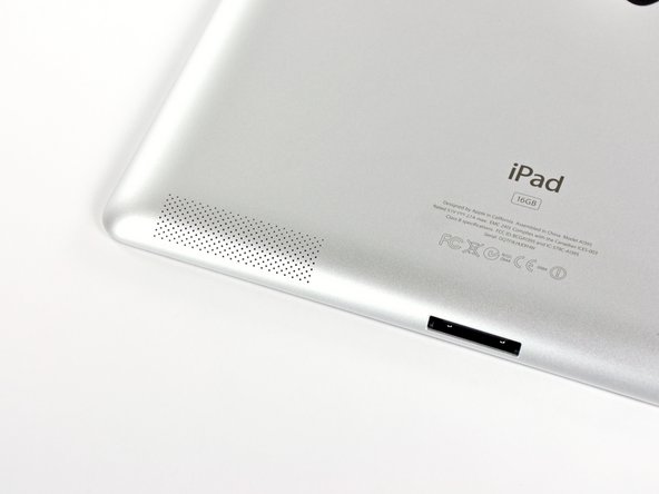

Image 1/1: Apparently, the iPad 2 is not as [http://en.wikipedia.org/wiki/Leet|1337] as the original iPad.

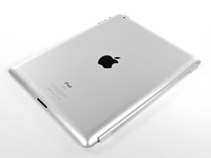

  • A new model number graces the iPad 2: A1395. Thank you, Apple! That's much nicer of you than the twenty-six billion iterations of MacBook Pros you called model A1286.
    • Apparently, the iPad 2 is not as 1337 as the original iPad.
  • The sole speaker grate can be found on the bottom-left of the back of the iPad 2. We're not fans of mono, but stereo will have to wait until iPad 3.

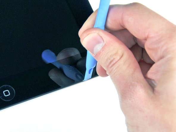

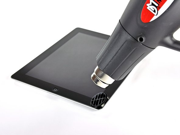

  • Unlike the original iPad, it looks like we need the help of a handy dandy heat gun to remove the front panel.
  • With the adhesive loosened after a healthy dose of heat, we go to work on prying up the front panel with a plastic opening tool.
NOW I see why my white iPad 2's front plate is kind of loose after leaving it in a hot, sunny car. Stupid glue.
Quinn Vinlove - Reply
What else can I use to open the iPad 2? A Hair Dryer? I need to get i opened, but I can't get a heat gun in this country -_-.
Karan Varindani - Reply
Image 1/1: As much as we hated trying to remove the clips in the original iPad, this much adhesive is even more of a pain.  Be ready to crack your front panel if you dare open it! We'll be investigating the best way to get inside over the next few weeks.
  • And just like that, it's open. No clips, just tons of glue.
  • As much as we hated trying to remove the clips in the original iPad, this much adhesive is even more of a pain. Be ready to crack your front panel if you dare open it! We'll be investigating the best way to get inside over the next few weeks.

I personally found it easier to use 4 plastic pry tools. Once you get the first one in, heat up that area so that a second one can be inserted. Then start twisting the tool slowly, then slid it to the right heating as you go and adding a new tool in the middle of each side. Works like a charm and no broken screen.
Mr H - Reply

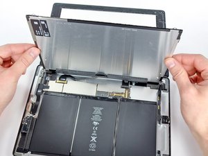

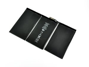

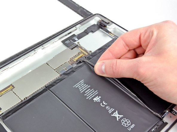

Image 1/2: Also listed on the battery is a capacity of 6930 mAh, which may appear to contradict the already mentioned 25Wh at 3.8V ((25Wh/3.8V)*1000=6579 mAh), but 3.8V is the listed nominal voltage, not the average voltage. The average voltage of the battery over a full charge/discharge is closer to 3.6V leading to a more accurate calculation ((25Wh/3.6V)*1000=6944 mAh). Image 2/2: After disconnecting its cable, the display can be removed from the iPad 2.
  • Lifting off the LCD exposes the iPad 2's battery; A 3.8V, 25 Watt-hour unit. That's just a hair more than the original iPad's 24.8 Watt-hours, so any improved battery performance can be attributed to software and other hardware improvements.
  • Also listed on the battery is a capacity of 6930 mAh, which may appear to contradict the already mentioned 25Wh at 3.8V ((25Wh/3.8V)*1000=6579 mAh), but 3.8V is the listed nominal voltage, not the average voltage. The average voltage of the battery over a full charge/discharge is closer to 3.6V leading to a more accurate calculation ((25Wh/3.6V)*1000=6944 mAh).
  • After disconnecting its cable, the display can be removed from the iPad 2.
3.6V = nominal rating of Li-Ion cell and would agree with 25W/6930 mAH battery notation. Actual cell voltage can vary from 4.2 V to 2.6V, though cut off may be around 3 V. Agree 3.8 V stamp doesn't fit.

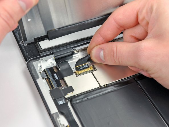

Image 1/2: An Apple device just wouldn't be complete without Multi-Touch. No surprise there. Image 2/2: Removing the camera/volume control daughterboard connector from the logic board.
  • Disconnecting the touchscreen ribbon cable from its socket on the logic board.
  • An Apple device just wouldn't be complete without Multi-Touch. No surprise there.
  • Removing the camera/volume control daughterboard connector from the logic board.

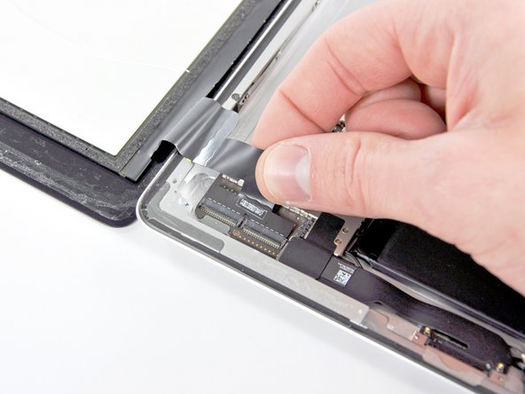

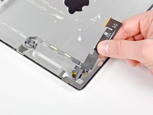

Image 1/1: After disconnecting the dock connector, we disconnect the speaker connector.
  • Next we disconnect the dock connector ribbon cable from the logic board.
  • After disconnecting the dock connector, we disconnect the speaker connector.

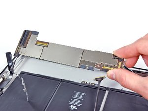

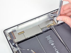

Image 1/2: Image 2/2:
  • The logic board comes out without a fuss after removing the Phillips screws securing it to the case.

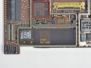

Image 1/2: Broadcom BCM5973KFBGH Microcontroller used for touchscreen Image 2/2: Broadcom BCM5974 CKFBGH capacitative touchscreen controller

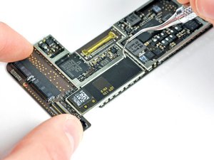

  • After popping off a few EMI shields, we get a good look at the ICs on the logic board. They include:
    • Broadcom BCM5973KFBGH Microcontroller used for touchscreen
    • Broadcom BCM5974 CKFBGH capacitative touchscreen controller
      • This is the same combination as the original iPad - nothing new here!
  • Interestingly, the Wi-Fi board is attached to the logic board under one of the EMI shields. It can be easily pried off its socket.
Image 1/1: This is the same part Apple used in both the first iPad and the iPhone 4.
  • The Wi-Fi board; powered by another Broadcom chip, a BCM43291HKUBC. Broadcom has made this Wi-Fi/Bluetooth/FM tuner combo chip a ubiquitous part for smartphones - lots of design wins.
  • This is the same part Apple used in both the first iPad and the iPhone 4.

Image 1/1: Apple 1GHz A5 dual-core Processor with a 200MHz bus and 512 MB of Samsung manufactured RAM.
  • Notable chips found on the logic board (click here for mega size):
  • Apple 1GHz A5 dual-core Processor with a 200MHz bus and 512 MB of Samsung manufactured RAM.
  • Toshiba TH58NVG7D2FLA89 16GB NAND Flash
  • Apple 343S0542 - this looks like the Dialog Semi power management chip found in last year's iPad - all of those inductors and capacitors surrounding it are a clue.
  • Texas Instruments CD3240B0 11AZ4JT G1 touchscreen line driver, working with the Broadcom BCM5973 and BCM5974 chips shown above.
  • S6T2MLC N33C50V Power Management IC
  • The A5 processor has manufacture dates of late January and mid-February 2011. Production was clearly ramping up through the last minute. It looks like the A5 processor is the APL0498, replacing the A4/APL0398 seen in the iPad 1 and iPhones.
  • Apple-branded 338S0940 A0BZ1101 SGP. This looks like the Cirrus audio codec Chipworks found in the Verizon iPhone, but they'll have to get it off the board to make sure.
the code written on the A5 identifies the ram
K3PE4E400B - XGC1
K3: Samsung Mobile DRAM Stac
P: MDDR2-P(※S4)+MDDR2-P(※S4)
E4: A-Port I/F & Density & Vcc& Org (?)
E4: B-Port I/F & Density & Vcc& Org (?)
0: Reserved
0: Interposer I/F (0: none)
B: Generation B-Die
X: Package (?)
G: Temp. (G : -25 ~ 85℃)
C1: Speed (C1 : 2.5ns@RL6, TRCD18ns, TRP18ns)
matteolevel - Reply

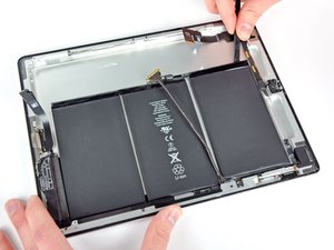

Image 1/2: The iPad 2 uses three massive Li-Ion cells to provide an impressive 10-hours of battery life. Image 2/2: The iPad 2 uses three massive Li-Ion cells to provide an impressive 10-hours of battery life.
  • Prying up the 3.8V 25 Watt-hour Li-Ion Polymer battery from the back case.
  • The iPad 2 uses three massive Li-Ion cells to provide an impressive 10-hours of battery life.
There were 2 (probably thicker) cells in the Ipad 1. And there was some free space in the case. Apple probably managed to use that free space by putting in 3 thinner battery cells and thereby securing the same battery life for the device.
Ahmet - Reply
One obvious question... how much does the battery weigh? In thinking about how Apple might reduce weight in future iPads, the weights of the battery, aluminum frame and front display all seem worth seeing. You supplied this on the original iPad teardown...
Glenn - Reply

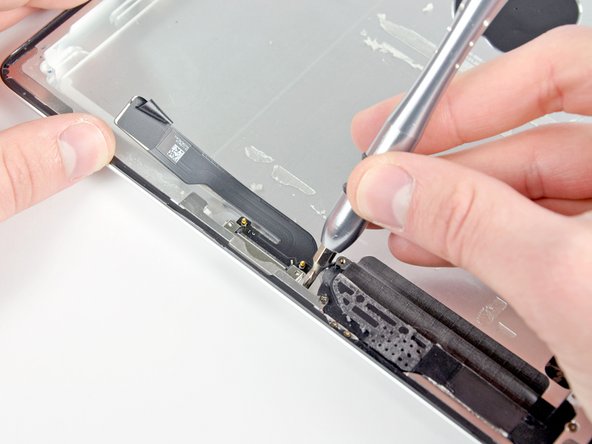

Image 1/1:
  • Removing a screw that secures the volume control board to the case.

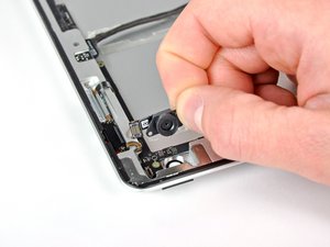

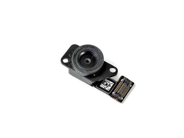

  • Rear-facing camera comes out of its recess.
Any idea who makes the sensor? Omnivision?
emmylou323 - Reply
Any ideas how feasible it might be to replace this camera with the one meant to go in an iPhone4? I bet the software would have a decent chance of recognizing it if the physical size and electrical connections matched. I'd love to mod my iPad2 with an upgraded camera, but ideally I'd like to know if it'd have any chance of working before I potentially destroy it.
Paul Jacobs - Reply
That's why the debate on getting the original iPad instead. Not paying extra for what you don't want.
DarkReaper -
Seriously, please, someone from ifixit - are the connections and physical shape the same between the iPhone4 and iPad2 rear cameras? Could they be swapped if you assume there are no software issues?
Paul Jacobs -
Hi there. It seems that the connectors between the iPhone 4 (on the left) and iPad 2 (on the right) rear-facing cameras are different. http://bit.ly/fyFx9M
Walter Galan -

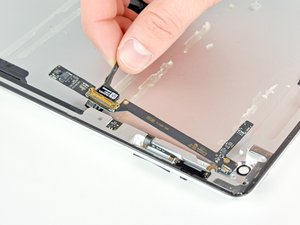

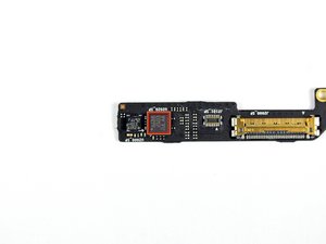

Image 1/2: On this little board the AGD8 2103 gyroscope rears its pretty little head, next door to the LIS331DLH accelerometer, both by STMicroelectronics. Image 2/2: On this little board the AGD8 2103 gyroscope rears its pretty little head, next door to the LIS331DLH accelerometer, both by STMicroelectronics.
  • Removing the board containing the volume control and silent/screen rotation lock button.
  • On this little board the AGD8 2103 gyroscope rears its pretty little head, next door to the LIS331DLH accelerometer, both by STMicroelectronics.
That wasn't as easy as it looks.The board is glued to the side of the case I had to hit it with some heat to get it to come out. Also don't forget to remove the front camera housing.
gcroley - Reply
Didn't show it's a step. Before removing that all the way make sure to remove the black tape and disconnect the power volume flex or you might end up tearing it and have to buy a new one like I did.
Jose Martinez - Reply

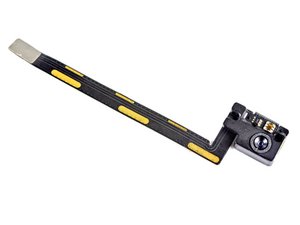

  • After removing a screw securing the front-facing camera assembly to the case and peeling off a little more adhesive, the assembly can be removed.
The back of the camera is glued in had to hit it with a little heat to get it out
gcroley - Reply

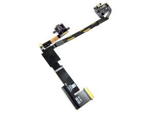

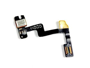

Image 1/3: Front-facing camera. Image 2/3: Microphone. Image 3/3: Microphone.
  • The front-facing camera assembly includes the camera, headphone jack, and microphone.
  • Front-facing camera.
  • Microphone.

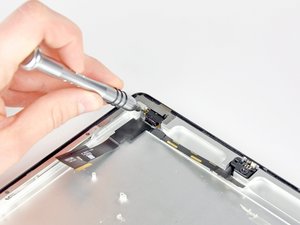

Image 1/1:
  • Removing the two screws securing the dock connector to the case.

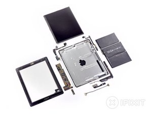

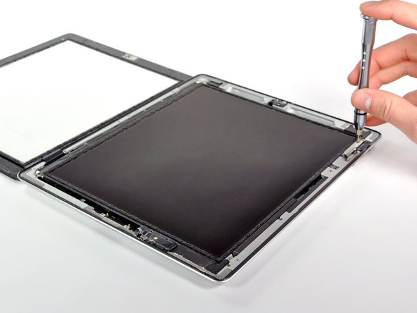

Image 1/2: The LCD is really easy to remove once the front panel is gone. Image 2/2: Only standard Phillips screws were used -- no Pentalobular or Tri-Wing funny-business.

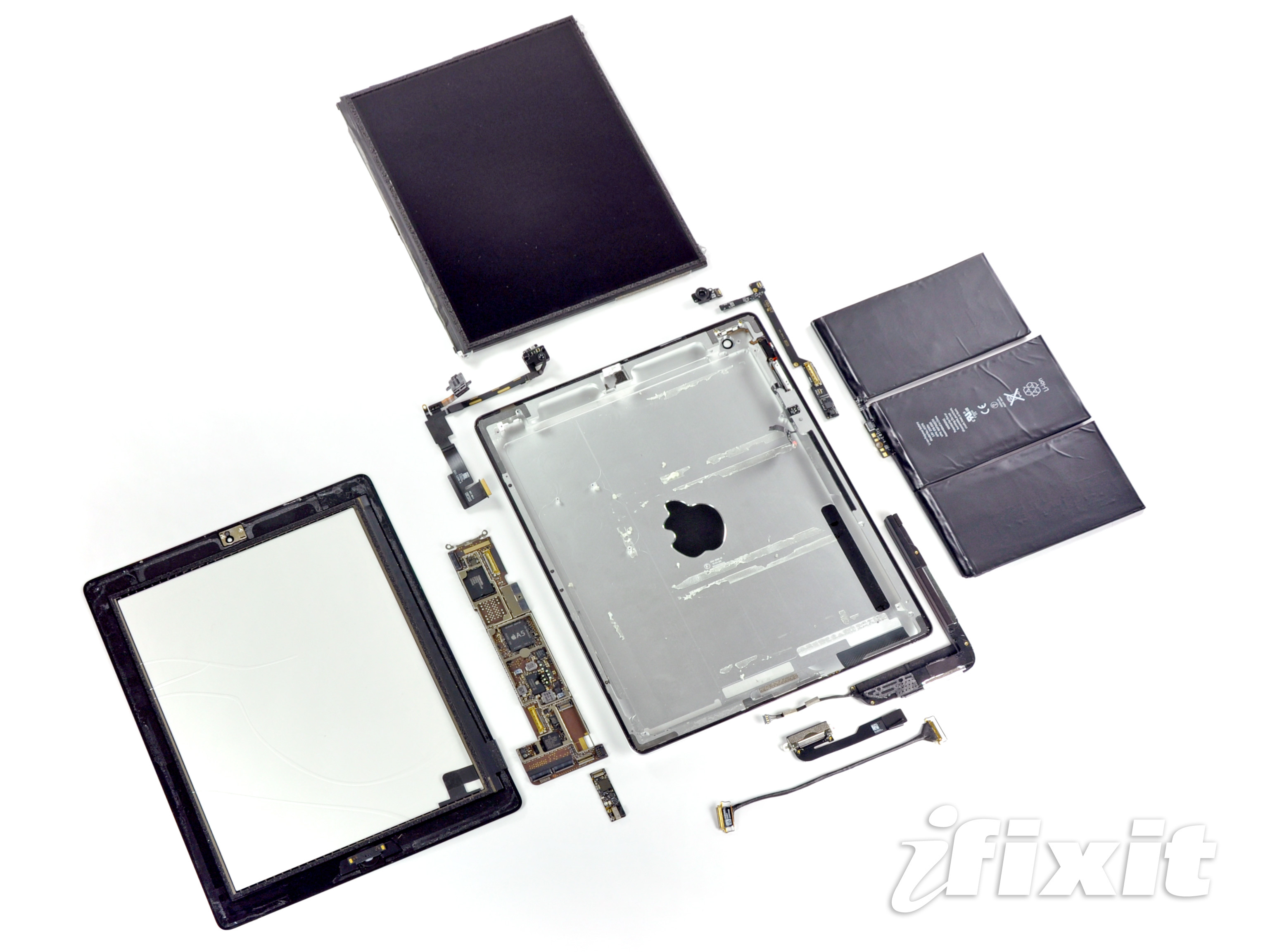

  • iPad 2 Repairability Score: 2 out of 10 (10 is easiest to repair)
  • The LCD is really easy to remove once the front panel is gone.
  • Only standard Phillips screws were used -- no Pentalobular or Tri-Wing funny-business.
  • The front panel is now glued to the rest of the device, greatly increasing the chances of cracking the glass when trying to remove it.
  • The LCD has foam sticky tape adhering it to the front panel, increasing chances of it being shattered during disassembly.
  • The battery is very securely stuck down to rear case, and you have to remove the logic board to remove it.
  • You can't access the front panel's connector until you remove the LCD.
  • Historical note: We initially awarded the iPad 2 a 4 out of 10, but in the process of writing our repair manual realized that it was far more difficult to repair than originally suspected.

Looks like the microphone is a Digital MEM mic from Analog Devices ADMP421
http://www.analog.com/en/mems/microphone...

Any update on how to safely remove the front cover?
