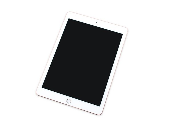

Image 1/2: Fully laminated, 9.7", LED-backlit, Oxide TFT "True Tone" display with 2048 x 1536 resolution (264 ppi) Image 2/2: 3rd generation 64-bit Apple A9X custom processor, with M9 motion coprocessor
  • Apple may have let all the Air out of the iPad line, but they didn't skimp on the 9.7" Pro's specs:
    • Fully laminated, 9.7", LED-backlit, Oxide TFT "True Tone" display with 2048 x 1536 resolution (264 ppi)

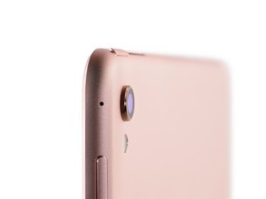

  • Of course, what sleek, new mobile offering out of Cupertino would be complete without the infamous camera bump?
    • This 1.1-millimeter mesa was absent from the 12.9" model, but probably necessary in this iteration due to the slightly shallower rear case and spec'd up 12 MP, 4K rear camera.
  • And, for the second time this week, the Rose Gold rear case shows off a new model number: A1673, and the usual regulatory markings.

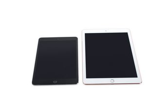

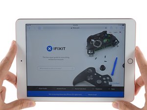

Image 1/3: Truly, in its entire history, there has never been a more Rose Gold iPad than this. Image 2/3: In all seriousness, it's refreshing to see a redesign that seems to focus on features rather than a nigh-pointless reduction in thickness, in a device that's already thinner than a pencil. Image 3/3: In all seriousness, it's refreshing to see a redesign that seems to focus on features rather than a nigh-pointless reduction in thickness, in a device that's already thinner than a pencil.
  • The whole iPad family is here! Left to right: Mini 3, Air 2, and iPad Pro 12.9".
  • Truly, in its entire history, there has never been a more Rose Gold iPad than this.
  • In all seriousness, it's refreshing to see a redesign that seems to focus on features rather than a nigh-pointless reduction in thickness, in a device that's already thinner than a pencil.

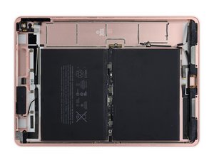

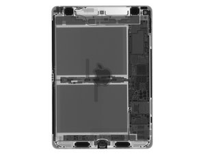

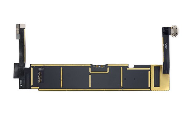

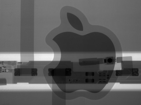

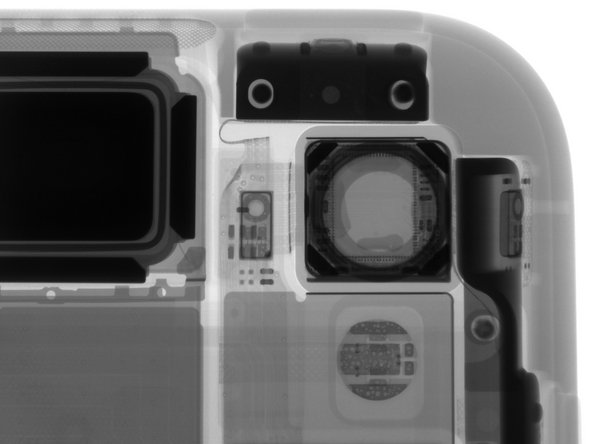

Image 1/3: We immediately note that where the larger iPad Pro's interior volume was [https://d3nevzfk7ii3be.cloudfront.net/igi/B1DvULfUBvWMPsMt|dominated by four huge speaker enclosures|new_window=true], this little guy uses a more conventional setup: the battery hogs most of the space, with the logic board on the side and the speakers squeezed in at the margins. Image 2/3: What's that weird strip of PCB running through the middle, though? Image 3/3: Time for a closer look. Let's open it up!
  • Our ingenious friends at Creative Electron sent us a sneak peek at the Pro 9.7's internals, X-ray style.
  • We immediately note that where the larger iPad Pro's interior volume was dominated by four huge speaker enclosures, this little guy uses a more conventional setup: the battery hogs most of the space, with the logic board on the side and the speakers squeezed in at the margins.
  • What's that weird strip of PCB running through the middle, though?
  • Time for a closer look. Let's open it up!

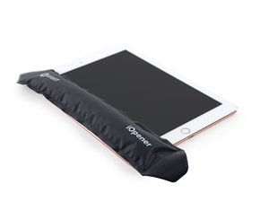

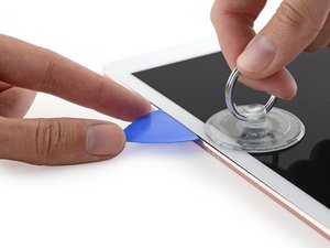

Image 1/3: Time to pick softly and hope we don't snag anything. Image 2/3: One day, perhaps, Apple will put its massive engineering prowess to work on the problem of how to make a tablet that opens for servicing—''without'' the nail-biting 30-minute process of heating, blind prying, and suctioning it currently demands. But it is not this day. Image 3/3: Having successfully carved the front panel free from its gluey frame, we get our first peek inside...

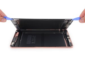

  • As we heat up the iOpeners, we place bets in the office pool: Where will the display cables be this time?
  • Time to pick softly and hope we don't snag anything.
    • One day, perhaps, Apple will put its massive engineering prowess to work on the problem of how to make a tablet that opens for servicing—without the nail-biting 30-minute process of heating, blind prying, and suctioning it currently demands. But it is not this day.
  • Having successfully carved the front panel free from its gluey frame, we get our first peek inside...

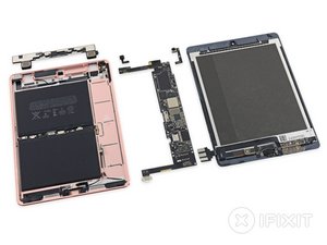

Image 1/2: We'd like to take a brief moment to mention that disassembly instructions are hugely important for successful repairs. We believe every user has the right to know how to safely work on their device. Image 2/2: The display, backed with some cushioning foam, also contains a ton of chips!
  • Survey says: Display cable's in the bottom right corner! That's a new configuration.
    • We'd like to take a brief moment to mention that disassembly instructions are hugely important for successful repairs. We believe every user has the right to know how to safely work on their device.

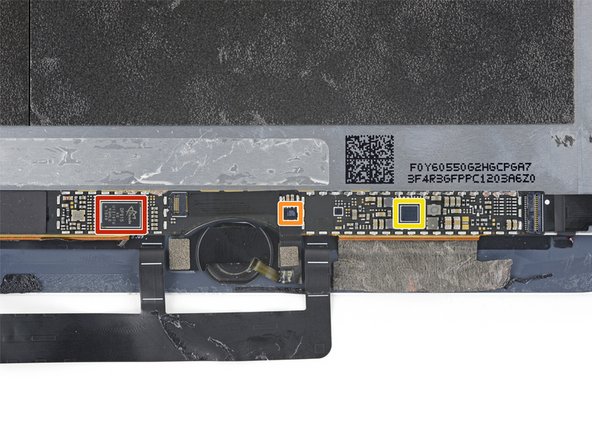

  • The display, backed with some cushioning foam, also contains a ton of chips!
    • Parade Technologies DP815 (likely an iteration of the DP695 timing controller found in the 12.9" Pro)
    • NXP Semiconductors 8416A1 Touch ID Sensor
    • 98667A B5528T

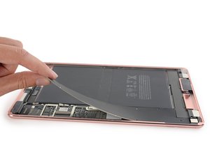

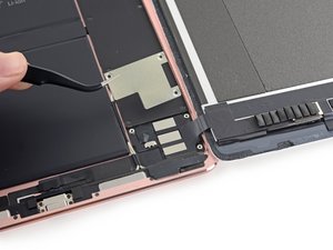

  • After popping a few screws, we remove a big slab of EMI shield covering the logic board.
    • We saw this same kind of shielding in the larger iPad Pro, but it didn't exist in the iPad Air line.
  • Our fingers are itching for chips, but for now we restrain ourselves and settle for isolating the battery. One precisely-placed pick separates the battery contacts from the logic board.
  • Next to come off is another shield covering the battery board, nestled between the two large battery cells.
    • There's some action in there, and bizarrely, a screw that seems to be holding the smart keyboard connector to the battery board.

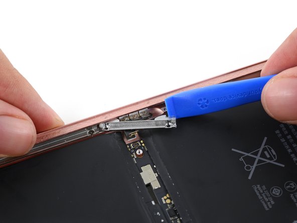

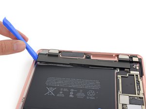

Image 1/2: They're really fiercely glued in, and screwed in, but it's nothing a plastic opening tool can't deal with. Image 2/2: Once we pop the speakers out for a closer look, we're rewarded for our hard work: they connect to the logic board with spring contacts!

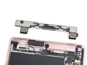

  • With shields and tape deftly dispatched, we turn our attention to the heavy hitters. First up: upper speakers!
  • They're really fiercely glued in, and screwed in, but it's nothing a plastic opening tool can't deal with.
    • Once we pop the speakers out for a closer look, we're rewarded for our hard work: they connect to the logic board with spring contacts!

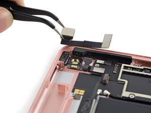

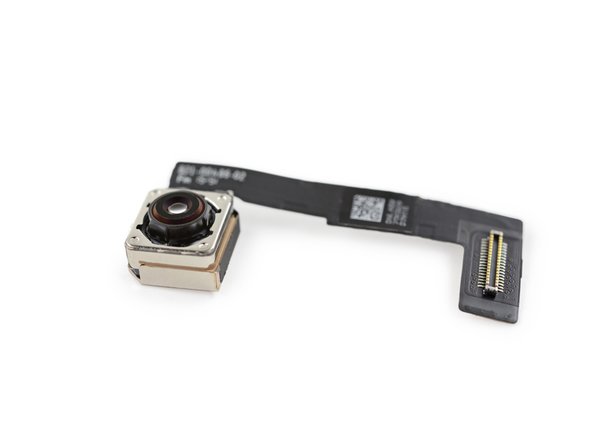

Image 1/2: And yup, that dimple goes all the way down, through the case down to the sapphire crystal lens cover. Image 2/2: Recently, there have been a number of consolidated hardware features in Apple's mobile lineup and this camera is no exception.
  • Out pops the perpetrator of that unsightly camera bump.
    • And yup, that dimple goes all the way down, through the case down to the sapphire crystal lens cover.
  • Recently, there have been a number of consolidated hardware features in Apple's mobile lineup and this camera is no exception.
    • It's the same 12 MP, 4K shooter featured in the 6s—a substantial upgrade over the 8 MP 1080p camera we dug up in our last Pro teardown.
    • We assume this will lead to nothing good.

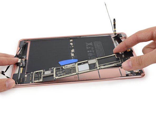

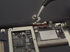

Image 1/2: A dab of glue fastens each connector in place, but they come free with a little gentle prying. Image 2/2: The boards themselves serve no obvious purpose; we can only speculate that their flat tops provide a little extra support for the display.
  • On our way to the logic board, we encounter some strange new antenna interconnect boards.
  • A dab of glue fastens each connector in place, but they come free with a little gentle prying.
  • The boards themselves serve no obvious purpose; we can only speculate that their flat tops provide a little extra support for the display.
    • Now that you'll be resting your palms on the glass while drawing with your Pencil, maybe a little reinforcement is called for.
  • Anyway, time to get a look at that logic board!

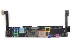

Image 1/2: Apple [https://chipworks.secure.force.com/catalog/ProductDetails?sku=APP-APL1021|APL1021|new_window=true] A9X 64-bit Processor Image 2/2: Samsung K3RG1G1 2 GB (16 Gb) LPDDR4 RAM
  • Chip chip hooray!
    • Apple APL1021 A9X 64-bit Processor
    • Samsung K3RG1G1 2 GB (16 Gb) LPDDR4 RAM
    • SK Hynix H23QEG8VG1ACA 32 GB (256 Gb) NAND Flash Memory
    • 2 × Broadcom BCM15900B0 (as seen in the iPad Pro 12.9")
    • Apple 339S00109 Wi-Fi Module
    • NXP 66V10 NFC Controller and 1610A3 Charging IC (as seen in iPhone SE/6s/6s Plus)
    • InvenSense EMS-A 6-axis Gyroscope and Accelerometer Combo (also found in iPhone SE)

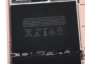

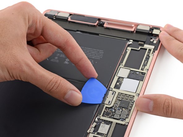

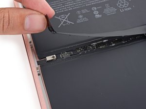

Image 1/3: Maybe next time Apple? Pretty please? Image 2/3: What the battery does contain is a rating of 3.82 V, 27.91 Whr, and 7,306 mAh, amounting to a 10-hour battery life claim. Image 3/3: As expected, that's quite a bit less than the 38.8 Whr capacity of the larger [https://www.ifixit.com/Teardown/iPad+Pro+Teardown/52599#s115509|new_window=true|iPad Pro]—but fractionally ''better'' than the [https://www.ifixit.com/Teardown/iPad+Air+2+Teardown/30592#s71659|iPad Air 2]'s 27.62 Whr. Still, all three models have roughly the same estimated battery life.
  • Unfortunately for repair-minded folks like ourselves, the battery contains none of those nifty adhesive pull tabs found in the larger iPad Pro (and in every iPhone since the 5s). So, removing it is a sticky affair.
    • Maybe next time Apple? Pretty please?
  • What the battery does contain is a rating of 3.82 V, 27.91 Whr, and 7,306 mAh, amounting to a 10-hour battery life claim.
    • As expected, that's quite a bit less than the 38.8 Whr capacity of the larger iPad Pro—but fractionally better than the iPad Air 2's 27.62 Whr. Still, all three models have roughly the same estimated battery life.
  • We're about to leave the case at that, but we try another poke at the Smart connector, hoping for an easier extraction than last time. No such luck.
Image 1/2: While not soldered in place, the battery is very solidly adhered—no more pull tabs like we saw in the larger iPad Pro 12.9" Image 2/2: The Smart Connector port is virtually impossible to replace—but incorporates no moving parts and is unlikely to fail.

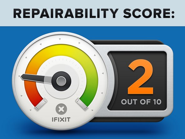

  • iPad Pro Repairability Score: 2 out of 10 (10 is easiest to repair)
    • While not soldered in place, the battery is very solidly adhered—no more pull tabs like we saw in the larger iPad Pro 12.9"
    • The Smart Connector port is virtually impossible to replace—but incorporates no moving parts and is unlikely to fail.
    • The LCD and front panel glass are fused together. This slightly simplifies the opening procedure.
    • The fused front panel increases the cost of screen repair, and the risk of damaging the LCD when opening.
    • Gobs of adhesive hold everything in place making all repairs more difficult.
