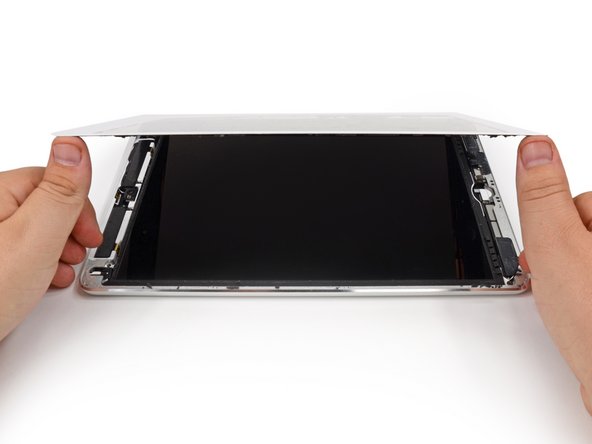

Image 1/3: As usual, Apple has secured the digitizer glass in place with more than ample amounts of adhesive. Image 2/3: Getting into this iPad is a bigger pain in the neck than a [http://en.wikipedia.org/wiki/My_Date_with_a_Vampire|date with a vampire]—but no amount of iPad blood can spook our stalwart [product|IF145-198-2|iOpener]. Image 3/3: Getting into this iPad is a bigger pain in the neck than a [http://en.wikipedia.org/wiki/My_Date_with_a_Vampire|date with a vampire]—but no amount of iPad blood can spook our stalwart [product|IF145-198-2|iOpener].
  • Trick or treat? How about we pull out our little bag of tricks and treat this iPad to some iOpening?
  • As usual, Apple has secured the digitizer glass in place with more than ample amounts of adhesive.
  • Getting into this iPad is a bigger pain in the neck than a date with a vampire—but no amount of iPad blood can spook our stalwart iOpener.

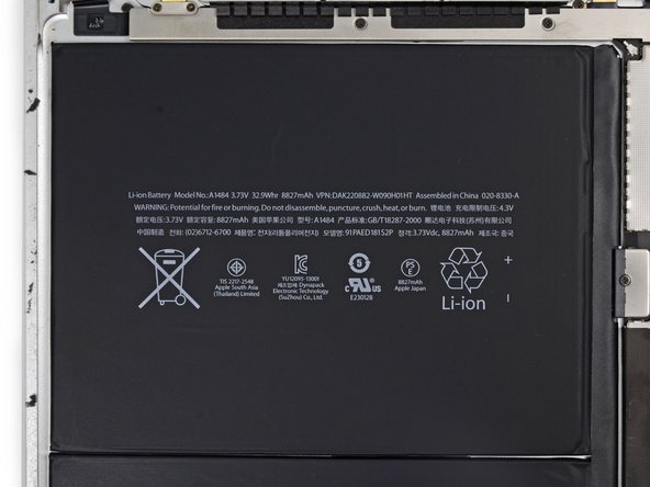

Image 1/2: The Air's 3.73 V, 32.9 WHr, two-cell power plant is decidedly less monstrous than the previous iPad's 43 WHr, three-cell behemoth. Image 2/2: Despite the iPad's skeletal slim-down Apple claims that, due to an increase in efficiency, you can still watch the [http://www.imdb.com/title/tt0060550/|Great Pumpkin] at least 20 times in a row.
  • The curtains go up, and it's a monster (battery) mash:
    • The Air's 3.73 V, 32.9 WHr, two-cell power plant is decidedly less monstrous than the previous iPad's 43 WHr, three-cell behemoth.
  • Despite the iPad's skeletal slim-down Apple claims that, due to an increase in efficiency, you can still watch the Great Pumpkin at least 20 times in a row.
  • Ogle all you want, but this battery isn't coming out…yet.

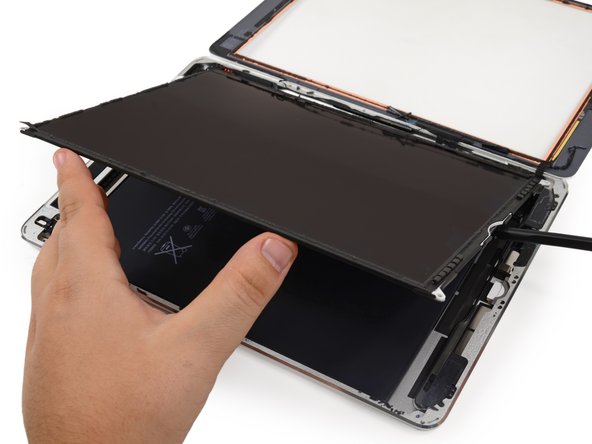

Image 1/3: Our display, model LP097QX2, was supplied by LG. Image 2/3: The LCD remains separate from the front panel glass. Is there a spirit of repairability lurking in this otherwise dauntingly difficult device? Image 3/3: The LCD remains separate from the front panel glass. Is there a spirit of repairability lurking in this otherwise dauntingly difficult device?
  • The 9.7" display's specs remain unchanged from the iPad's previous outing, but Apple claims an uncanny 20% reduction in panel thickness.
    • Our display, model LP097QX2, was supplied by LG.
  • The LCD remains separate from the front panel glass. Is there a spirit of repairability lurking in this otherwise dauntingly difficult device?

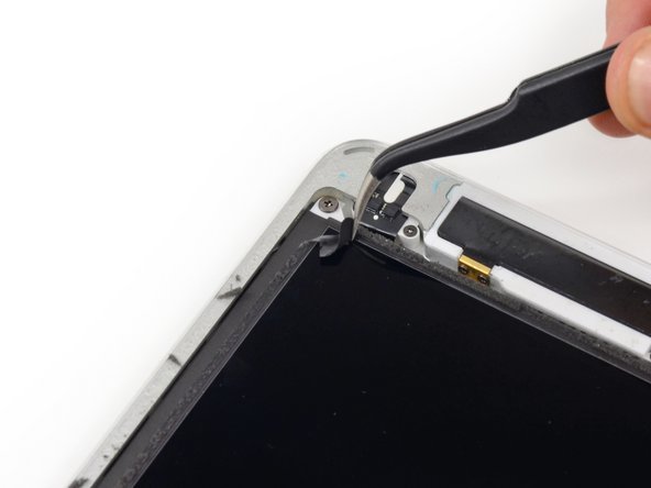

Image 1/2: Despite the new cable dressing up this home button, Apple's Touch ID fingerprint sensor is nowhere to be found; it remains exclusive to the [guide|17383|iPhone 5s|stepid=52337]…for now. Image 2/2: Despite the new cable dressing up this home button, Apple's Touch ID fingerprint sensor is nowhere to be found; it remains exclusive to the [guide|17383|iPhone 5s|stepid=52337]…for now.
  • Is it a window to the underworld or a digitizer/front glass assembly? Probably the latter, but we're not taking any chances; we set it gingerly aside.
  • Despite the new cable dressing up this home button, Apple's Touch ID fingerprint sensor is nowhere to be found; it remains exclusive to the iPhone 5s…for now.

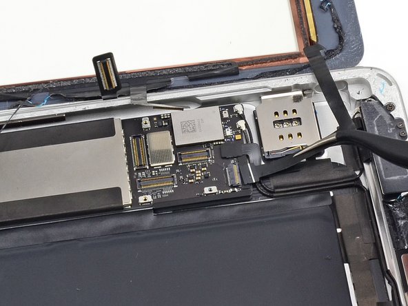

Image 1/2: Spring contacts on the logic board clamp down on the corresponding tab on the battery, effectively trapping it and complicating any future repair. Image 2/2: This battery is super frustrating; we're not [http://static.fjcdn.com/pictures/Wordception_79a4ff_2341386.jpg|Li-ion.]
  • We resume the quest to liberate the battery, and under the logic board we find the culprit in the curious case of the trapped time bomb (commonly known as a battery).
  • Spring contacts on the logic board clamp down on the corresponding tab on the battery, effectively trapping it and complicating any future repair.
  • This battery is super frustrating; we're not Li-ion.

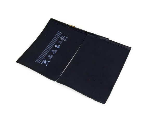

Image 1/3: In the process, the battery warps to a state resembling the Grimm Reaper's scythe. Image 2/3: Warped batteries scare the living daylights out of us. [http://d3nevzfk7ii3be.cloudfront.net/igi/35qYQCnBOHgYyids|Bad things|new_window=true] happen when batteries get punctured. Image 3/3: Warped batteries scare the living daylights out of us. [http://d3nevzfk7ii3be.cloudfront.net/igi/35qYQCnBOHgYyids|Bad things|new_window=true] happen when batteries get punctured.
  • This battery creaks worse than the door to a haunted mansion as we ease it out of the case.
  • In the process, the battery warps to a state resembling the Grimm Reaper's scythe.
  • Warped batteries scare the living daylights out of us. Bad things happen when batteries get punctured.

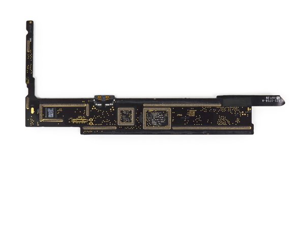

Image 1/3: Apple APL5698 A7 Processor—a slightly different version from the APL0698 in the [guide|17383|iPhone 5s|stepid=52346] Image 2/3: Elpida F8164A1MD 1 GB LPDDR3 SDRAM Image 3/3: Toshiba THGBX2G7B2JLA01 16 GB NAND Flash
  • We leave the boring backside in favor of the green PCB fields of the front. Planted in this logic board patch are:
  • Apple APL5698 A7 Processor—a slightly different version from the APL0698 in the iPhone 5s
  • Elpida F8164A1MD 1 GB LPDDR3 SDRAM
  • Toshiba THGBX2G7B2JLA01 16 GB NAND Flash
  • NXP LPC18A1 (Apple M7 Motion Co-Processor)
  • Apple 343S0655-A1—from our friends at Chipworks, this looks to be a Dialog Power Management IC
  • USI 339S0213 Wi-Fi Module
  • Apple 338S1116 Cirrus Audio Codec, also found in the iPhone 5c

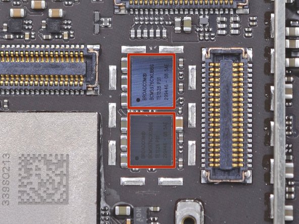

Image 1/3: ...Reveals a pair of Broadcom BCM5976C1KUB6G Touch Screen Controllers, similar to the [https://chipworks.secure.force.com/catalog/ProductDetails?sku=BRO-BCM5976A0KUB2G&viewState=DetailView&cartID=&g=&parentCategory=&navigationStr=CatalogSearchInc&searchText=BCM5976|BCM5976A0KUB2G] found in the trackpads of various MacBooks. Image 2/3: While we're in the thick of chip identification, we want to send a big shoutout of thanks to our friends at [http://www.chipworks.com/|Chipworks], who stayed up late tonight to help us pick out all the teeny tiny components. Image 3/3: While we're in the thick of chip identification, we want to send a big shoutout of thanks to our friends at [http://www.chipworks.com/|Chipworks], who stayed up late tonight to help us pick out all the teeny tiny components.
  • A quick peek under a sneaky EMI shield near the USI Wi-Fi module...
  • ...Reveals a pair of Broadcom BCM5976C1KUB6G Touch Screen Controllers, similar to the BCM5976A0KUB2G found in the trackpads of various MacBooks.
  • While we're in the thick of chip identification, we want to send a big shoutout of thanks to our friends at Chipworks, who stayed up late tonight to help us pick out all the teeny tiny components.

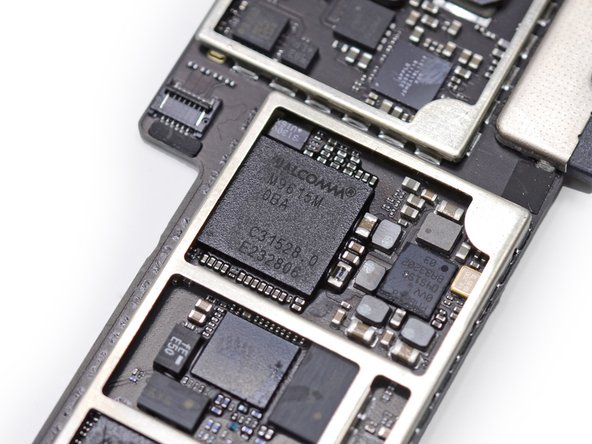

Image 1/2: Qualcomm [https://chipworks.secure.force.com/catalog/ProductDetails?sku=QUA-MDM9615M&viewState=DetailView&cartID=&g=/|M9615M] LTE Processor with 1 Gb (128 MB) of DRAM Image 2/2: TriQuint TQF6514 RF Power Amplifier Module—similar to the 6414 in the iPhone 5s
  • It wouldn't be an oversized iPhone without the phone parts—this end of the logic board sports all of the RF components.
  • Qualcomm M9615M LTE Processor with 1 Gb (128 MB) of DRAM
  • TriQuint TQF6514 RF Power Amplifier Module—similar to the 6414 in the iPhone 5s
  • Three Skyworks SKY77-series LTE RF Power Amplifier/Duplexer Modules
  • Two Avago A79-series LTE RF Power Amplifier/Duplexer Modules
  • 227 LG—likely a Murata Antenna Switch/Filter Module
  • Qualcomm WTR1605L LTE/HSPA+/CDMA/EDGE/GPS Transceiver
  • Qualcomm PM8018 PMIC

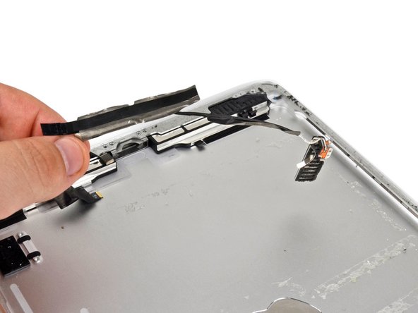

Image 1/2: Before the thunder even rolls, the Lightning port is gone. Image 2/2: On a roll of our own, we remove what appear to be the Wi-Fi and Bluetooth antennas from the rear case.
  • Just when we think there's no hope for this werewolf of a device, it shows its human face. Finally, a modular part: the Lightning connector. (Not that it was easy to get to.)
  • Before the thunder even rolls, the Lightning port is gone.
  • On a roll of our own, we remove what appear to be the Wi-Fi and Bluetooth antennas from the rear case.
    • With two antennas and the use of MIMO technology, iPad touts twice the Wi-Fi performance of past models.

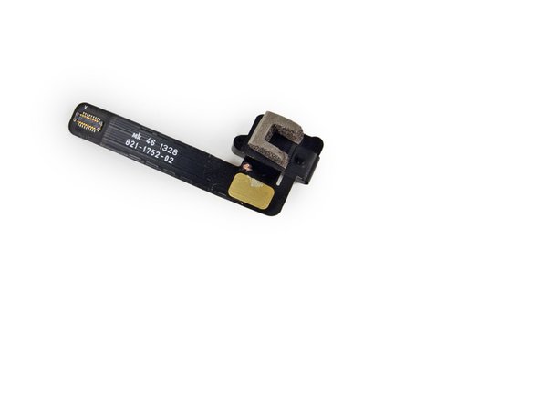

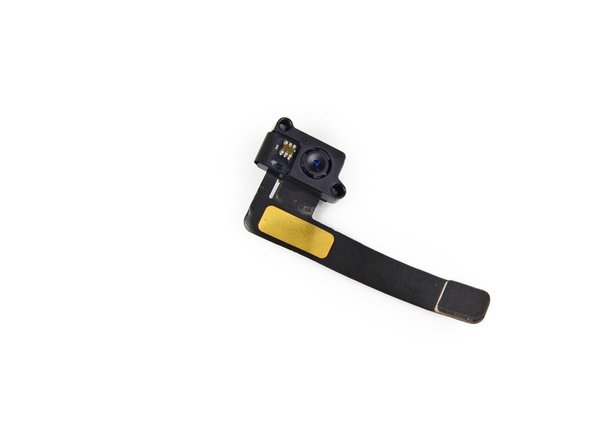

Image 1/3: Ho, hum: The 1.2-megapixel, 720p FaceTime camera fails to send any shivers down our spine. Image 2/3: Ho, hum: The 1.2-megapixel, 720p FaceTime camera fails to send any shivers down our spine. Image 3/3: Ho, hum: The 1.2-megapixel, 720p FaceTime camera fails to send any shivers down our spine.
  • For our next trick, we magic away the front-facing camera. You'll have to take your costume pics the old fashioned way.
  • Ho, hum: The 1.2-megapixel, 720p FaceTime camera fails to send any shivers down our spine.

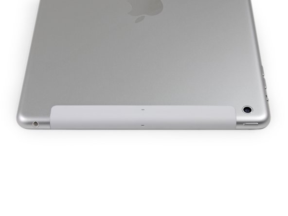

    • Catch these cell antennas while you can—you won't find them in the strictly Wi-Fi version. They're a huge phone exclusive.

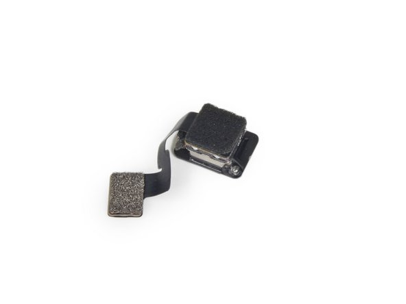

    • A quick 180º, and the speakers become our next victim. Shrouded in mystery, Apple calls these speakers "built-in," opting to leave the maker unspecified.

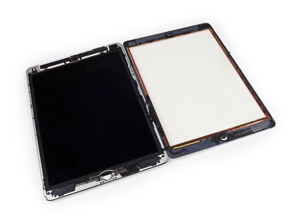

Image 1/2: The LCD is easy to remove once the front panel is taken off the iPad. Image 2/2: The battery is not soldered to the logic board. We'll give it that.
  • iPad Air Repairability Score: 2 out of 10 (10 is easiest to repair)
