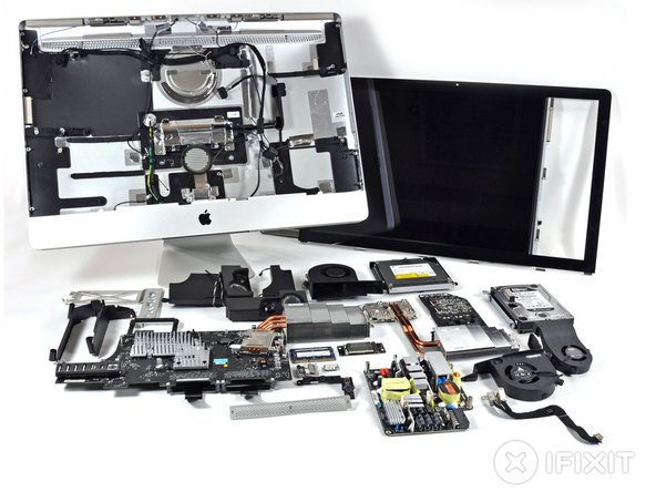

We're doing a teardown of the newest (and largest) iMac in Apple's line-up -- the 27" Intel iMac! We disassembled this iMac on October 21, 2009.
Want up-to-the-minute updates? Follow @ifixit on twitter.
Check out the super-fast video slideshow of the teardown! It has banjo music!
This teardown is not a repair guide. To repair your iMac Intel 27" EMC 2309 and 2374, use our service manual.

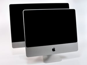

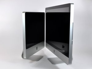

Image 1/2: The new iMac dwarfs the [guide|658|20" iMac] we took apart earlier this year. Image 2/2: The most obvious feature of this new iMac is the new 27" LED backlit display. The display boasts a 2560x1440 resolution, 16x9 full HD.
  • We spared no expense to bring you the latest and greatest. We have in our studio the biggest iMac money can buy.
  • The new iMac dwarfs the 20" iMac we took apart earlier this year.
  • The most obvious feature of this new iMac is the new 27" LED backlit display. The display boasts a 2560x1440 resolution, 16x9 full HD.
  • Also in the box is a brand new Magic Mouse. We already tore it apart.
  • Most of Apple's promotional photos show the iMac both running and sans power cord. It looks a lot nicer that way, but unfortunately our unit required the power cord before it would turn on.

Hi brothers,
On your pictures, is it a 24" faicng the 27.1" ?
SuperTiti - Reply

Quote from SuperTiti:
Hi brothers,
The comparison shots show a 20" Early 2009 iMac next to the new 27" iMac.
Luke Soules - Reply
Quote from luke:
Thanks ! So, as an owner of a 24" I think a 27" won't be that great change I was expecting...
SuperTiti - Reply

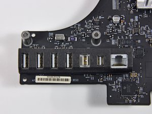

Image 1/1: This iMac sports a cool new feature that allows you to display video from external sources on the internal display. Apparently, that's to hook up your Blu-ray player externally since the machine '''still''' doesn't include an internal Blu-ray drive.
  • Nine ports. These are identical to the previous revision, but the Mini DisplayPort has a new trick up its sleeve.
  • This iMac sports a cool new feature that allows you to display video from external sources on the internal display. Apparently, that's to hook up your Blu-ray player externally since the machine still doesn't include an internal Blu-ray drive.
  • Unfortunately, this feature requires an adapter. Where is the adapter? Not in the box. The manual says "Required cables and adapters are sold separately" Not that we're surprised, all you get in the way of cables is a power cable. Yes, Apple thinks cables are from the devil.
Why is the 21.5" iMac does not have video-in capabilities? What is the difference in those two MotherBoards?
Vrumm - Reply

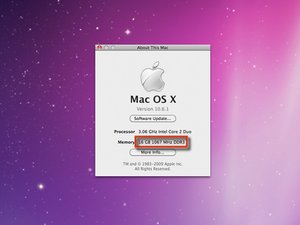

Image 1/1:

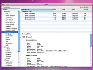

  • Like earlier iMacs, the RAM slots are hidden beneath an access door at the bottom of the iMac. A Phillips #2 screwdriver makes quick work of the three screws.
What is the stock configuration of DIMMS? 4x1GB? 2x2GB?
PhotoTim - Reply
Quote from PhotoTim:
This iMac came with 2x2GB chips.
Luke Soules - Reply
Is this the complete step for accessing the RAM space to add more RAM? (I plan to add 2x2GB more.) That is, just open the access door and there it is?
dano3006 - Reply
Quote from dano3006:
Yup, just remove the access door and pull the black plastic strip attached to each RAM tray away from the bottom edge of the iMac to eject the chips.
Andrew Bookholt - Reply

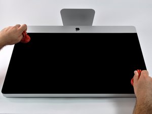

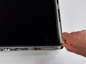

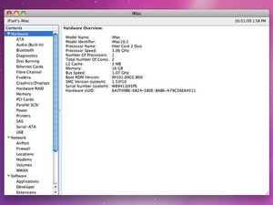

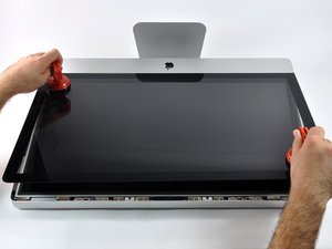

Image 1/3: Naturally, we just had to see for ourselves. Apple's not kidding, if you have the cash, you really can have 16 GB of RAM in your iMac! 16 GB will set you back $1,400 from Apple, or $400 [product|IF111-036|from us]. Image 2/3: Naturally, we just had to see for ourselves. Apple's not kidding, if you have the cash, you really can have 16 GB of RAM in your iMac! 16 GB will set you back $1,400 from Apple, or $400 [product|IF111-036|from us]. Image 3/3: Naturally, we just had to see for ourselves. Apple's not kidding, if you have the cash, you really can have 16 GB of RAM in your iMac! 16 GB will set you back $1,400 from Apple, or $400 [product|IF111-036|from us].
  • You can now install a whopping 16 GB of RAM in your iMac! In a very welcome move, Apple doubled the number of slots, enabling you to install four 4 GB PC3-8500 chips.
  • Naturally, we just had to see for ourselves. Apple's not kidding, if you have the cash, you really can have 16 GB of RAM in your iMac! 16 GB will set you back $1,400 from Apple, or $400 from us.
  • The new iMac features an edge-to-edge glass. This is different from the 4 mm aluminum bezel that surrounded the glass on the previous iMac. Hopefully Apple's got some pretty strong magnets to keep the glass where it belongs. After upgrading the RAM in our iMac, we noticed the glass was slightly out of alignment on one side.
  • Two suction cups, two steady hands, and the enormous glass panel lifts up.
  • Hopefully you're not following along at home, as this can be a little tricky. If you do have an older iMac that needs surgery, we now have detailed repair guides for many iMac models.
Could we replace the original edge-to-edge glass for a Multi-Touch model?!?! Would it be a possible mockup?!?! It would be very nice in Business Shows to present de digital leaflet and keynotes. And at home to be just set it as enormous "tablet". the point is how to make it for a low price?
Vrumm - Reply
hi!
how is the glas mounted on the enclosure? only by magnets? is it real glas or perspex? thanks for your answer!
Robert
robert - Reply
Hi can you describe better how the glass attaches to the frame. Is the black border on the glass metallic so it can be supported by the magnets. Thanks.
Zoom - Reply
Quote from robert:
hi!
Robert
Im pretty sure its real glass and yes it is only held in place by magnets
AussieMac - Reply
I own a 27" iMac that has this edge-to-edge glass broken at left side.
Monitor is still intact. I cant exactly understand how to remove this surrounding glass.
Do i need to use the suction cups on the surrounding glass so to remove it from the magnets? Cause on the photo the cups are placed on the Monitor..
Thanks
gUrU - Reply
Quote from gUrU:
Thanks
There have been a number of reports on the Apple forums of the glass being broken on the bottom left side. If you have an Apple store nearby, you can ask them to replace the glass (they will have to get the replacement glass shipped to the store), otherwise call Apple support to obtain a replacement machine.
dotm8rix - Reply
Quote from gUrU:
Thanks
Actually, in both photos the suction cups are attached to the glass. The display is recessed about .125" below the glass panel, and the two components are not connected. To remove the glass, lay your iMac stand-side down on a table. Stick two suction cups along the top edge of the glass and pull it away from the rear case of the iMac. Rotate the top edge of the glass panel slightly away from the rear case of the iMac to clear the mounting pins, then slide the glass toward the top edge of the iMac to free the flat tabs along its lower edge.

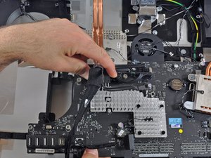

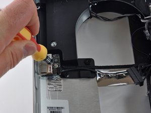

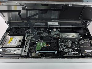

Image 1/3: After the screws are free, pivoting the LCD assembly yields the first glimpse of the treasures that lie beneath. Image 2/3: Before you can lift up the LCD, carefully disconnect the vertical sync cable from the logic board. Image 3/3: Before you can lift up the LCD, carefully disconnect the vertical sync cable from the logic board.
  • The LCD panel is held in place with eight T10 Torx screws.
  • After the screws are free, pivoting the LCD assembly yields the first glimpse of the treasures that lie beneath.
  • Before you can lift up the LCD, carefully disconnect the vertical sync cable from the logic board.
I think I have break the sync cable... Can anyone tell me what will be the effect of it? Thanks.
Antonio - Reply
Strangely I found that reinstalling the 8 screws to keep the LCD panel in place my T-10 torx kept demagnetizing. (I only have a slight magnetization in place to keep the screws from falling inside)
mark - Reply

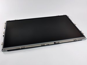

Image 1/2: The resolution is a very impressive 2560x1440. That's the same horizontal resolution as a 30" Apple Cinema Display! Image 2/2: This display uses In-plane switching (IPS) technology, providing a wider viewing angle and better color reproduction than cheaper Twisted nematic (TN) technology.
  • The LG manufactured LCD panel weighs in at nearly 11 lbs! Then again, it is a massive 27" beauty.
  • The resolution is a very impressive 2560x1440. That's the same horizontal resolution as a 30" Apple Cinema Display!
  • This display uses In-plane switching (IPS) technology, providing a wider viewing angle and better color reproduction than cheaper Twisted nematic (TN) technology.
  • The panel is very glossy. It's great for spying on those behind you, as well as watching movies.
  • It appears to be model number LM270WQ1. A Google search of that model currently yields five results, and only one of those is in English.
Please tell me that display is matte?!!
Toushi - Reply
Quote from Toushi:
Definitely not. It's quite shiny, in fact.
Kyle Wiens - Reply

LED Display - is it RGB LED? Is it side lit or back lit?
wkchan - Reply
Quote from wkchan:
RGB LCD with LED backlight. It is not an OLED display, which is a common source of confusion (OLED vs LCD, LED backlight vs CCFL).
Diggsby - Reply
Quote from Diggsby:
Hmmm ... my origin question was not too clear.
I meant to ask:
1. if the LED backlight uses "RGB/tri-color" LEDs or just "white" LEDs (as in the MacBooks).
2. if the LED backlight on the edge of the display or the back of the display.
LG makes a 1920x1200 17.1" LCD panel, LGD01b3, with RGB LED backlight, edge-lit. The LGD01b3 display has a wide color gamut, high contrast with vivid colors but suffers from non-even backlight color (I call it "wild gamut" because I can never get the color profiling right).
Cannot find any info on this LM270WQ1 LCD panel and was hoping that the Teardown guys can tell if the backlight uses RGB LEDs and if the panel was edge-lit.
This LCD panel is IPS and if it also uses RGB LED, then the iMac 27" is really a price break through!
But on second thought, went through the specs and never see "wide gamut" being mentioned -- so likely at this price point, it is likely just a white-LED backlight.
wkchan - Reply

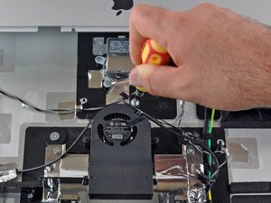

Image 1/1: There are four cables that connect the LCD to the iMac:
  • This isn't nearly as pretty as the front, but there's some things worth noting here.
  • There are four cables that connect the LCD to the iMac:
    • DisplayPort
    • Temperature sensor
    • LED backlight
    • LED backlight sync
  • The key thing to note is that there's no special shortcut from the LCD to the external Mini DisplayPort connector. The signal will need to go through the logic board, so you'll need to have your iMac powered on if you want to display from an external video source.
Re: Mini DisplayPort, you write:
This means "powered on and running OSX", right?
So, this iMac won't become a decent second display if the logic board goes south, or after quad 2.66GHzs are no longer "fast enough" to read email on?

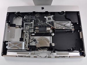

Image 1/1: Notice how the stand is pivoted fully upward. Without the added weight of the LCD panel, there's not nearly enough force against the spring to maintain the normal neutral buoyancy.
  • Ever wonder what was behind that monolithic black display? Here you go: 27" of display-less iMac. (Actually, we're pretty sure the 27" measurement is completely meaningless now that the display is gone.)
  • Notice how the stand is pivoted fully upward. Without the added weight of the LCD panel, there's not nearly enough force against the spring to maintain the normal neutral buoyancy.
  • The hard drive occupies the center of the unit, while the optical drive and fan are clearly visible on the right.
With a bit of work, that would make a great desktop image

So how many fans does this iMac have? The final image with the parts arranged neatly looks like it has three.
doctordon - Reply
Quote from doctordon:
Yes, there's three fans total. One for the CPU, one for hard drive, and one near the optical drive.

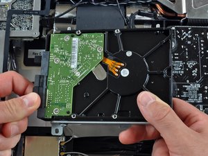

Image 1/2: Once they're removed, the hard drive easily pivots up and out of the system. Image 2/2: The 27" iMac ships with a 1TB 7200-rpm Serial ATA hard drive (Apple offers an optional 2TB drive for an additional $250).
  • Two T10 Torx screws hold the hard drive in place.
  • Once they're removed, the hard drive easily pivots up and out of the system.
  • The 27" iMac ships with a 1TB 7200-rpm Serial ATA hard drive (Apple offers an optional 2TB drive for an additional $250).
  • There isn't really room in here for a second drive, but you could certainly swap this one out yourself. You could hypothetically install an SSD, but this seems like such a good a media computer that it would be a shame to limit it to current SSD capacities.
  • This + that = easy Time Machine internal backup!
You say that there isn't room for another drive; does that also go for 2.5" SSDs? Are there extra SATA ports on the logic board for more than the single drive anyway?
CrimsonS - Reply
Quote from CrimsonS:
You could fairly easily replace the optical drive with a 2.5" hard drive or SSD. We sell an enclosure that enables you to install a SATA drive instead of the optical drive. There are no extra available internal ports that we noticed.
Luke Soules - Reply
Hi Luke,
To confirm, this enclosure is compatible with the latest Quad-Core i7 27" iMac, correct? Also, do you know of any external enclosures where I could use the superdrive once removed? Or can you recommend an external DVD burner to purchase as a replacement once the internal one has been replaced by an SSD drive?
bradwill -
If i install a SSD instead of the optical drive, could i boot up OSX from the SSD and use the internal 3,5 HDD for media Stuff?
Quote from luke:
cocoJim - Reply
Quote from cocoJim:
That should work just fine. You would just select the SSD in Startup Disk as soon as you get the drive in there with OS X installed.
Joe - Reply
What model WD 1TB is this one? the Caviar Black or the RE4 model?
franquinet - Reply
Quote from joe:
There should be a 3.5" drive with both an SSD and a high capacity HDD on it (dual SATA). The SSD wouldn't need to be that big, say 32 or 64GB , since the most active files and swap space would reside there. I guess it would only apply to the iMac though.
Given how much the SSD in my MBP has sped things up, I almost feel installing an SSD in a new iMac is a necessity.
MatTrue - Reply
You would have to downgrade the internal Hard Disk to less than the size of the optical bay HD or use the optical bay HD as the boot drive for Time Machine backups.
The Time Machine backup disk must always be larger than the disk it backs up from, AFAIR.
TonyWong - Reply
Quote from TonyWong:
Nope, you can choose what you backup, and if it fits, it'll do it.
Magneto - Reply
Which 1TB hard drive is used - is it the Hitachi?
And I wonder which drive they've chosen for the 2TB option?
string - Reply
You can maybe use SATA port multiplier and, from photos, I would say that there is enough space for 2,5" SSD behind GPU heat-pipes ? right ? (although maybe it is not best idea to put SSD close to heatpipes :D)
kovacm - Reply
Quote from franquinet:
It's a Caviar Black, model WD1001FALS.
Luke Soules - Reply

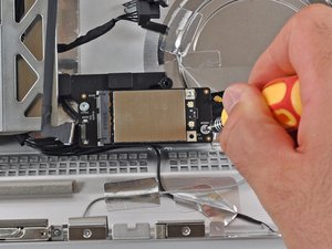

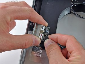

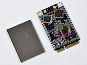

  • Disconnecting antennas and removing the AirPort Card.
  • A single T6 Torx screw secures the standard PCI-e wireless board to the custom board it's mounted on.
  • Even after removing the silver EMI shield, it's challenging to read the main Wi-fi chip. It's an Atheros AR9280.
  • The two identical chips near the antenna connectors are SiGe Semiconductor 2593A20 power amplifiers.

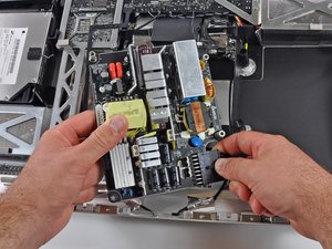

Image 1/3: The power supply is out. Image 2/3: Oooh, pretty colors! Image 3/3: Both the blue and red parts are capacitors. Unfortunately they didn't have enough markings on them for us to identify their capacitance.
  • A few screws later, and....
  • The power supply is out.
    • Oooh, pretty colors!
    • Both the blue and red parts are capacitors. Unfortunately they didn't have enough markings on them for us to identify their capacitance.
    • Their Capacitance is 27.5 for both reds, the one blue against the board is 15, and the other two visible blue ones are 20. (all in micro-farads)
  • The power supply puts out 25.8 amps at 12 volts, for a total output of 310 watts. That's the biggest power supply we've seen in an iMac.
The tech specs for the 27" iMac say it can be up to 365W, so I suspect the Quad Core variant has an even larger power supply.
djfriar - Reply
Quote from djfriar:
I think Apple may be talking input power, while we're talking output. An input of 365 watts and output of 310 watts is 85% efficiency, which is typical for a good power supply.
Luke Soules - Reply
Quote from luke:
And I learn something new from this site yet again. :)
djfriar - Reply
Whatinhell is the second board by the PS? It's definitely something not seen before.
NikkiWraith - Reply
Quote from NikkiWraith:
I believe that's the backlight board for the display.
Ben Eisenman - Reply
Image 1/1: The board is one of the few components held in place by a T8 (as opposed to T10) Torx screw.
  • The Bluetooth board is in the corner of the computer, grounded to the case. We began the removal procedure by disconnecting the blue antenna cable.
  • The board is one of the few components held in place by a T8 (as opposed to T10) Torx screw.

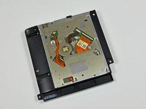

Image 1/3: The fact that there is no Blu-ray drive in here is a [link|http://www.google.com/search?client=safari&rls=en&q=bag+of+hurt&ie=UTF-8&oe=UTF-8|bag of hurt]. Image 2/3: C'mon Apple, iMacs in 2005 had 8x SuperDrives. The SuperDrive just doesn't seem so super anymore. Image 3/3: The good news is, it's a standard 12.7 mm, slimline SATA optical drive. The drive Apple should have included is this [link|http://www.panasonic.com/industrial/optical-drives/blu-ray-disc-drives/uj-135a.aspx|Panasonic UJ-135 Blu-ray drive].

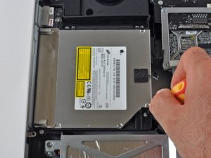

  • This may be the most underwhelming component in this iMac, the 8x SuperDrive.
  • The fact that there is no Blu-ray drive in here is a bag of hurt.
  • C'mon Apple, iMacs in 2005 had 8x SuperDrives. The SuperDrive just doesn't seem so super anymore.
  • The good news is, it's a standard 12.7 mm, slimline SATA optical drive. The drive Apple should have included is this Panasonic UJ-135 Blu-ray drive.
  • Apple lacks software support for playing copy-protected Blu-ray movies, so if you install a Blu-ray drive, you'll have to boot into Windows to enjoy the show.
Are there any slot loading blu-ray drives we can replace this with?
Toushi - Reply
Quote from Toushi:
Yup, the Panasonic UJ-135-A will work just fine.
Kyle Wiens - Reply
Quote from kyle:

Blu-ray display 1080p. What is the experience indeed of watching a movie with that black bar tags? And wait I am not considering here in "FullScreen" Youtube, mobile DTV, iTunes Movies and DVD "Super" Drive. All of that might seems very "distorted" by the 2560x1440 resolution. The ATI will have to work a lot to upscale all of this.
Vrumm - Reply
Quote from Toushi:
A stand alone Blu-ray might be in the works, similar to the external usb/firewire devices for the MacBook Air.
Built in, they really are a "bag of hurt", as Steve pointed out.
BobForsberg - Reply

Quote from kyle:
The web site says 12.7 mm while the original drive says 12.5 mm. Small difference, but could be a problem closing the case or aligning the disc in the slot.
BradMacPro - Reply
Quote from BradMacPro:
I think they were just a bit lazy with the measurements here.. look at the image of the superdrive and google the code. I'm pretty sure that it is actualy a 12.7, not .5 (i've NEVER seen a 12.5 drive.. anywhere), so it will be a perfect fit.
I recommend the UJ-235A over the 135 they mention in the article too, as it can burn blu-ray discs at 4x.
iTems - Reply
Quote from iTems:
iTems, you're right, that's a typo. It is indeed a 12.7mm drive, so there's no difference between the SuperDrive and Panasonic's slim Blu-ray drives. If you want to burn Blu-ray (and have a bigger budget), the UJ-235 drive should work fine as well.
Luke Soules - Reply
Hey Luke,
Just installed Panasonic's UJ-235A into my mid 2010 27" iMac & it accepted a disc but that's all it's doing. Clicking 'About this Mac' then 'More Info' & the drive is detected - OS X recognises it & lists all its capabilities but can't see it in Finder, VLC or any other program. The keyboard eject button doesn't work. Tried getting the disc out using the 'drutil eject' command. The drive makes a noise like it's going to eject, but doesn't.
Have you, or anyone else, installed this drive & had any luck using it.
Any suggestions would appreciated.
Thanks! Paul
Paul Rossi -

Image 1/2: Image 2/2:
  • Apple made good use of the extra available space to include large, quiet fans with lots of low speed blades.

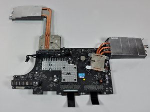

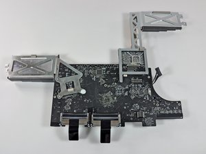

Image 1/2: Notice how far apart the GPU and CPU are, and how they have separate heat sinks leading to opposite sides of the computer. This rather complex thermal engineering work allowed Apple to upgrade the iMac to use Intel's desktop processors. Image 2/2: Notice how far apart the GPU and CPU are, and how they have separate heat sinks leading to opposite sides of the computer. This rather complex thermal engineering work allowed Apple to upgrade the iMac to use Intel's desktop processors.

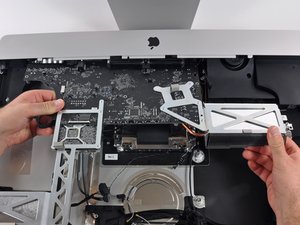

  • Removing the massive logic board requires two hands. With the RAM cavity opened underneath the iMac try to help pushing the logic board with the thumb towards the upper part (towards the isight camera), to ease the release of the logic board.
  • Notice how far apart the GPU and CPU are, and how they have separate heat sinks leading to opposite sides of the computer. This rather complex thermal engineering work allowed Apple to upgrade the iMac to use Intel's desktop processors.

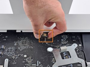

Image 1/2: In the second picture we are removing the central wiring harness and lifting out the logic board. Image 2/2: This computer has more linear feet of wire than any iMac we've ever taken apart.
  • Removing the Infrared (IR) sensor needed to use the Apple remote.
  • In the second picture we are removing the central wiring harness and lifting out the logic board.
  • This computer has more linear feet of wire than any iMac we've ever taken apart.

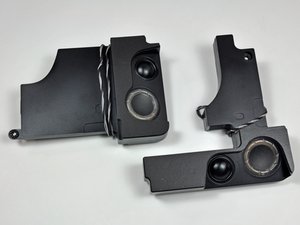

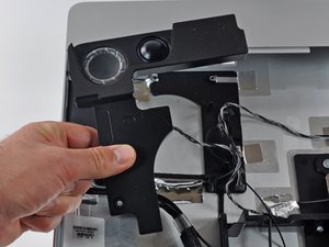

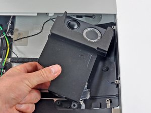

Image 1/3: We tested the sound before we disassembled it, and were quite impressed. Apple has super-sized the iMac's audio in proportion to the increased screen size. Image 2/3: While the speakers are in the bottom corners of the iMac, Apple has wisely placed the microphone at the top (near the iSight). That should make it possible to use the internal audio setup for video chats. Image 3/3: While the speakers are in the bottom corners of the iMac, Apple has wisely placed the microphone at the top (near the iSight). That should make it possible to use the internal audio setup for video chats.
  • Speakers! Big speakers.
  • We tested the sound before we disassembled it, and were quite impressed. Apple has super-sized the iMac's audio in proportion to the increased screen size.
  • While the speakers are in the bottom corners of the iMac, Apple has wisely placed the microphone at the top (near the iSight). That should make it possible to use the internal audio setup for video chats.

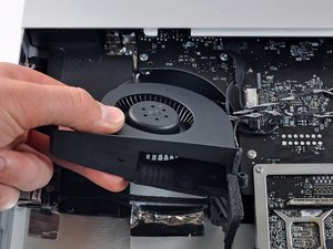

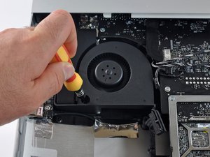

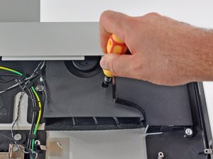

Image 1/3: We removed their screws and rotated each fan out of the computer. Image 2/3: We removed their screws and rotated each fan out of the computer. Image 3/3: We removed their screws and rotated each fan out of the computer.
  • With the logic board removed, we gain access to a couple of more fans.
  • We removed their screws and rotated each fan out of the computer.

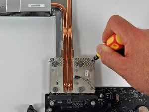

Image 1/3: View high resolution shots of the [http://s1.guide-images.ifixit.com/igi/ktLKDUFPyGmyPPQJ|front] and [http://s1.guide-images.ifixit.com/igi/g1q3TMAZD1skKwhG|back]. Image 2/3: To put the massive size of the heat sinks in perspective, check out the relative size of the USB ports on the bottom left of the board. Image 3/3: Notice the PRAM battery on the logic board (circular silver disc) for storing date and time when the power is disconnected. When changing the battery be careful to not to force the plastic top that holds the battery into place.
  • I can has heat dissipation? To keep the iMac cool and happy, Apple's included six temperature sensors, three fans, and two gigantic heat sinks.
  • View high resolution shots of the front and back.
  • To put the massive size of the heat sinks in perspective, check out the relative size of the USB ports on the bottom left of the board.
  • Notice the PRAM battery on the logic board (circular silver disc) for storing date and time when the power is disconnected. When changing the battery be careful to not to force the plastic top that holds the battery into place.
  • The processor is socketed, but there's a "Warranty void if removed" sticker above one of the heat sink's screws.
  • Our 3.06 GHz E7600 Core 2 Duo processor is a LGA 775 Socket T CPU. There are some Core 2 Quad chips that use the same socket, but we don't know if they would work. The i5 and i7 quad-cores included in the high-end 27" iMac use a different socket, LGA 1156 Socket H.

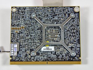

Image 1/3: Our low-end 27" model ships with an ATI Radeon HD 4670 graphics processor packing 256MB of GDDR3 memory. Image 2/3: The sheer quantity of labels on the back of the graphic card daughterboard is [http://s2.guide-images.ifixit.com/igi/aVSHuUxm3d5ZLJPN|overwhelming]. What were they thinking? Image 3/3: (It's obvious that Apple's engineers didn't design that daughterboard. It's a standard card used in a number of products.)
  • Removing the GPU daughterboard.
  • Our low-end 27" model ships with an ATI Radeon HD 4670 graphics processor packing 256MB of GDDR3 memory.
  • The sheer quantity of labels on the back of the graphic card daughterboard is overwhelming. What were they thinking?
  • (It's obvious that Apple's engineers didn't design that daughterboard. It's a standard card used in a number of products.)
it's possible to remove graphic card and replace it with the same but 512mb vram?
vinyltrack - Reply
I'd be interested to know if you can replace it with a better one. You say these are generic parts? Where can we get them? Or are they only available to manufacturers?
Simie - Reply
I really want to know if this is true!? i need to upgrade... bad.
Jason -
Please add pictures with the heatsinks removed both for the GPU and the Logic Board
ibrian - Reply
So is that still a laptop card, or like the proc, are we getting desktop class cards now?
joelsvoice - Reply
Quote from ibrian:
I agree! You never take the heatsinks off! Come on!
ericathornton - Reply
What's the name of that supposedly standardized slot? I've only ever seen Apple use it; I recall it was the same in the previous two revisions as well.
MD5Hash - Reply
Quote from MD5Hash:
AXIOM (ATI) respectively MXM (NVIDIA). IF Apple uses that (do they?)
ibrian - Reply
I don't get it. On this model you can change the graphic card?
Bilstoy77 - Reply
so is it possible to replace graphic card in any 27 inch imac?
i was rly sad when i have seen that 512mb card in i7 model
xyras - Reply
Image 1/1: The Apple logo is no longer just for looks, it now has a job to do. Earlier aluminum iMacs had an aluminum front and a plastic back. In contrast, this iMac features an all-aluminum enclosure, which is great for looks, but terrible for Wi-Fi. The Apple logo is the only plastic area on the back of the iMac, and Apple has integrated an AirPort antenna into that space.
  • Is this an antenna leading into the back Apple logo? We think it is...wonder why?
  • The Apple logo is no longer just for looks, it now has a job to do. Earlier aluminum iMacs had an aluminum front and a plastic back. In contrast, this iMac features an all-aluminum enclosure, which is great for looks, but terrible for Wi-Fi. The Apple logo is the only plastic area on the back of the iMac, and Apple has integrated an AirPort antenna into that space.
Image 1/1: However, curse our guilty conscience, being the nice and awesome professionals we are, we felt an urge and a slight sense of responsibility to do it right.
  • After such a tedious teardown, you can't blame us for just piling everything up into one ginormous heap of parts.
  • However, curse our guilty conscience, being the nice and awesome professionals we are, we felt an urge and a slight sense of responsibility to do it right.
  • The final layout picture for all to see. Enjoy!
