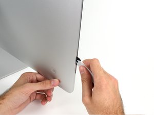

  2. iMac Intel 27" EMC 2639 Teardown: step 2, image 1 of 3 iMac Intel 27" EMC 2639 Teardown: step 2, image 2 of 3 iMac Intel 27" EMC 2639 Teardown: step 2, image 3 of 3
    Tool used on this step:
    iMac Opening Wheel
    €7.95
    Buy

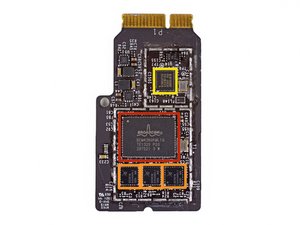

    • The AirPort/Bluetooth card, conforming to the 802.11ac Wi-Fi standard, still clings to the back of the logic board — making replacement no easier than before.
    • Not the first Mac to get updated with the new ac standard, we expected to see some similar hardware as in the refreshed MacBook Airs from earlier this year.
    • Chips off the old new block:
    • Broadcom BCM4360KML1G 5G WiFi 3-Stream 802.11ac Gigabit Transceiver—as expected, this is the same chip driving the ac Wi-Fi in the 11" and 13" MacBook Air
    • Skyworks SE5516 Dual-Band 802.11a/b/g/n/ac WLAN Front-End Module
    • Broadcom BCM20702 Single-Chip Bluetooth 4.0 HCI Solution with Bluetooth Low Energy (BLE) Support

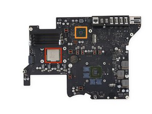

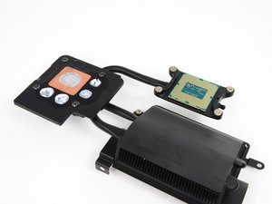

    • Apple's iMac refresh included some sneaky changes to the 21.5" model, and we were more than a little perturbed to discover a soldered CPU.
    • Thankfully, its 27" big brother was saved from the same fate, and power users will still be able to upgrade their processor without a reflow oven.

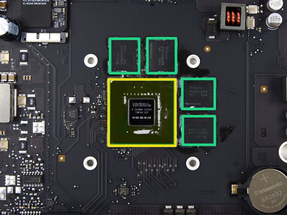

  6. iMac Intel 27" EMC 2639 Teardown: step 6, image 1 of 2 iMac Intel 27" EMC 2639 Teardown: step 6, image 2 of 2
    • Heavy-weight ICs:
    • 3.2GHz quad-core Intel Core i5 processor
    • Intel platform controller hub
    • As advertised, the iMac 27" now sports a fancy new graphics processor:
    • NVIDIA GeForce GT 755M GPU
    • Four SK hynix H5GQ2H24AFR 256 MB GDDR5 SGRAM ICs make up the 1 GB of graphics RAM
  7. iMac Intel 27" EMC 2639 Teardown: step 7, image 1 of 1

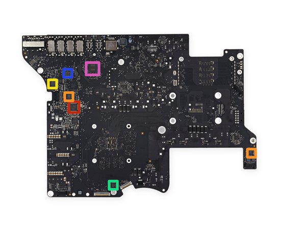

    • The B-side of our IC record:
    • NXP ARM7TDMI-S based Microcontroller
    • Analog Devices SSM3302 audio amplifier
    • Cirrus Logic 4206BCNZ audio controller, the same chip as found in last year's 21.5"
    • Vimicro VC0359 webcam processor
    • Broadcom BCM57765A1KMLG gigabit ethernet controller with integrated SDXC card reader
    • Intel DSL3510L Cactus Ridge Thunderbolt controller

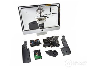

    • iMac 27" EMC 2639 Repairability Score: 5 out of 10 (10 is easiest to repair)
    • RAM is user-replaceable without opening the case, thanks to the rear access door.
    • You can still replace the hard drive and CPU inside this machine, albeit with some adhesive cutting.
    • Components are modular and fairly easy to remove.
    • Budget-minded folks now can add a second hard drive to the base iMac because the Fusion Drive connector is no longer missing from the logic board.

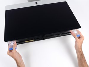

    • The glass and LCD are fused together, and there are no more magnets holding the glass in place.
    • You'll have to masterfully peel off the old double-sided sticky tape and apply new tape in order to reseal this iMac into original condition.
