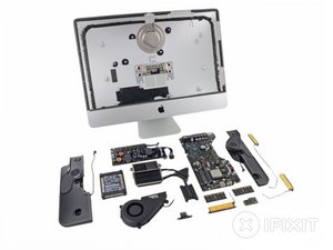

  • It may not have a Retina display, but the new 21.5" iMac has some commendable specs:
    • 2.7 GHz quad-core Intel Core i5 processor with 6 MB L3 cache
    • 8 GB of RAM
    • 1TB hard drive (5400 rpm)
    • NVIDIA GeForce GT 640M graphics processor with 512 MB dedicated VRAM
    • Four USB 3.0 ports and two Thunderbolt ports
    • 802.11n Wi-Fi and Bluetooth 4.0

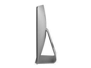

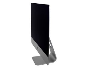

Image 1/2: Since the new iMac is barely thicker than a CD itself, it does not include an optical drive. However, it still does sport a plethora of ports: Image 2/2: 3.5 mm headphone
  • In case you haven't heard, the new iMac is really thin…kinda. At its thinnest point (around the edge), it is 5 mm thick. At its thickest, though, it is over 4 cm thick, more than 8 times the thickness of the edge.
  • Since the new iMac is barely thicker than a CD itself, it does not include an optical drive. However, it still does sport a plethora of ports:

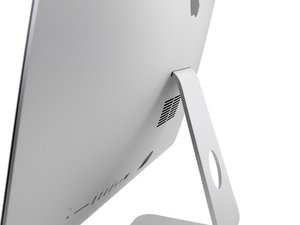

Image 1/3: Even though there are vents at the bottom of the rear case, our guess is that the fan is somewhere in the middle of the iMac—where it's fattest. These slots are probably the exhaust vents that spit out air drawn in from the bottom. Image 2/3: Hiding above the Apple logo, we find the small dual microphone grates. Image 3/3: ''It's listening; it's always listening…''
  • We find what appear to be cooling vents on the back of the rear case hidden behind the "foot." Unlike previous revisions, the vent is rectangular instead of circular.
  • Even though there are vents at the bottom of the rear case, our guess is that the fan is somewhere in the middle of the iMac—where it's fattest. These slots are probably the exhaust vents that spit out air drawn in from the bottom.

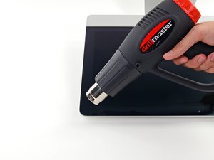

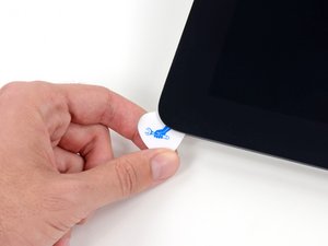

  • We begin to strum away at the adhesive holding the display assembly in place.
  • Unlike in the previous iMac, this glass is held in place with more than magnets.
  • To our dismay, we're forced to break out our heat gun and guitar picks to get past the adhesive holding the display down.

  • With the iPad-like adhesive severed, we bust out the heavy-duty stuff.
  • Repair faux pas alert! To save space and eliminate the gap between the glass and the pixels, Apple opted to fuse the front glass and the LCD. This means that if you want to replace one, you'll have to replace both.
    • Consolation prize: repairs will no longer involve cleaning dust or fingerprints from the LCD and glass during reassembly.
  • The fused display may look awesome, but at what cost, Apple? At. What. Cost!?
    • The cost is quickly apparent: cutting open the display destroys the foam adhesive securing it shut. Putting things back together will require peeling off and replacing all of the original adhesive, which will be a major pain for repairers.

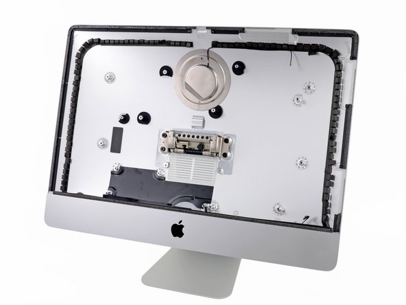

Image 1/1: As we tear through this machine we'll be able to take a look at how Apple managed to eliminate a millimeter here and a micron there, one component at a time.
  • Talk about a facelift—nothing about the inside of this iMac resembles last year's model.
  • As we tear through this machine we'll be able to take a look at how Apple managed to eliminate a millimeter here and a micron there, one component at a time.
  • Here's a properly-cropped (1920x1080) version of the internals for you to use as a wallpaper. We call it the iMac 21.5" Late 2012 Wallpaper.

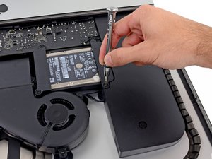

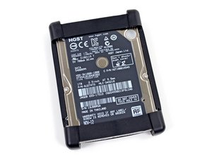

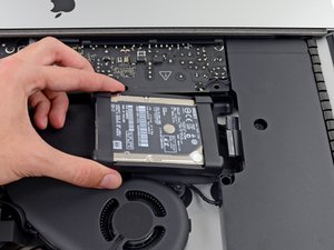

Image 1/3: By switching from a traditional 3.5" desktop hard drive to a 2.5" laptop drive, Apple designers were able to clear a lot of real estate inside the iMac. Image 2/3: Smaller laptop hard drives are also often quieter, thanks to smaller moving parts than their big brothers. Image 3/3: Apple turned to [http://www.hgst.com/travelstar-5k1000|HGST]—Western Digital's acquisition of Hitachi—to manage the iMac's spinning storage.
  • We like hard drives and devices that support dual hard drives, so naturally we start by examining the new iMac's 1 TB drive.
  • By switching from a traditional 3.5" desktop hard drive to a 2.5" laptop drive, Apple designers were able to clear a lot of real estate inside the iMac.
    • Smaller laptop hard drives are also often quieter, thanks to smaller moving parts than their big brothers.
  • Apple turned to HGST—Western Digital's acquisition of Hitachi—to manage the iMac's spinning storage.

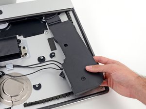

Image 1/1: This design is far different from what we've [guide|5485|seen before|stepid=24092]. Since the internal components are more tightly packed than before, small vibrations may carry through more components. The rubber housing dampens the vibrations from the spinning hard drive so they are not perpetuated throughout the device.
  • A rubbery housing is lightly adhered to the edges of the hard drive beneath the upper and lower hard plastic bezels.
  • This design is far different from what we've seen before. Since the internal components are more tightly packed than before, small vibrations may carry through more components. The rubber housing dampens the vibrations from the spinning hard drive so they are not perpetuated throughout the device.

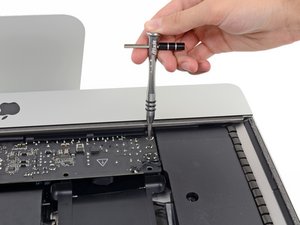

Image 1/3: This board takes the readily available AC voltage from your wall socket and converts it to tasty DC voltage for the iMac to consume. Image 2/3: The specified output is 12.1 V, 15.4 A. Image 3/3: The specified output is 12.1 V, 15.4 A.
  • You might already know that we carry a 54-bit driver kit to handle any of your mechanical fastener needs. What you might not know, however, is that the included extender can be used to provide extra torque to remove tough screws—such as those holding down the power supply board inside the iMac.
  • This board takes the readily available AC voltage from your wall socket and converts it to tasty DC voltage for the iMac to consume.
    • The specified output is 12.1 V, 15.4 A.

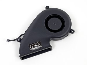

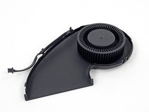

Image 1/3: Apple is changing things up quite a bit and has moved from [guide|5966|multiple] [guide|5953|small] [http://bit.ly/Vbxg1P|fans] to a single centralized fan. Image 2/3: "1" may be the loneliest number, but removing 2/3 of the fans goes a long way towards saving space. Image 3/3: Judging by the orientation of the [http://i48.tinypic.com/2jb1xn7.png|squirrel cage] fan, we gather that it draws cool air from the bottom vents, then blows hot air out of the grating in the back of the iMac.
  • A new fan layout! We are fans.
  • Apple is changing things up quite a bit and has moved from multiple small fans to a single centralized fan.
  • "1" may be the loneliest number, but removing 2/3 of the fans goes a long way towards saving space.
  • Judging by the orientation of the squirrel cage fan, we gather that it draws cool air from the bottom vents, then blows hot air out of the grating in the back of the iMac.
Are the fans the same asymmetric style fans as found in the MacBook Pro with Retina Display?

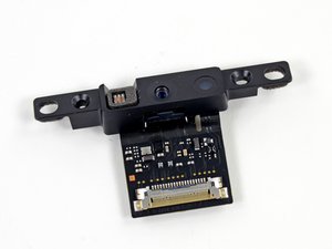

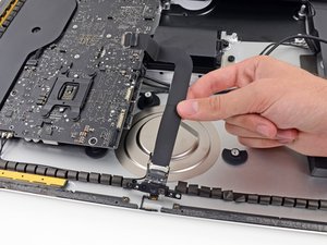

Image 1/2: A ribbon cable we can only describe as "beefy" keeps the FaceTime HD camera in touch with the logic board. Image 2/2: A ribbon cable we can only describe as "beefy" keeps the FaceTime HD camera in touch with the logic board.
  • The webcams in iMacs of yesteryear have always been connected to the logic board with long snaking cables that were relatively fragile; that is no longer the case.
  • A ribbon cable we can only describe as "beefy" keeps the FaceTime HD camera in touch with the logic board.
At this step, after removing the fan, you can replace the RAM modules without removing the logic board. It looks like possible and easy.
giampablo - Reply

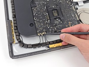

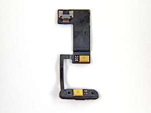

Image 1/2: Dual microphone technology has been utilized in mobile devices for years to cut out background noise during phone calls. Now, the same idea is being applied here to improve sound quality during intimate FaceTime chats with your mother. Image 2/2: It's not often that we see the microphone(s) and webcam for a computer disconnected from each other. That modularity means positive points towards repairability.
  • As we mentioned earlier, the newest iMac features not one, but two microphones.
  • Dual microphone technology has been utilized in mobile devices for years to cut out background noise during phone calls. Now, the same idea is being applied here to improve sound quality during intimate FaceTime chats with your mother.
  • It's not often that we see the microphone(s) and webcam for a computer disconnected from each other. That modularity means positive points towards repairability.

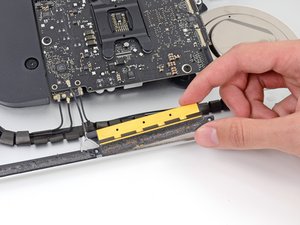

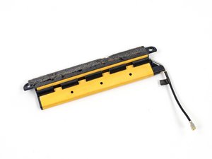

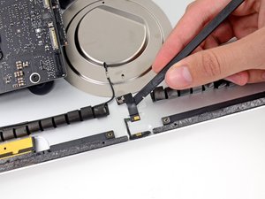

  • Three gold bars antennas come out next with a few spudger flicks.
  • Even though the main Wi-Fi antenna is hidden behind the big Apple logo on the rear case as usual, these three antennas split up Bluetooth and secondary Wi-Fi duties.

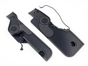

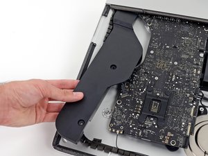

Image 1/3: The speakers may look simple, but removing them is nerve-wracking. For seemingly no reason other than to push our buttons, Apple has added a barb to the bottom of the speaker assemblies that makes them harder-than-necessary to remove. Image 2/3: After sufficiently wracking all of our nerves, the speaker assemblies allow us to remove them from their [https://www.youtube.com/watch?v=JY4Iz0w42qU|sick beat dropping] enclosure. Image 3/3: After sufficiently wracking all of our nerves, the speaker assemblies allow us to remove them from their [https://www.youtube.com/watch?v=JY4Iz0w42qU|sick beat dropping] enclosure.
  • Stop—speaker time!
  • The speakers may look simple, but removing them is nerve-wracking. For seemingly no reason other than to push our buttons, Apple has added a barb to the bottom of the speaker assemblies that makes them harder-than-necessary to remove.
  • After sufficiently wracking all of our nerves, the speaker assemblies allow us to remove them from their sick beat dropping enclosure.
What function is served by the upper portion/chamber of the speaker assemblies? They seem to be cut off from the speaker drivers with foam inserts.
portofino901 - Reply

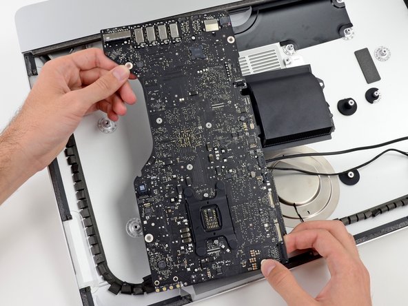

Image 1/2: We know, we're terrible. Image 2/2: We flip the board over and get our first glimpse of the goodies side, which reveals, well, a lot of goodies.
  • The next logical step was to remove the iMac's logic board.
    • We know, we're terrible.
  • We flip the board over and get our first glimpse of the goodies side, which reveals, well, a lot of goodies.

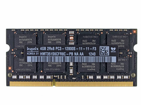

Image 1/2: Bad news: You have to unglue your screen and remove the logic board in order to do so. Image 2/2: This is just barely less-terrible than having soldered RAM that's completely non-removable.
  • Good news: The iMac's RAM is "user-replaceable."
  • Bad news: You have to unglue your screen and remove the logic board in order to do so.
    • This is just barely less-terrible than having soldered RAM that's completely non-removable.
  • Our bargain-basement unit has a solid 8 GB of Hynix PC3-12800 RAM.

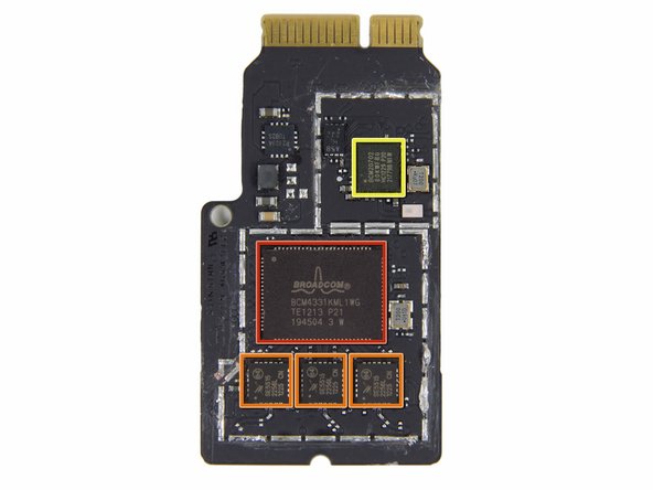

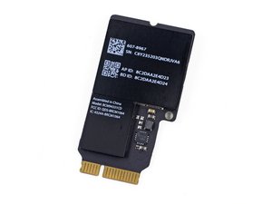

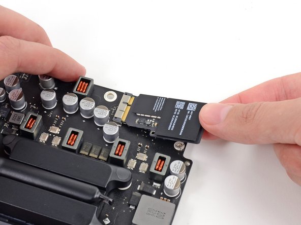

Image 1/3: After a [guide|5485|short hiatus|stepid=24090], Broadcom is back to bring WLAN capabilities to the iMac. Image 2/3: A Broadcom [http://www.broadcom.com/products/Wireless-LAN/802.11-Wireless-LAN-Solutions/BCM4331|BCM4331] single-chip WLAN solution dominates the tiny AirPort card. Image 3/3: The three Wi-Fi antennas are run by three Skyworks SE5515 Dual-Band frontend chips.
  • Like a young fellow nervous to dance at prom, the AirPort card sits inconspicuously in the corner.
  • After a short hiatus, Broadcom is back to bring WLAN capabilities to the iMac.
  • A Broadcom BCM4331 single-chip WLAN solution dominates the tiny AirPort card.
  • The three Wi-Fi antennas are run by three Skyworks SE5515 Dual-Band frontend chips.
  • New from last year's model, Bluetooth and Wi-Fi are integrated into the same card, with the addition of a BCM20702 single-chip Bluetooth 4.0 processor.

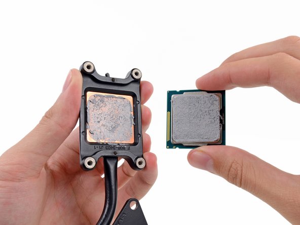

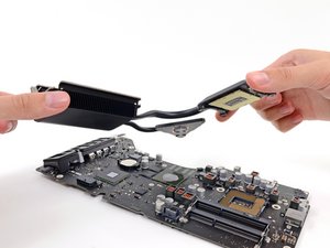

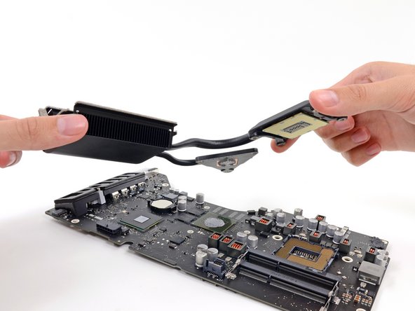

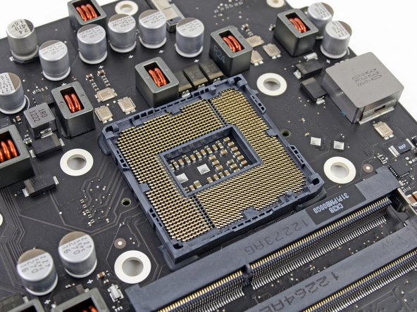

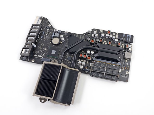

Image 1/3: And along with it…what's this…the CPU??? Image 2/3: The new iMac uses a spring-loaded, [http://en.wikipedia.org/wiki/LGA_1155|FCLGA1155] socket to make all those little electrical signals go into, and out of, the CPU. Image 3/3: The new iMac uses a spring-loaded, [http://en.wikipedia.org/wiki/LGA_1155|FCLGA1155] socket to make all those little electrical signals go into, and out of, the CPU.
  • And off comes that honkin' heat sink!
    • And along with it…what's this…the CPU???
  • The new iMac uses a spring-loaded, FCLGA1155 socket to make all those little electrical signals go into, and out of, the CPU.
So, the CPU can be replaced/upgraded?
dniolet - Reply

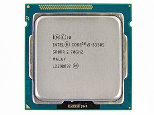

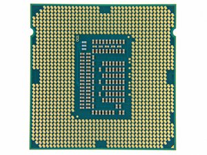

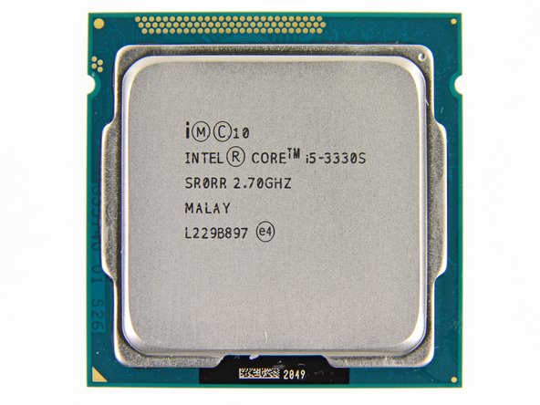

Image 1/2: This is the bottom rung of the ladder as far as processors in the iMac go. You can max out a 21.5" machine with a 3.1 GHz quad-core Intel Core i7 with Turbo Boost up to 3.9 GHz. Image 2/2: This is the bottom rung of the ladder as far as processors in the iMac go. You can max out a 21.5" machine with a 3.1 GHz quad-core Intel Core i7 with Turbo Boost up to 3.9 GHz.
  • The Intel Core i5-3330S is clocked at 2.7 GHz, but can stretch its legs up to 3.2 GHz if needed.
  • This is the bottom rung of the ladder as far as processors in the iMac go. You can max out a 21.5" machine with a 3.1 GHz quad-core Intel Core i7 with Turbo Boost up to 3.9 GHz.

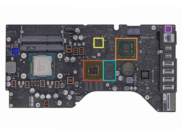

Image 1/1: Nvidia [http://www.geforce.com/hardware/notebook-gpus/geforce-gt-640m|GeForce GT 640M] GPU

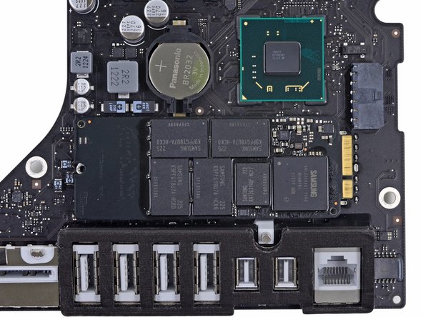

  • Major players on the front side of the Lo-Bo:
    • Nvidia GeForce GT 640M GPU
    • Intel E213B384 platform controller hub
    • Texas Instruments Stellaris LM4FS1AH microcontroller
    • 2x Hynix H5GQ2H24AFR GDDR5 SGRAM
    • National Semiconductor VM22AC
    • Delta 8904C-F
    • Broadcom BCM57765A1KMLG gigabit ethernet controller with integrated SDXC card reader

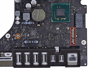

  • So, ummm...
  • See these traces on the board here?
  • See this other hole on the left?
  • Looks like this is where Apple's proprietary SSD connector should reside.
    • Placing the SSD from the 13" MacBook Pro Retina Display confirms this notion. If the shoe fits...
  • We purchased the "bargain-basement" version of the iMac. We're assuming that the more-expensive version—one that has the built-to-order Fusion drive option—has this connector soldered onto the board, and a 128GB SSD placed into said connector.
  • Looks like there'll be no love for our awesome dual-drive kit from this iMac generation. :(
The Fusion drive is more likely a hybrid and the SSD connector was intentionally depopulated.
elvisimprsntr - Reply
It's been confirmed that the Fusion Drive technology is software based and not the same as a Hybrid Drive. The two drives are separate, and act as one drive via software. Separating them allows for both SATA3 connectors to be used, and allows for more efficient bandwidth for your data, when it moves from one drive to the other. Also, if one portion of the Fusion Drive fails, it can be replaced. So iFixit is correct in their assumptions.
Mari Marasu -
The SSD drive was "intentionally depopulated" only because an SSD (or Fusion Drive) is not an option on the base 21.5" iMac.
Snay Patel -
Forgive me if I'm mistaken, but do I spy a pair of SATA power and data ports immediately to the left of the RAM chips (as seen in staps 18 and 21)???
As much as a spare SSD connector would be quite handy (as mentioned in step-24), would it nevertheless be possible to install a 2nd SSD via the (apparent) SATA ports that I mentioned above, or possibly through a Y-Splitter via the HDD port?
Cheers in advance.
David Markham - Reply
I just see a single SATA port, that is already taken for the sole HDD.
You can't split SATA cables either.
Snay Patel -
Regarding Step 24 -
Any Idea if it'd be possible to install OWC's Aura Pro SSD there? For example, if i were to buy the 21.5 inch iMac with a standard 5200rpm 1TB HDD, and then install my own SSD in the supplied connector, would it still work?
I'm assuming that with the 27 incher, the 768GB Flash option from Apple will be using this connection? So i'm also thinking that it would just be a much cheaper option of buying a cheaper SSD from elsewhere and installing it myself? Any thoughts?
The Aura Pro 480GB SSD - http://eshop.macsales.com/shop/SSD/OWC/A...
Craig Shields - Reply
I found a connector for SSD there on my iMac that came with 1TB HDD! Found it when I had to remove the main board to upgrade the Wi Fi card to 802.11ac:) I might be very lucky or some base 21.5" iMacs have the connector even though the one in this teardown didn´t have it.
Runar Vaernes - Reply
Hi Runar,
it would be nice to know whether you have the base (2.7ghz) or the stronger (2.9ghz) version.
I have the stronger one, that could be ordered (BTO) with SSD but I don't find any information about SSD connection soldered onto the logic board... neither any picture.
Zsolt -
Image 1/1: In order to carefully join together the pieces of the case, Apple turned to [http://en.wikipedia.org/wiki/Friction_stir_welding|friction stir welding], a process previously reserved for applications such as ship building and aerospace.
  • Though the rear case is the last piece we reach, it's where the design of the new iMac began.
  • In order to carefully join together the pieces of the case, Apple turned to friction stir welding, a process previously reserved for applications such as ship building and aerospace.
  • Friction stir welding is more like joining clay than welding—it doesn't melt the workpieces, but rather softens the area between them and forces material together, creating a strong weld with no weakened heat affected zone.
How about removing the foot/stand to install a VESA adapter? Same way with a business card like before?
fernandopenah - Reply
At a minimum can you let us know if removal of the stand is either the same or can it be removed at all to install a VESA adapter. If I have to take a hacksaw to this thing then I will be rethinking buying it to begin with.
Herb -
What is the connector near the bottom of the case (right hand side) for?
CityZ - Reply
Can't see where you see Friction Stir Welding. To my knowledge, the assembly is just made using traditional Spot Welding, which is common for metal sheet assembly.
Jerome Samson - Reply
Image 1/2: You can still replace the RAM, hard drive, and CPU inside this machine. Image 2/2: The glass and LCD are now fused together, and there are no more magnets holding the glass in place. That means it's heatgun time!
  • iMac 21.5" EMC 2544 Repairability Score: 3 out of 10 (10 is easiest to repair)
    • You can still replace the RAM, hard drive, and CPU inside this machine.
    • The glass and LCD are now fused together, and there are no more magnets holding the glass in place. That means it's heatgun time!
    • Most replaceable components (like the RAM) are buried behind the logic board, meaning you'll have to take apart most of the iMac just to gain access to them.
    • Budget-minded folks can no longer add a second hard drive to the base iMac unless they are super-fond of soldering missing proprietary connectors onto the logic board.
    • You'll have to masterfully peel off the old double-sided sticky tape and apply new tape in order to reseal this iMac into original condition.

The vent behind the stand has been there since the original core 2 duo iMacs.
Declan Hunter - Reply
The vent was there on the g5 iMacs in 2004

Looking at the picture in step 8 and seeing where the RAM is located in the later pictures, would it be possible to change out the RAM without lifting out the logic board? It looks like there's a gap big enough to reach in an unlatch them. And is there any special voodoo with the hard drive (do you need to use the same manufacturer or could you replace it later with any other)?
Richard Murray - Reply
you can replace with any HD, remove fan, then you can replace ram without removing LB - done myself
Amadeusz Juskowiak -

For anyone who's wondering...
- you can open the iMac without heat gun, using just Plastic Playing Card (poker-like) instead of guitar picks, same results, easier and faster
- you can mount any 9.5mm x 2.5" (or little heigher, there is plenty of space inside) disk - any SSD should work (using Vertex 4)
- any RAM 1600MHz, CL11 should work (using ValueRAM 2x8GB CL11 1600MHz here) and... you don't need to unscrew nor remove the logic board - just unscrew fan, then use toothpicks (yeah, or something sturdier) to unclip RAM, mount new RAM, screw fan and you're done
- removing old tape is simple, it peels off easily, i used 3M 5915 6mm 16mil tape, results are almost perfect, you may find other thin (14mil would be the best) tape with strong glue and foam
Have fun!
Amadeusz
PS 7/10 repair score

Does this mean that the CPU is infact replaceable, for example moving from the 1.4 dual to a 2.7 quad ?
liam - Reply
