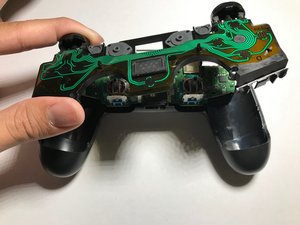

Remove the top layer PCB. The PCB must be popped out of place and then angled in such a way that the trigger buttons at the top of the controller slide out of their slots.
