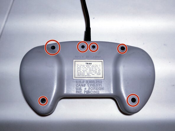

  1. Turbo Touch 360 by Triax for Super Nintendo Entertainment System Teardown, Remove the screws.: step 1, image 1 of 1
    • Use a Philips 00 screwdriver to remove the six screws on the back of the controller.
