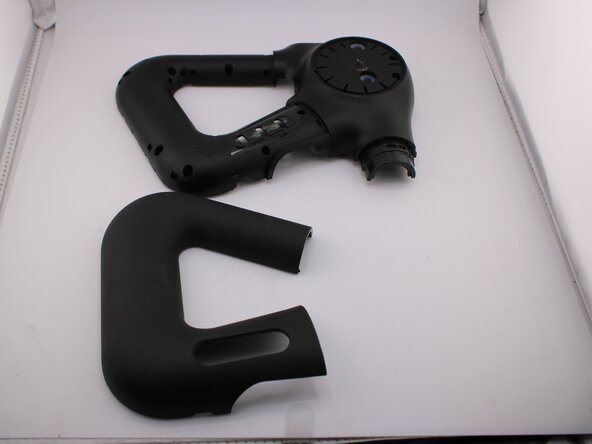

  1. Theragun Teardown, Pry apart handle: step 1, image 1 of 1
    • You can see that the cover has 2 pieces. There is a cover that snaps over the larger piece that conceals the fasteners. Pry apart, it will separate just like all the modern assemblies.
  2. Theragun Teardown: step 2, image 1 of 1
    • Once you have removed the cover off the larger bezel, there are a few more fasteners underneath that aluminum plate. It is slightly glued and held in place by bending the tabs. Comes out fairly easily.
  3. Theragun Teardown: step 3, image 1 of 1
    • This is the KEY to the whole thing. That cover is a vital mechanical component that is pressed in place. You will need to pry it off. I damaged mine slightly, with a bit of gentle heating I think you may be able to avoid damage.
  4. Theragun Teardown: step 4, image 1 of 1
    • Here is the disassembled unit in all its glory.
