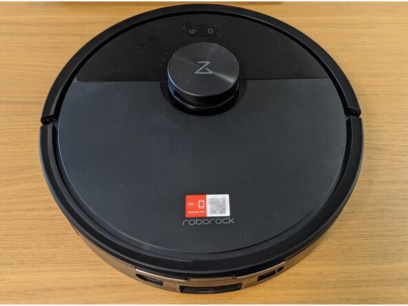

  1. Teardown of Roborock Q7 TF+ robot, Overview top view: step 1, image 1 of 3 Teardown of Roborock Q7 TF+ robot, Overview top view: step 1, image 2 of 3 Teardown of Roborock Q7 TF+ robot, Overview top view: step 1, image 3 of 3
    • Overview top view

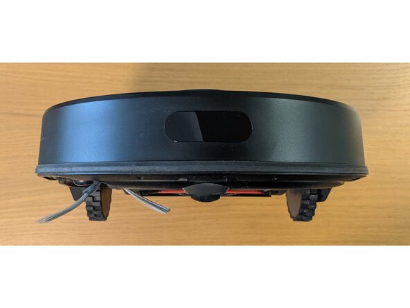

  2. Teardown of Roborock Q7 TF+ robot, Overview front and rear view: step 2, image 1 of 2 Teardown of Roborock Q7 TF+ robot, Overview front and rear view: step 2, image 2 of 2
    • Overview front and rear view

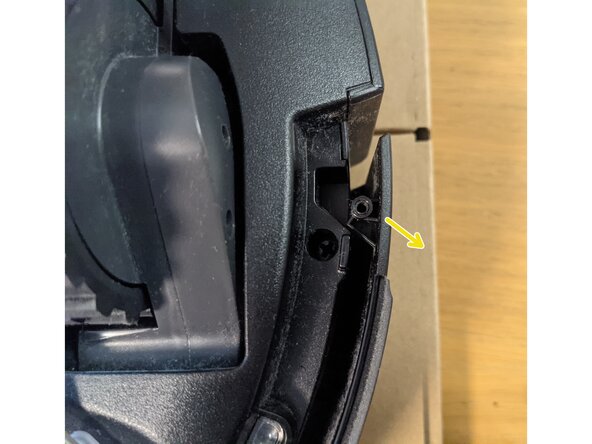

  6. Teardown of Roborock Q7 TF+ robot, Remove front bumper 02/02: step 6, image 1 of 2 Teardown of Roborock Q7 TF+ robot, Remove front bumper 02/02: step 6, image 2 of 2
    • Push one side towards to the center of robot and a bit away from you.
    • On the other side it should be easy to move it away from robot. (Do not use force)

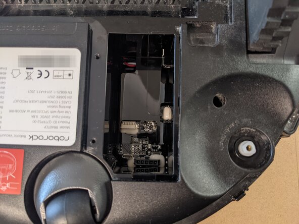

  7. Teardown of Roborock Q7 TF+ robot, Battery compartment: step 7, image 1 of 3 Teardown of Roborock Q7 TF+ robot, Battery compartment: step 7, image 2 of 3 Teardown of Roborock Q7 TF+ robot, Battery compartment: step 7, image 3 of 3
    • Remove those two screws
