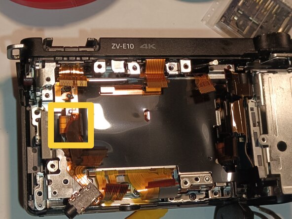

  2. Teardown Sony ZV-E10 to reach SD card slot, Opening and Separating the Cover: step 2, image 1 of 3 Teardown Sony ZV-E10 to reach SD card slot, Opening and Separating the Cover: step 2, image 2 of 3 Teardown Sony ZV-E10 to reach SD card slot, Opening and Separating the Cover: step 2, image 3 of 3
    • After you open the body cover. Gently pull this flex cable (the encircled yellow one)

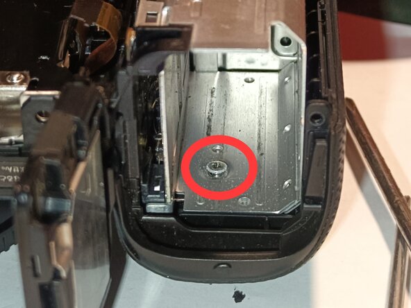

  8. Teardown Sony ZV-E10 to reach SD card slot, Battery compartment screws: step 8, image 1 of 3 Teardown Sony ZV-E10 to reach SD card slot, Battery compartment screws: step 8, image 2 of 3 Teardown Sony ZV-E10 to reach SD card slot, Battery compartment screws: step 8, image 3 of 3
    • After you removed the metal plate cover from step 7. Now remove these 2 screws. One is located inside battery compartment (you insert your Philip screwdriver in this hole where arrows are pointing). The other screw is located at right side face of the battery compartment.

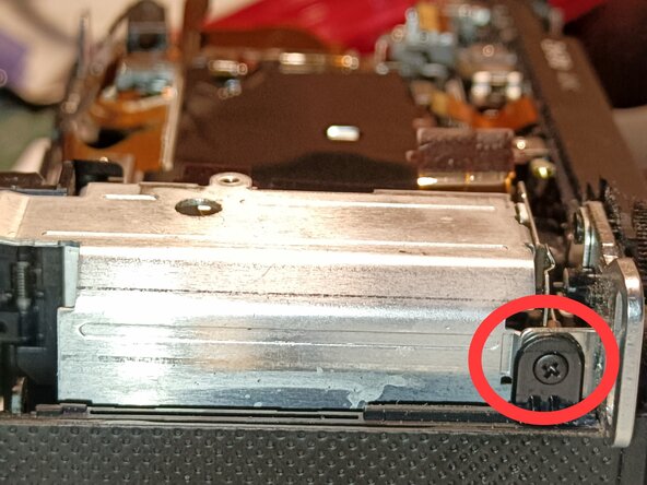

  13. Teardown Sony ZV-E10 to reach SD card slot: step 13, image 1 of 2 Teardown Sony ZV-E10 to reach SD card slot: step 13, image 2 of 2
    • Locate and remove this last screw.

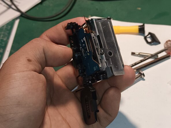

  14. Teardown Sony ZV-E10 to reach SD card slot, The end: step 14, image 1 of 2 Teardown Sony ZV-E10 to reach SD card slot, The end: step 14, image 2 of 2
    • And congratulations, you successfully removed the sd card slot from the body
